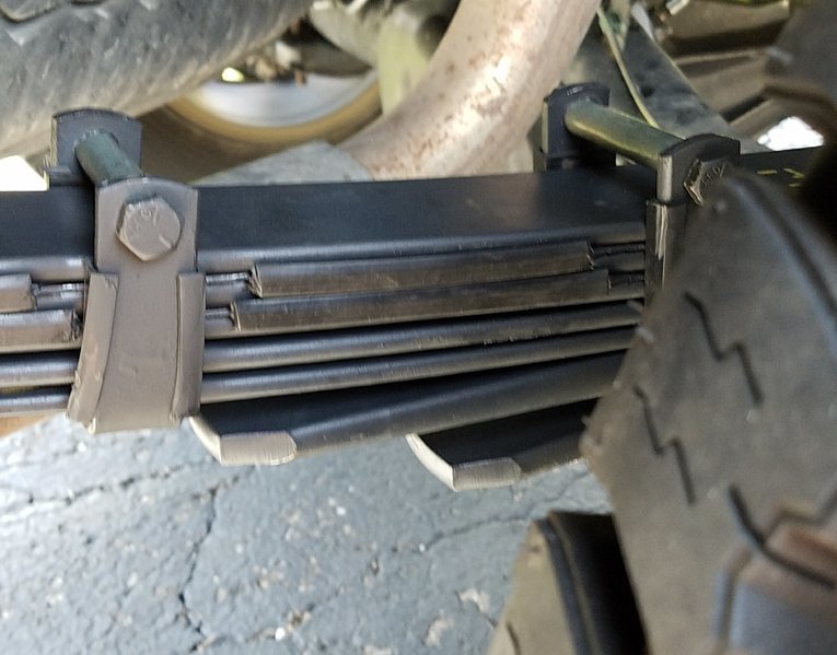

    I have Dakars too. I ended up putting teflon liners between the top three leafs. Quite and smooth ride even with a empty bed.

    This is to reduce squeaks? I've read about newer bushings that reduce noise that OME have. My set is sitting here taunting me waiting for moar gear

    It's a combination of a couple things. Yes to prevent or reduce squeaking. I forgot the technical term but the metal on metal of the leaves contributes to a harsh ride. Full teflon liners eliminate that and end result is a smooth ride with an empty bed.

    https://www.eatondetroitspring.com/leaflinereffectonspringrate/
    You have to call them. It's 2.5" with edge guard(or whatever you call it.) It's a lip on the sides to keep it from moving. It's sold by the foot. Unfortunately I don't remember how much I bought. Measure your springs and times it by 4 if you want to do the same thing that I did. The top three leafs don't come with the factory pads. Those are the ones I put the liners between. So two strips per leaf pack.

    Does the 2.5 inch wide version fit good? I only ask since they also sell a 2.25 inch wide liner that I think matches the width of the Dakars. Thanks

    The Dakars are 2.5"

    Absolutely! I found a picture after I got them all together. I cut off the side pieces where the leaf pack brackets are. 20170409_122944.jpg
