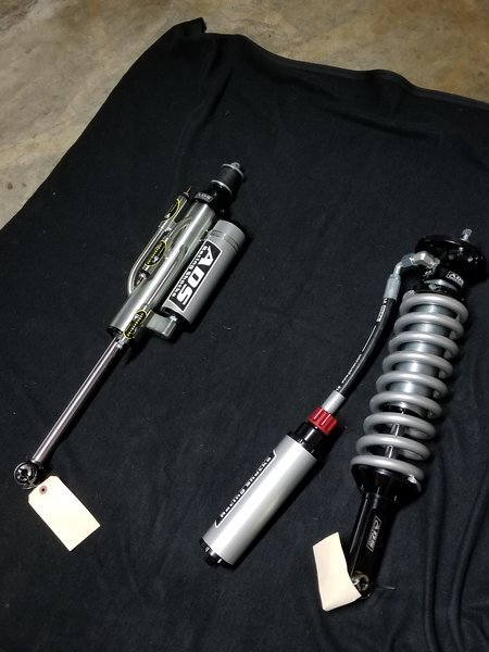

    Just received shipping email from Marie @ Headstrong. Suspension is coming tomorrow per tracking info.
    If any one is interested I could try to make a video clip of suspension install.
    nartmot and riz_atx like this.

    I ordered the 700lb springs with clickers in front and rear are triple bypass with HS 3 leaf AAL kit.
    I'm planning to remove my sway bar.

    Got my suspension today. Had to chase UPS around. Luckily 2 nice employee @ Aliso Viejo facility pulled my packages. That lady in the office never called me within the hour for my will call. I got there around 7:02, 2 mins after closing lady @ the customer service area couldn't even go to back room to retrieve my packages. She saw that it said 3 boxes. And decided to tell me they're still on the truck.
    So I asked 2 employee and they retrieved my packages.
    A big thank you to them.
    I will try my best to did a vlog tutorial on suspension install.
