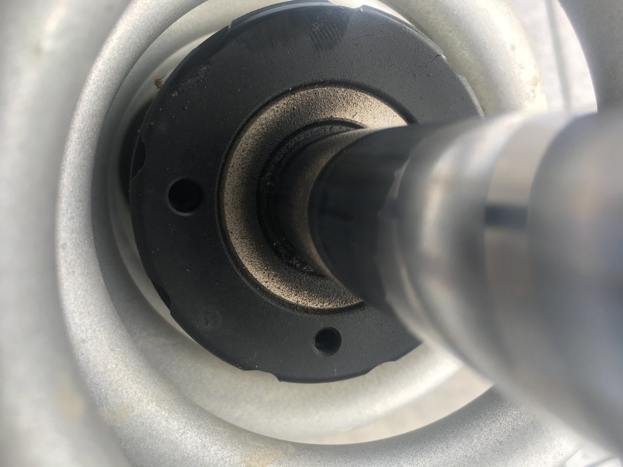

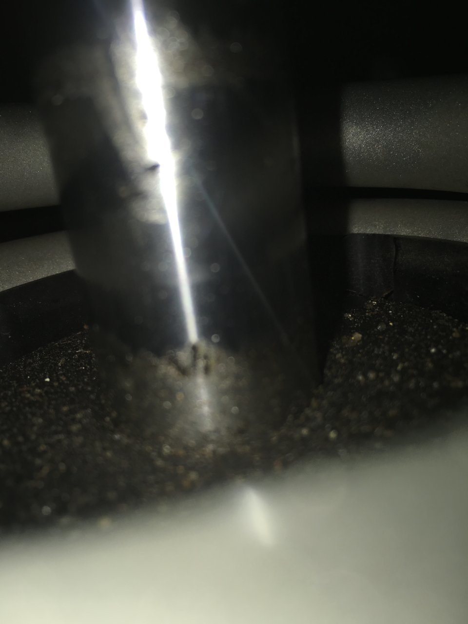

    So yesterday I saw some grease/oil on my coil over that looked like it could have been a leak. This is what I found when I pulled it off today....Looks like there may have been some “misting” but I’m not sure. It could have also been some WD-40, or something I ran over. Anybody else notice this on their shocks?D51B4444-8E6C-4309-80ED-7FF6703CB2C4.jpg53A5A412-A01A-4D1D-B60C-FA000E3721A1.jpg

    Hit it with solvent to clean it off, if it comes back or pools at the lower rod end, that's when you worry about a rebuild.

    I just wiped it off with a rag, I’m rebuilding anyway so I can relocate the reservoirs using different fittings. I also looked for any dings on the shaft. I didn’t see anything so who knows where it came from.

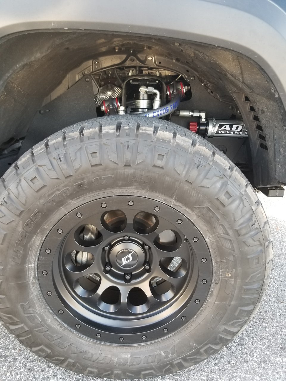

  17. Dec 10, 2017 at 2:33 PM
    #1117
    FLdub
    FLdub Well-Known Member
    Jun 22, 2016
    #190297
    144
    SRQ FL
    2016 Black Tacoma TRD OR 4x4
    ADS 2.5 with external reservoirs with adjusters.
    Total Chaos UCAs
    ADS piggybacks out back.
    All-Pro leaf pack.
    Still need to get the carrier drop kit and maybe axle shims. I get a vibration right at 10mph.
    ready6delta, rlx02, jeffkimkp and 5 others like this.

  19. Dec 10, 2017 at 4:58 PM
    #1119
    FLdub
    Jun 22, 2016
    #190297
    144
    SRQ FL
    Which size shims did you go with?
    Let us know how it goes when you put them in.
    riz_atx likes this.
  20. Dec 10, 2017 at 5:23 PM
    #1120
    riz_atx
    riz_atx #bigpermtaco #teamBP
    Jan 5, 2017
    #206621
    10,674
    Sohail
    Spicewood Texas
    ‘16 4x4 DCLB GFC Locked, Geared, Tuned
    C4Fab/RCI/BAMF, ADS, 4.88, Lockers, OVTune
    Looking good!!! You are going to love the adjustability of those clickers. Don’t be afraid to experiment.
