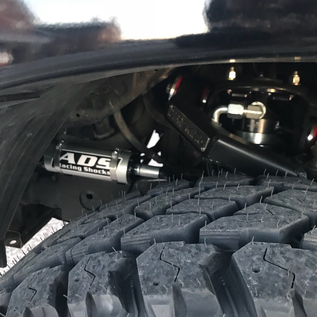

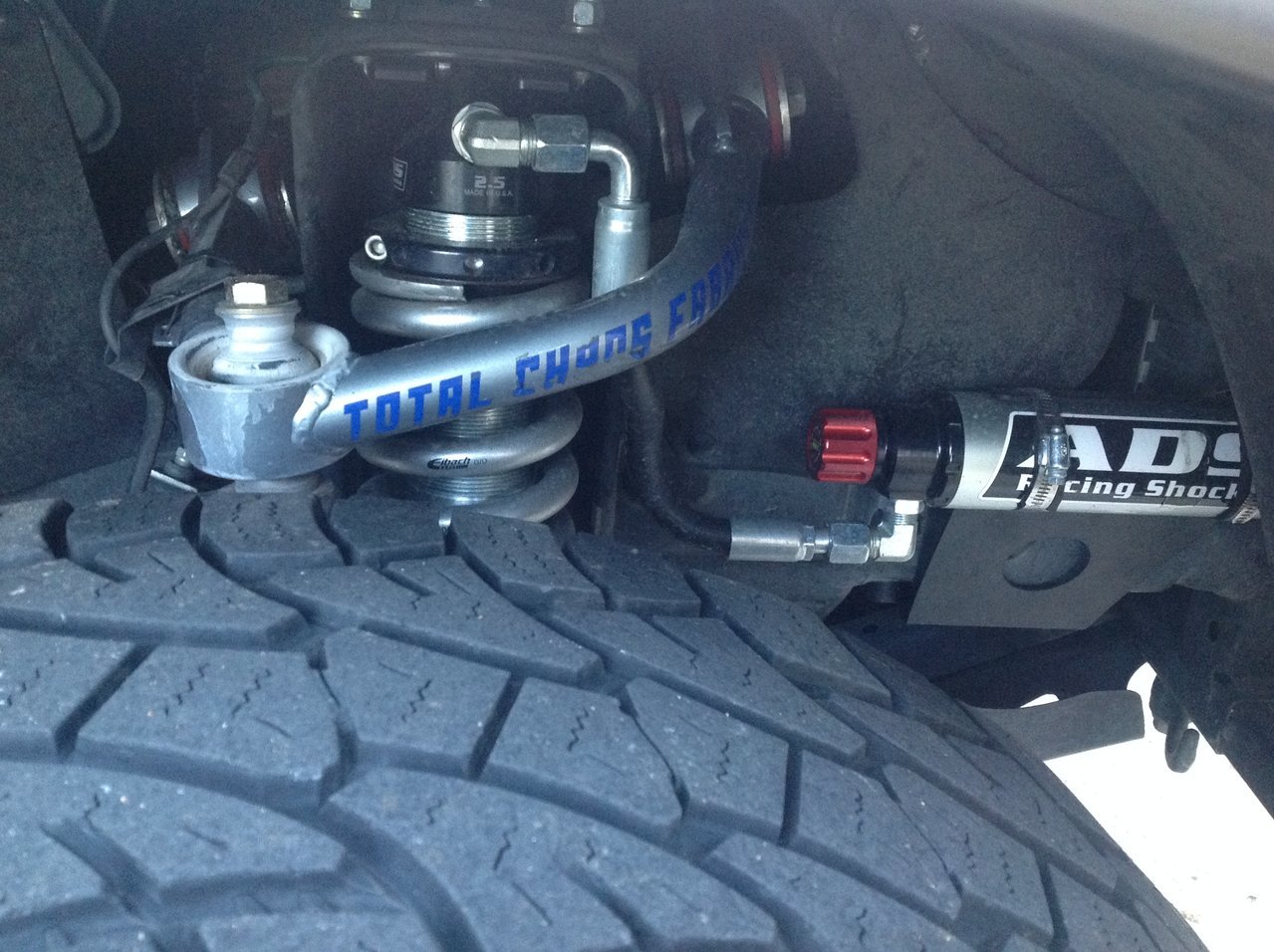

    Fox2011PM
    Fox2011PM "The Mountains are calling"
    Jan 20, 2012
    #71056
    1,231
    '13 DCSB 4X4 TRD OR
    ADS 2.5" CO's w/adj, ADS 2.5" Rears w/ piggybacks, Firestone air bags and 1.5" AAL, SCS SR8s, Tom Woods custom one piece drive shaft....more to come

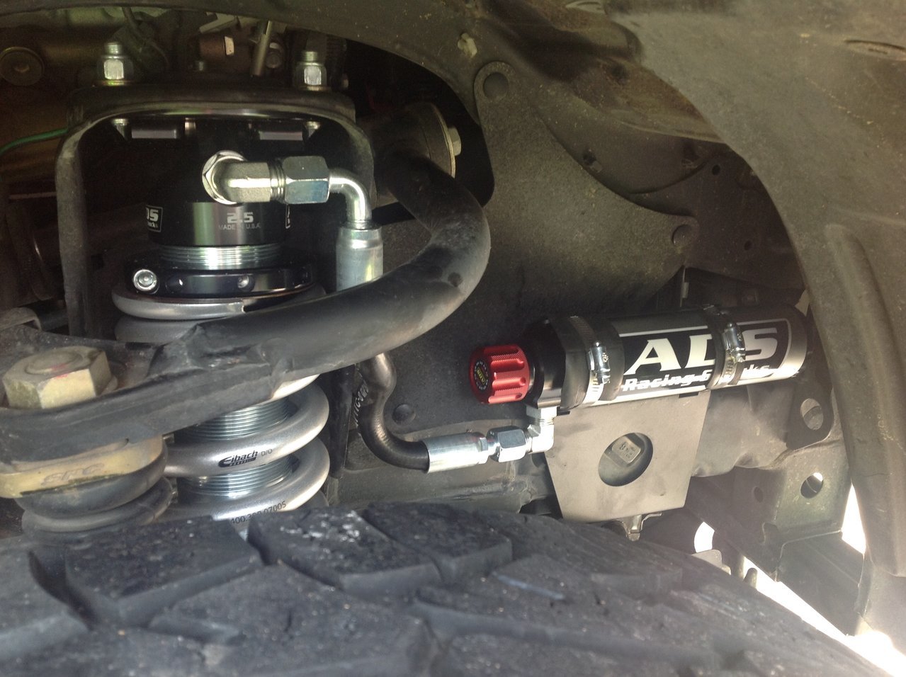

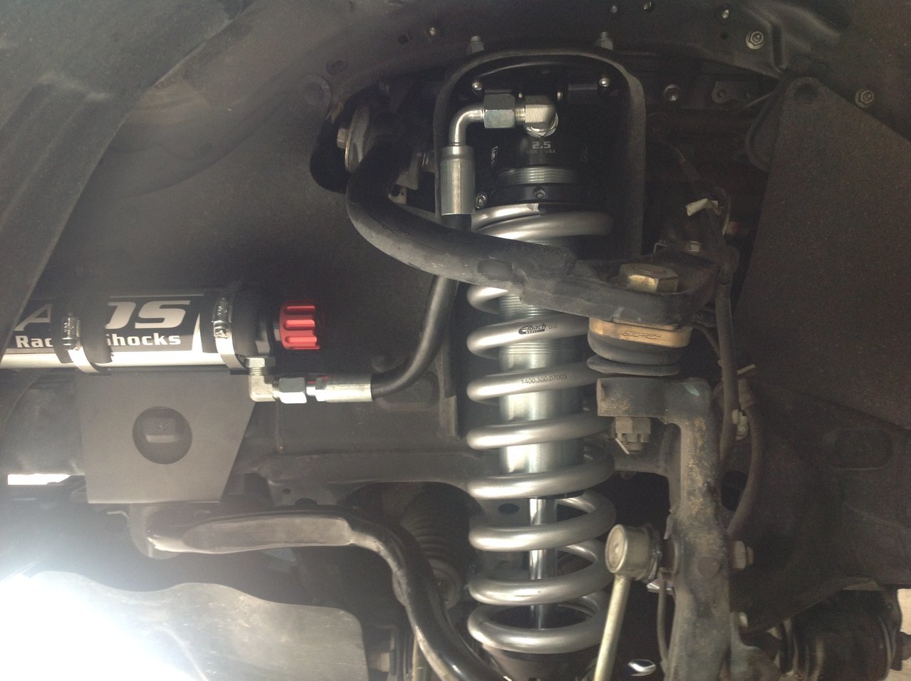

    I went remote resi with compression adjusters and 700# springs. Have had them on for about 6 months. Didn't like the jarring stiffness going into gas stations or my driveway that has an acute incline. Removed my swag bar 2 weeks ago, rides like butter now. I don't notice any difference at all. Ride is still a little stiff upfront, but I'm getting an ARB bumper and atleast IFS skid soon. Should ride even better after that. I have sinced removed and sold my Light Racing UCAs and went to Total Chaos. Might switch back to Light Racing with the new greaseable joint in the future, the TC UCAs tend to be squeaky at times unless I hit em with some CFC lube frequently.image.jpgimage.jpgimage.jpg

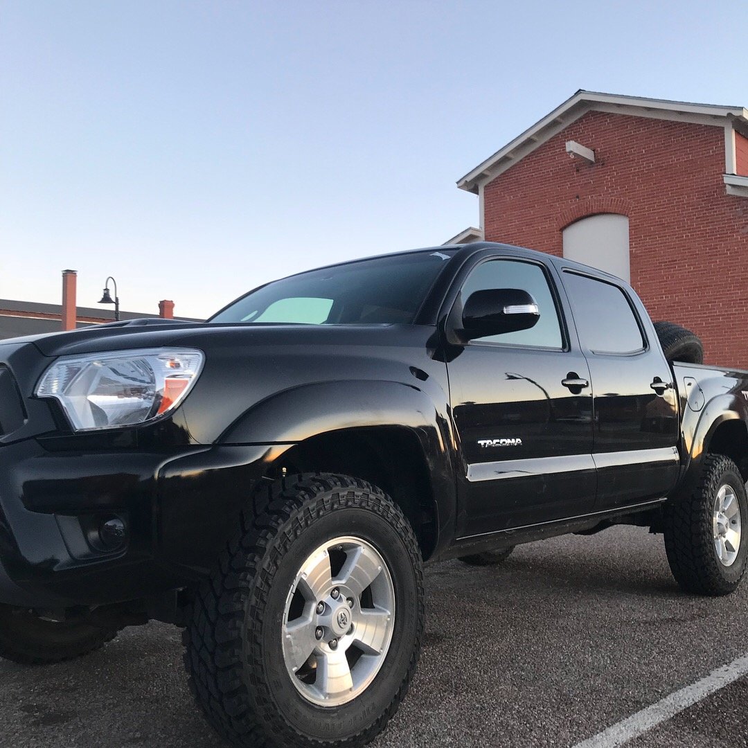

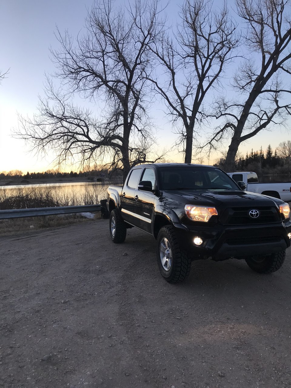

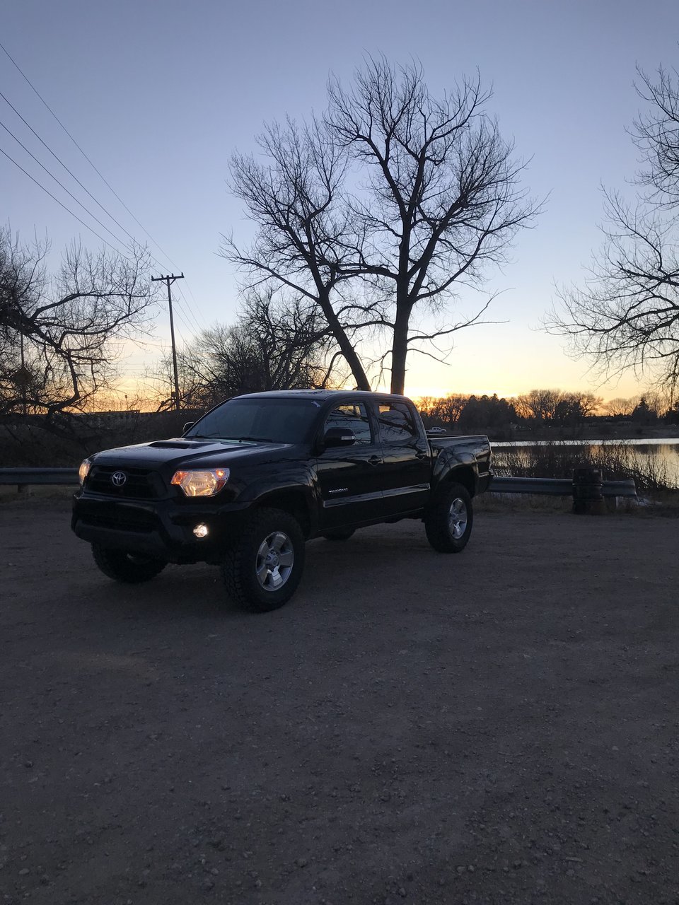

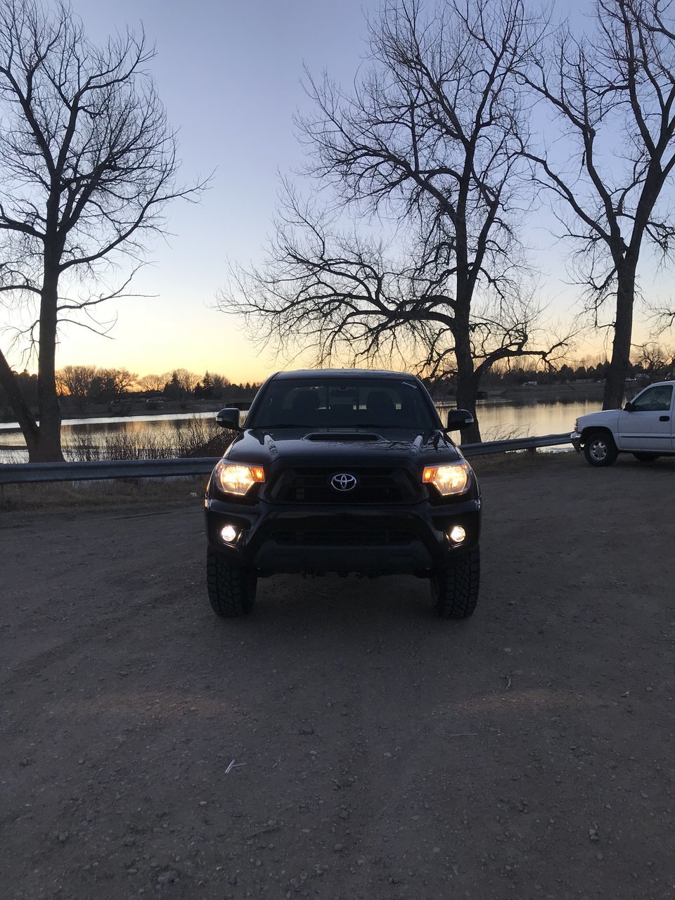

    I had a couple messages from people asking some questions and wanting more pictures.
    255/80/17 has no rubbing when putting on the coilover with ads factory settings, even at full lock. No Cab mount chop either.
    The factory settings on stock tires gave me about 2 inches of lift. With the bigger tires I got over 3 inches.
