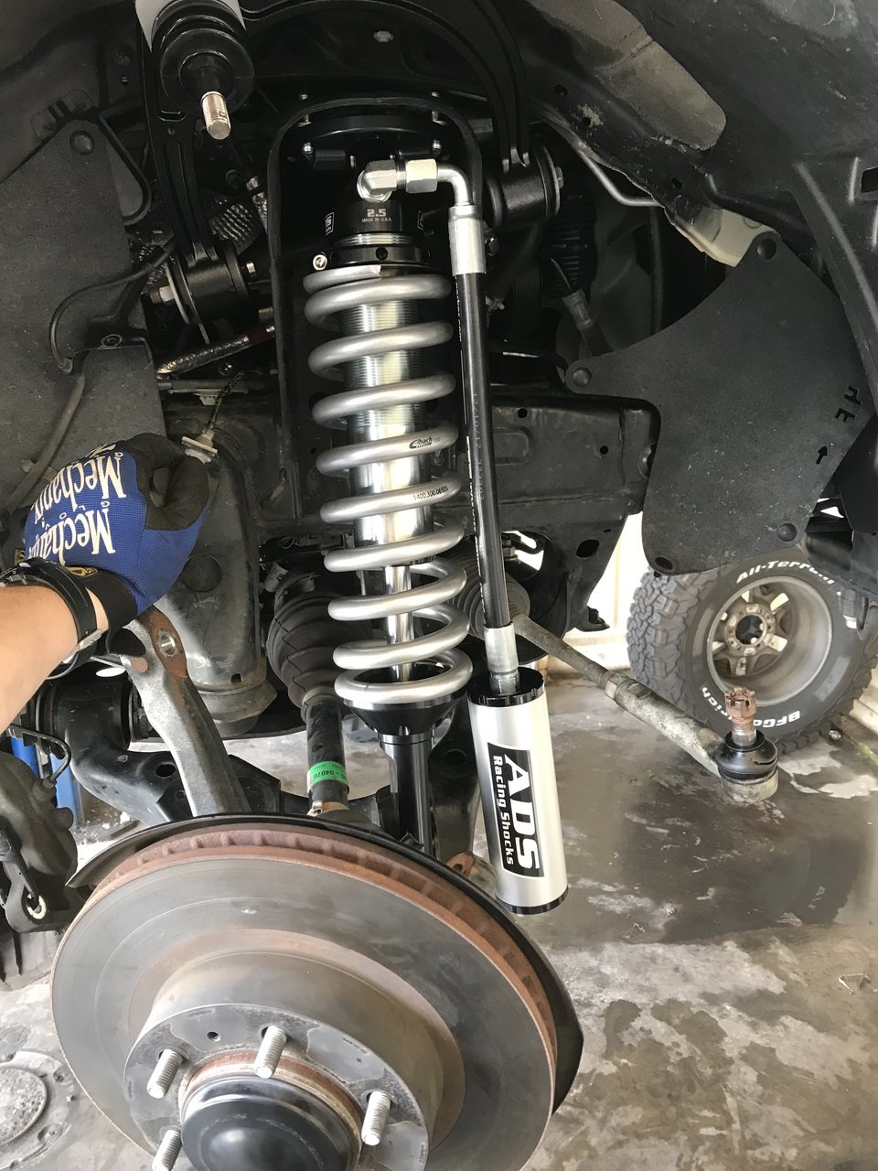

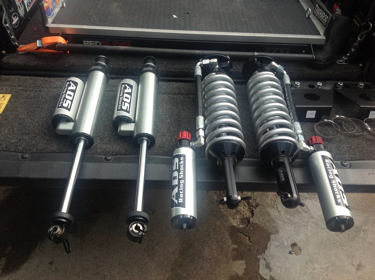

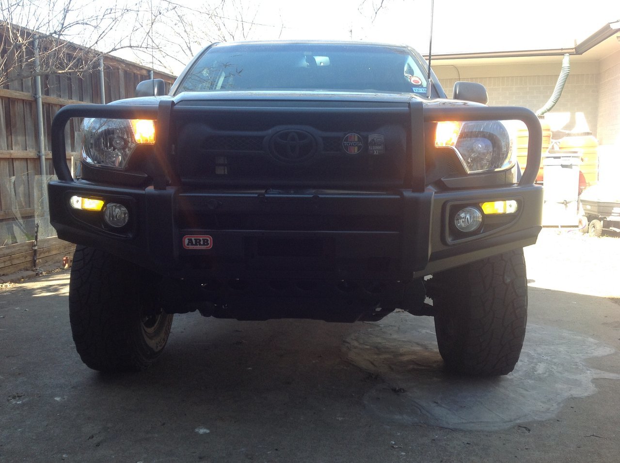

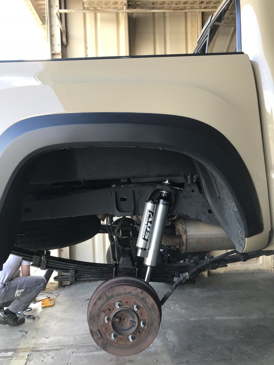

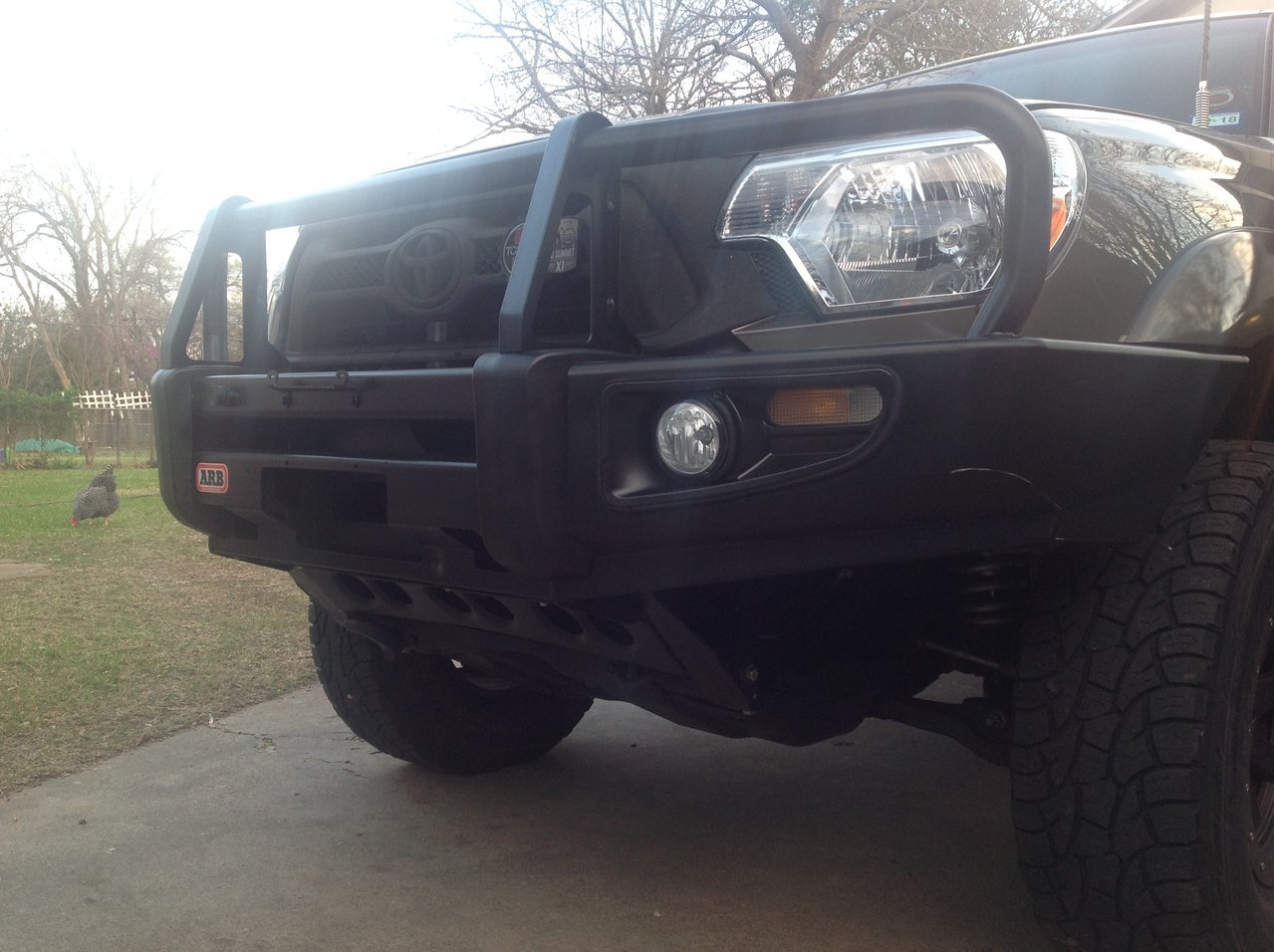

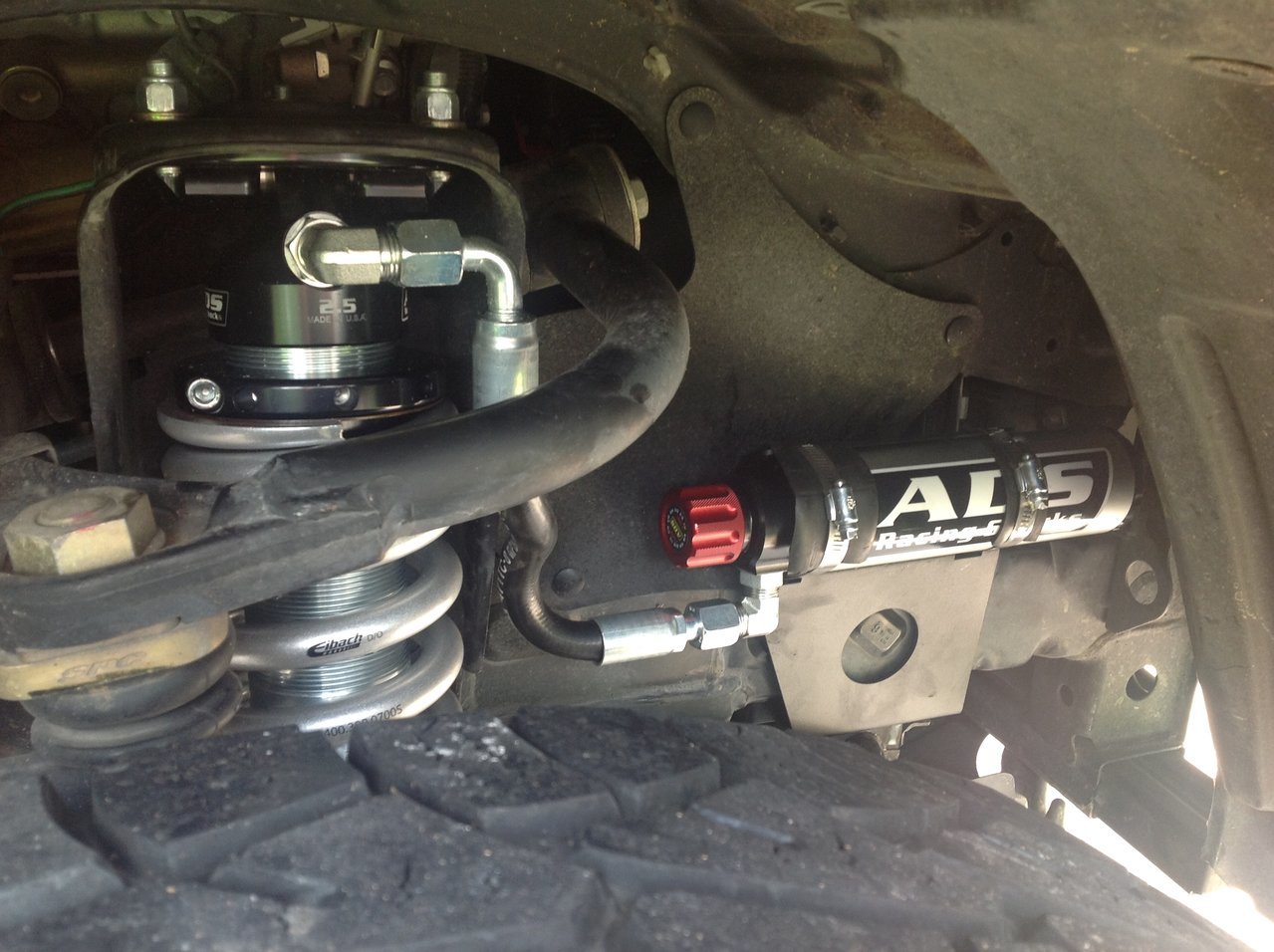

    Have had my ADS fronts and rears with remote reservoirs and 700# coils installed for about 6 months or so. Love them! They were a bit stiff. I just added an ARB bumper this past weekend. Now this is how the ride is supposed to feel!!!!! I knew I was going to add a bumper and skids down the road, which is why I went with the 700# coils. Man what a difference. Pot holes and such are barely noticeable now. I'm super happy.image.jpgimage.jpgimage.jpgimage.jpg

    No swaybar, correct?

    Correct. Ditched it. No looking back. I'm a pretty conservative/cautious/old lady in her 80's driver, so I won't miss it. I still have it, but I saw a post where someone ditched his and is thinking about melting it down to make swords.......best idea ever

    @riz_atx qoutes are exactly right. These are adjustable, so no need for a "lean" spacer. Just crank the drivers up a couple more revolutions than passenger. As for not doing clickers in the rear, I run Allpro Expos and ride rite bags, not sure adjusters would benefit me in that configuration, although maybe someone else could chime in on that. I run a ton of weight almost constantly. The rear can be a tad bouncy unloaded, but honestly not that noticeable. As I said, I got the 700# coils because I knew eventually I would be adding weight upfront soon. Plus my work commute is only 18 miles round trip, and I rarely drive too far from the house anyway. So when I do drive on long trips, I'm loaded up, so the ride is really nice. I would recommend, although I'm not a suspension specialist by any means, if you don't plan on adding weight, I would go with the 650# possibly 600# coils. Not sure if ADS offers 600# though. But give Marie @HeadStrong Off-Road, she can answer any questions you have. She walked me through the process for my setup and my wife's Icon setup on her 4Runner. And they have the best prices I have found. They ship fast and the packaging is very protective of the contents. Honestly if you do a lot of city driving and mild off-road driving, in other words if you stay on pavement more than off, I personally would look into Fox or Icon. My wife's 4Runner drives soooooo nice with the Icon Stage 2. For driving around the city, I would rather be in hers, for our trips and travels I would rather be in mine. Just my 2 cents. Hope this helps with your decision. Just take your time and do your research, it took me almost two years to finally decide what I was going with. It was very intimidating and overwhelming at first, but questions here on TW, and several calls to Marie, I was able to make an educated decision that I am extremely happy with. It's a lot of money, so make sure to get what you want, and think a ways down the road, that way you get the most for your money, and you are happy driving your Tacoma!

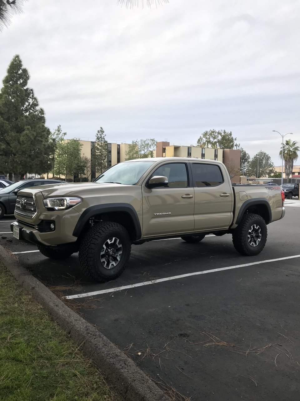

    2016 quicksand Tacoma TRD OFF ROAD

    I had the same questions as you guys so I emailed them a few months ago. Here was their reply to me: "For every 3 clockwise rotations you should gain 1/2" of lift. We like to measure the full installed length of the spring at full extension to determine the exact preload. The coil spring free length should be 14". We wouldn't recommend going further than 11.75" installed length."
    Hope this helps guys.
  18. Mar 18, 2018 at 11:57 PM
    #1238
    Bpalm6
    Bpalm6 Member
    Aug 21, 2017
    #227572
    9
    Brandon
    Not sure about the amount per rotation. Ordered mine stating I wanted 3 inches and that’s what I got with 650lb springs
  19. Mar 19, 2018 at 12:00 AM
    #1239
    TRD493
    TRD493 Well-Known Member
    Dec 27, 2015
    #173269
    1,725
    Dave
    Texas (DFW)
    17 TRD Sport DCLB 4x4 / 01 4x4 V6 Extra Cab TRD SR5
    It's after you install them. If you want more height you have to rotate the collar.
