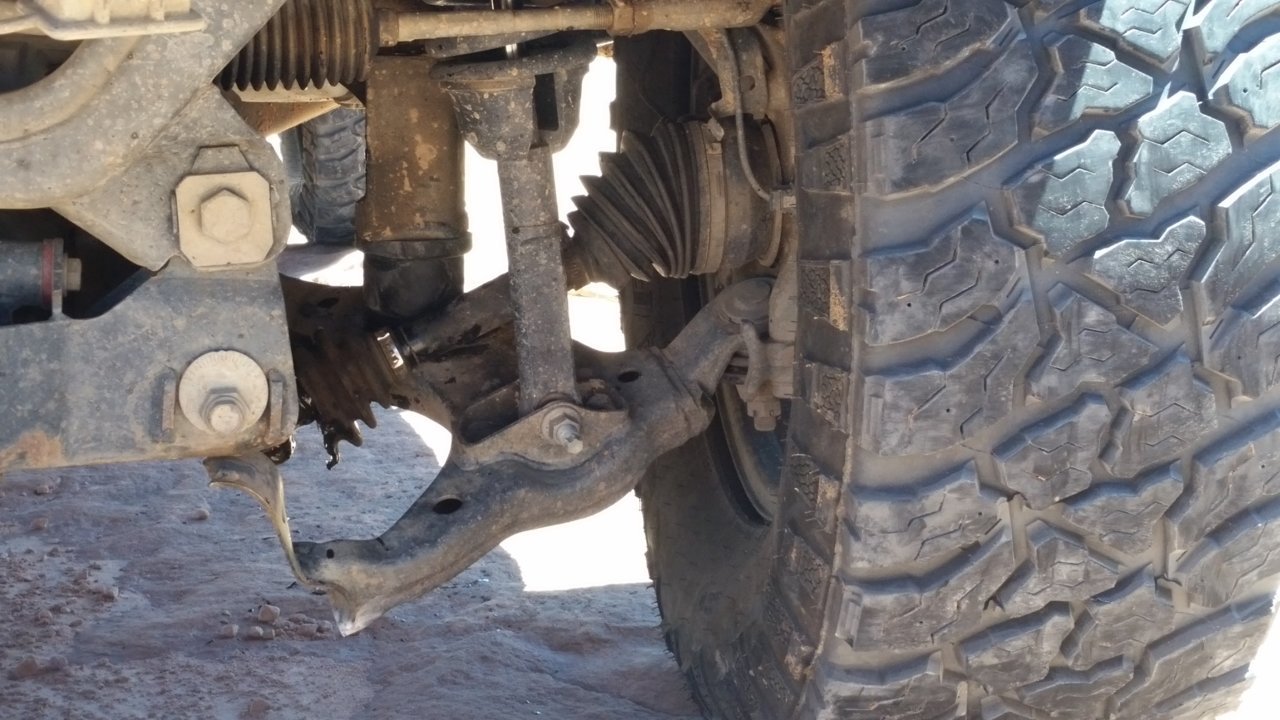

    False.
    The lower control arm weak link is the arm to frame bushing design. Literally unfolds and lets go.
    Edit: And before you say this is the fault of the drop bracket -- not the case here. Plenty of others with the same thing on mid-travel set ups. I personally took this photo on hells revenge @ Rock Therapy 2015 of Manwithoutaplan's truck.
    Not sure what gen we are discussing here -- anyways, same story. 1st gens weak point is indeed the LBJ, albeit to my knowledge no one even makes stock width LCA's for them which is why I assumed 2nd gen.

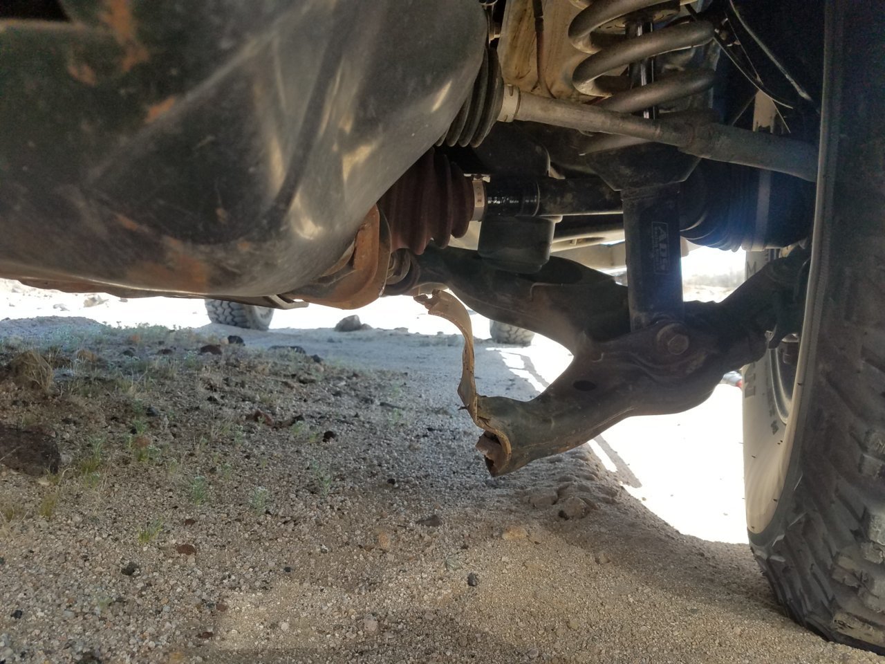

    This is why I’m considering a aftermarket lca for my midtravel setup, or at least finding a pair of stock uca’s to carry as spares. This was @tyfoon11 last weekend

    Ouch...I bet those cam bolts were seized too! Anyone else looking to add spare LCA's, I suggest you carry a spare set of cam bolts too, and a sawzall.

    My bolts were new.
    rob1208 and AaronArf[QUOTED] like this.

    I do recommend at reinforcing them if you plan on abusing your truck at all

    Um, at least our LCAs don't just randomly decided to let go of the tire.:hattip:

    I personally would prefer the failure pictured above vice the tire folding under like with a LBJ failure

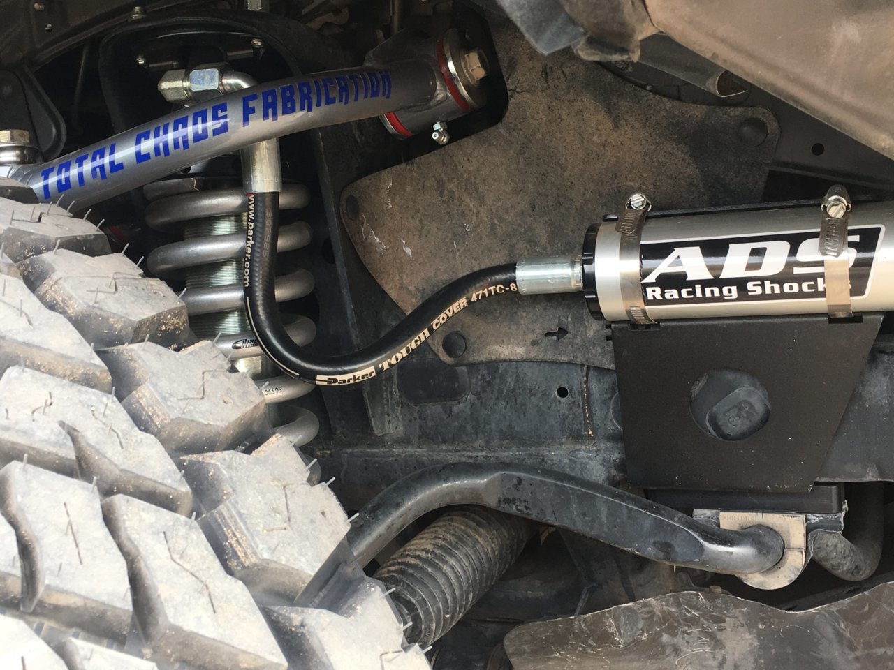

    Well after almost a year of research and time on this forum I finally got everything installed on my 2015. ADS 2.5 RR Coilovers, Total Chaos UCA, Dakars in the rear and 255/85R16 Cooper ST maxx on stock rims. The ride is amazing so far. Can't wait to get it out in to the mountains. Thanks a ton to Marie @HeadStrong Off-Road for everything!

    Cant tell my your pics but did you get the compression clickers?

    I did not. Probably should have but cost starting adding up quick

    Yeah thats for sure. You can always add them in later as well. I figure once I need the shocks rebuilt, I could send them to ADS to change the config at the same time. I got the clickers and they are pretty awesome! If you set them to max and then push down that skinny pedal, it just absorbs all the bumps. Definitely worth it for higher speed stuff

    Dang, that's some sketchy stuff. Maybe I'll get my spare set of LCAs strengthened and then swap em in. Still, that LBJ weakness scares me. Tempted to just change those out when I do the ADS upgrade
