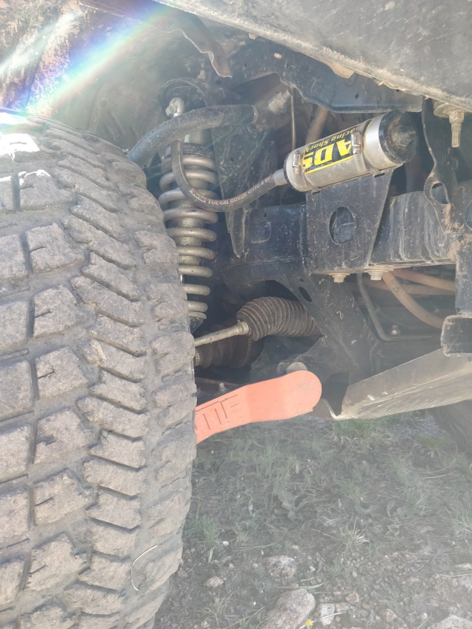

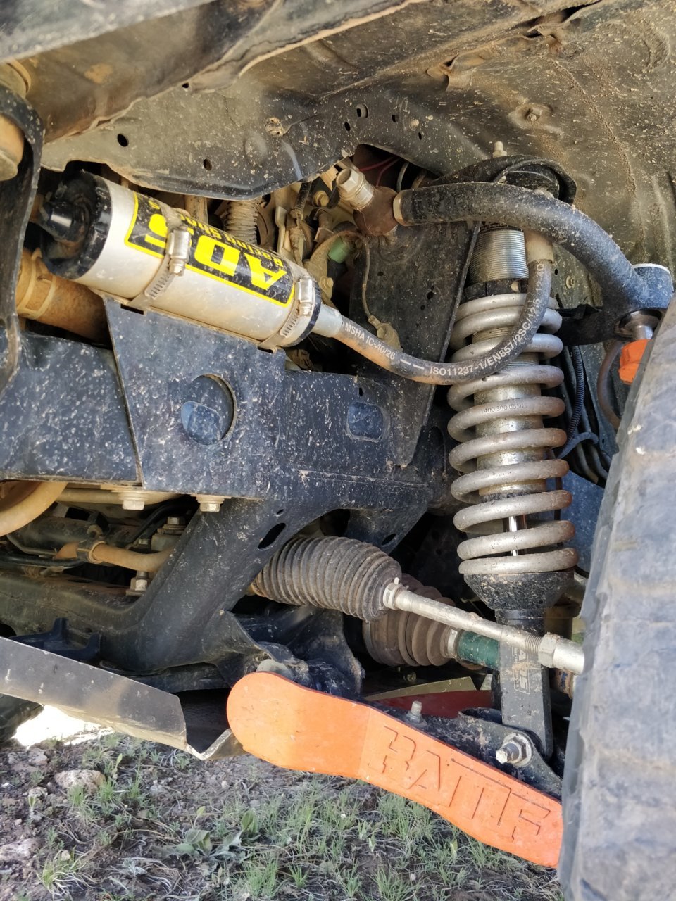

    I've been working mine out the last few weeks, 3300 miles road trip, about 1000 on dirt. They are happy to soak up washboards, feel better the faster I go, would definitely recommend.

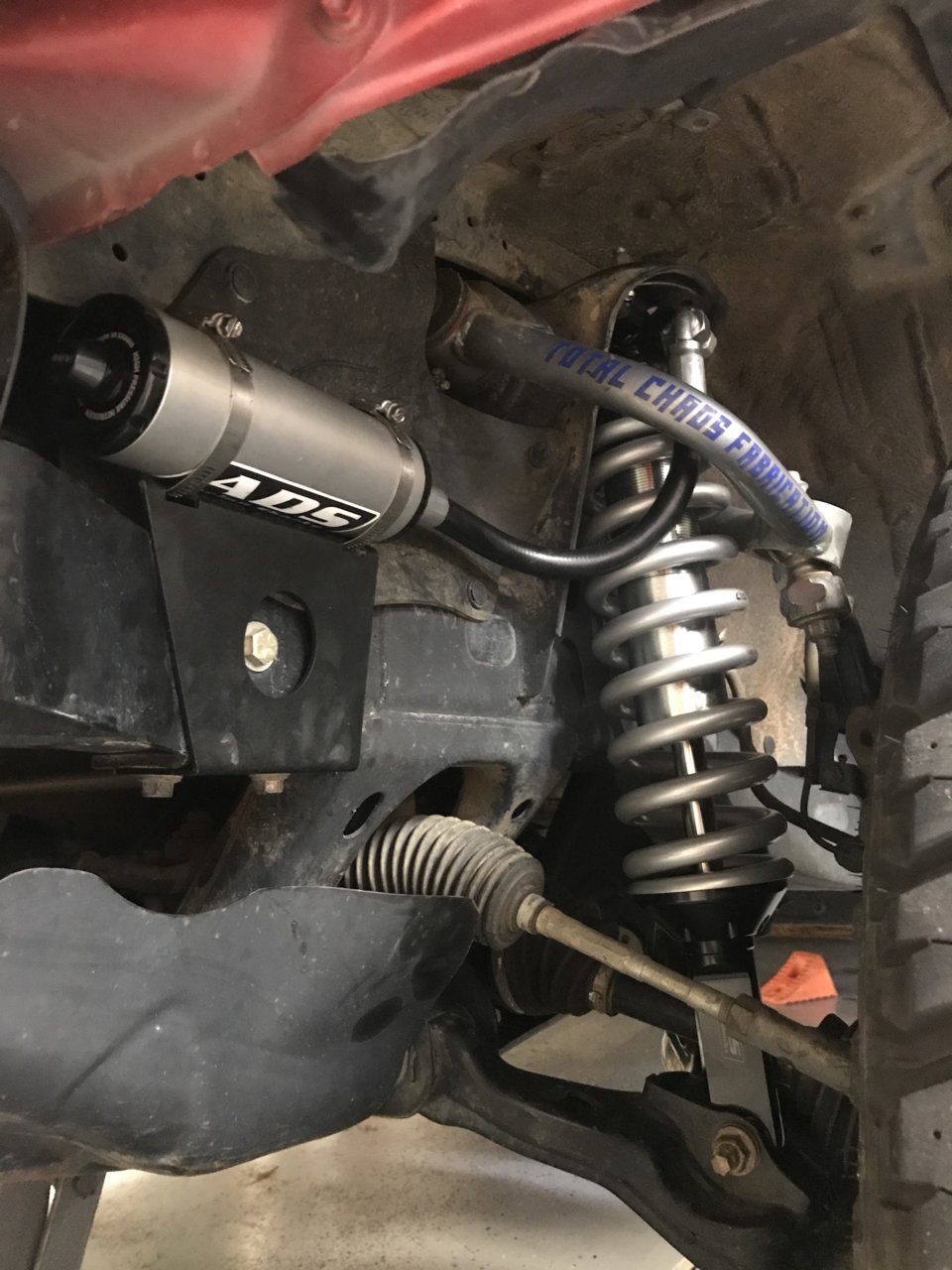

    Anyone know how to adjust the front CO preload without removing them from the truck? I tried lifting the front wheel off the ground and turning the spring nut, but it's extremely difficult to turn (yes, I loosened the set screw). I decided to stop before I break something. I've heard you have to remove the CO and use a spring compressor before adjusting the preload. That seems crazy considering other brands don't require this.

    Might just be damn tough if you’re running 700lb springs. When I spoke to ADS on the phone they recommended pulling them off the truck and using a spring compressor. Most companies are recommending this now probably to CYA.
    Otherwise, spraying the threaded shaft down with WD-40 or some kind of Teflon dry lube and using a longer punch for leverage may work.

    Yea, I'm running 700lb springs. I used a 18" long wrench on the punch. Still was really difficult. I can get it to spin but it feels like I'm gonna break something. I lubed it down, but still didn't get easier to turn. Pulling them off to add preload is a pain in the dick. I tried several ways of compressing the spring with it still on the truck but didn't have any luck.

    A 700lb coil is a fucking large coil haha. My 500lb coils are easy to adjust. I find a spanner wrench works better. If you have Uniball uppers, I would just quickly separate the upper control arm and spindle, slap a spanner wrench on it, put a 5 foot cheater on that, and just go for it.

    I had the same problem. But I found that using white lithium grease in a spray can works great. Still requires quite a bit of force to move, but it’s possible. I was able to put about an inch of preload on them in the end.

    Do you have 700lbs springs? How much force are we talking? 5’ cheater bar force?

    Yep. 700 lb springs. And no cheater bar. Used a steel punch that fit the holes exactly and moved it with that. Maybe had 6 inches of length to the punch.

    It took a ton of lithium grease spray but it works. I didn’t think it would to be honest. And definitely use a steel punch, I broke the tool from ADS. Haha.
