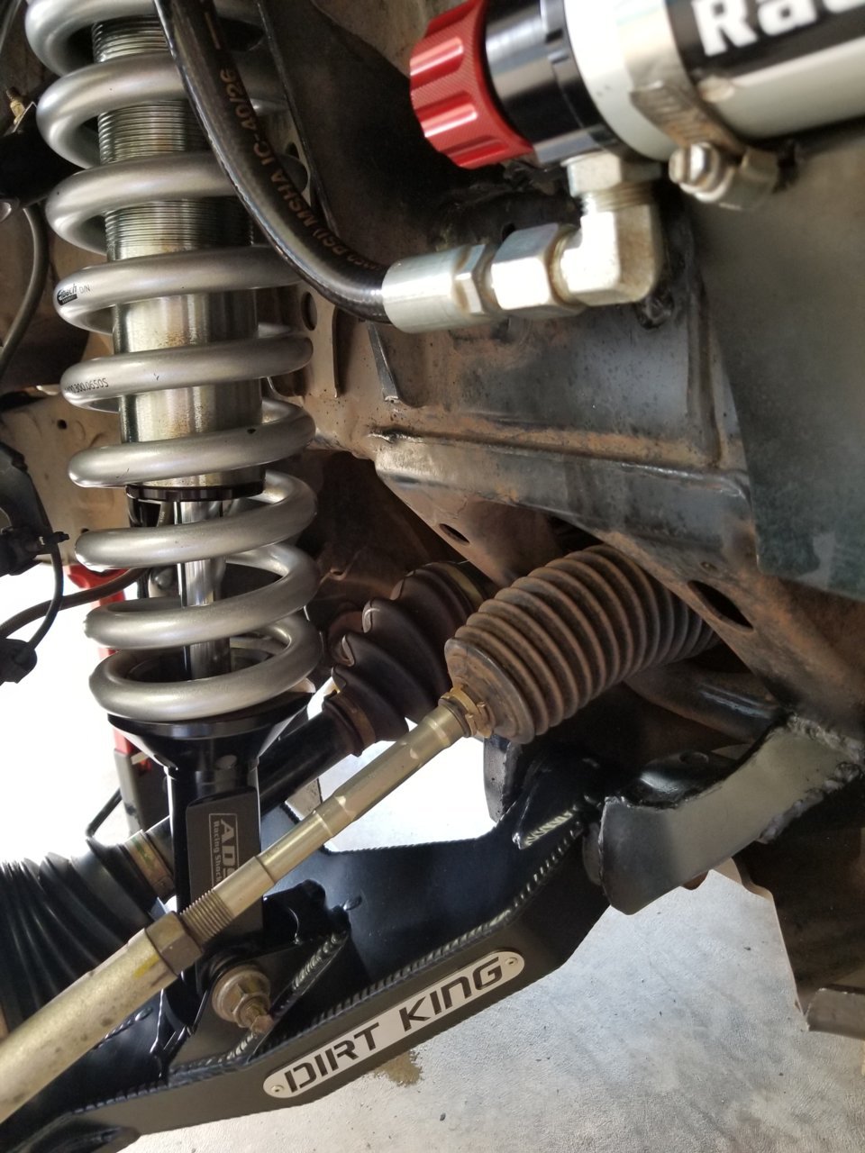

    I cleaned mine up today to make sure they still looked good.

    Where did you get the gussets for the LCA tabs on the frame?

    Dirt Designs
