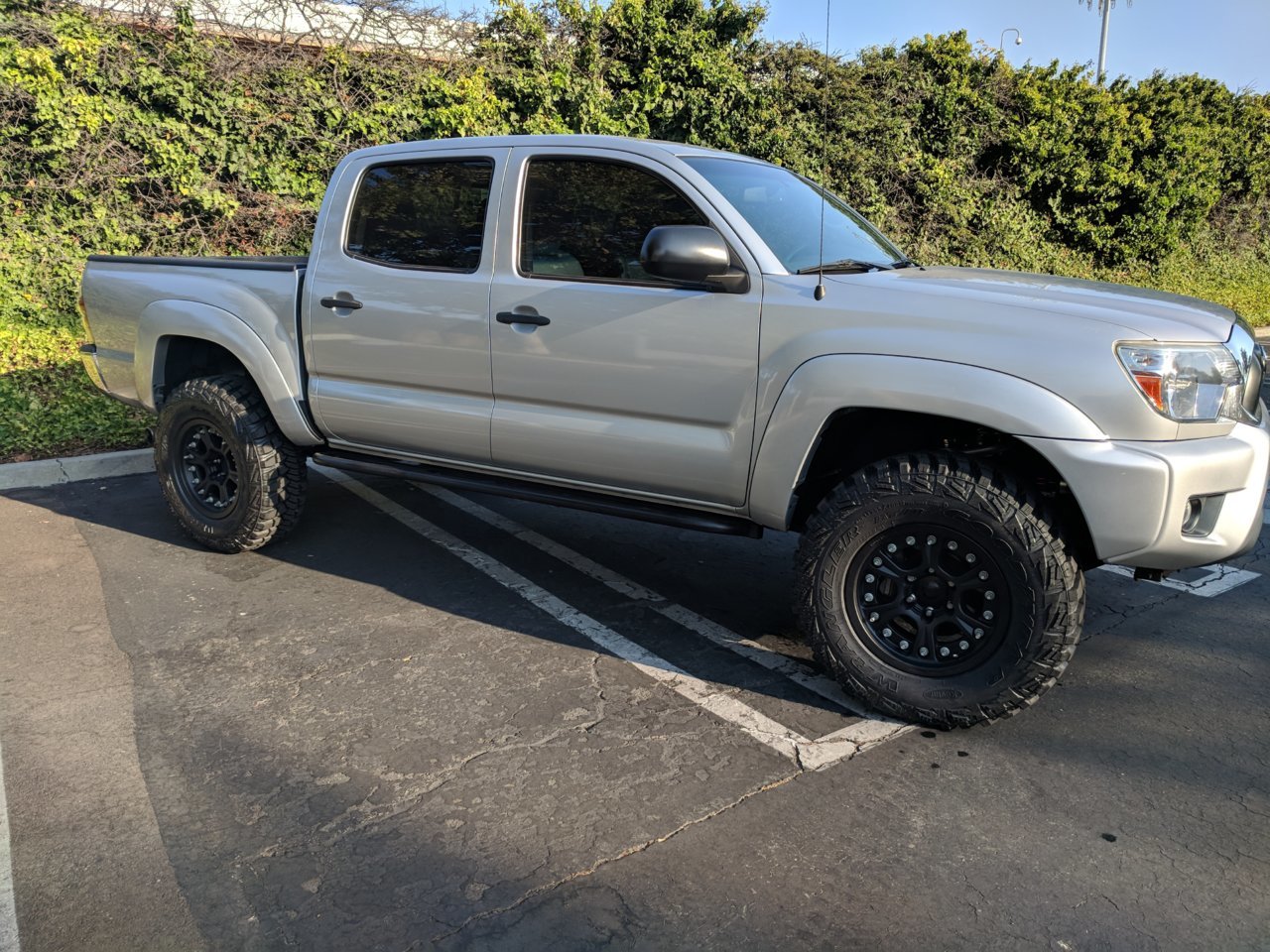

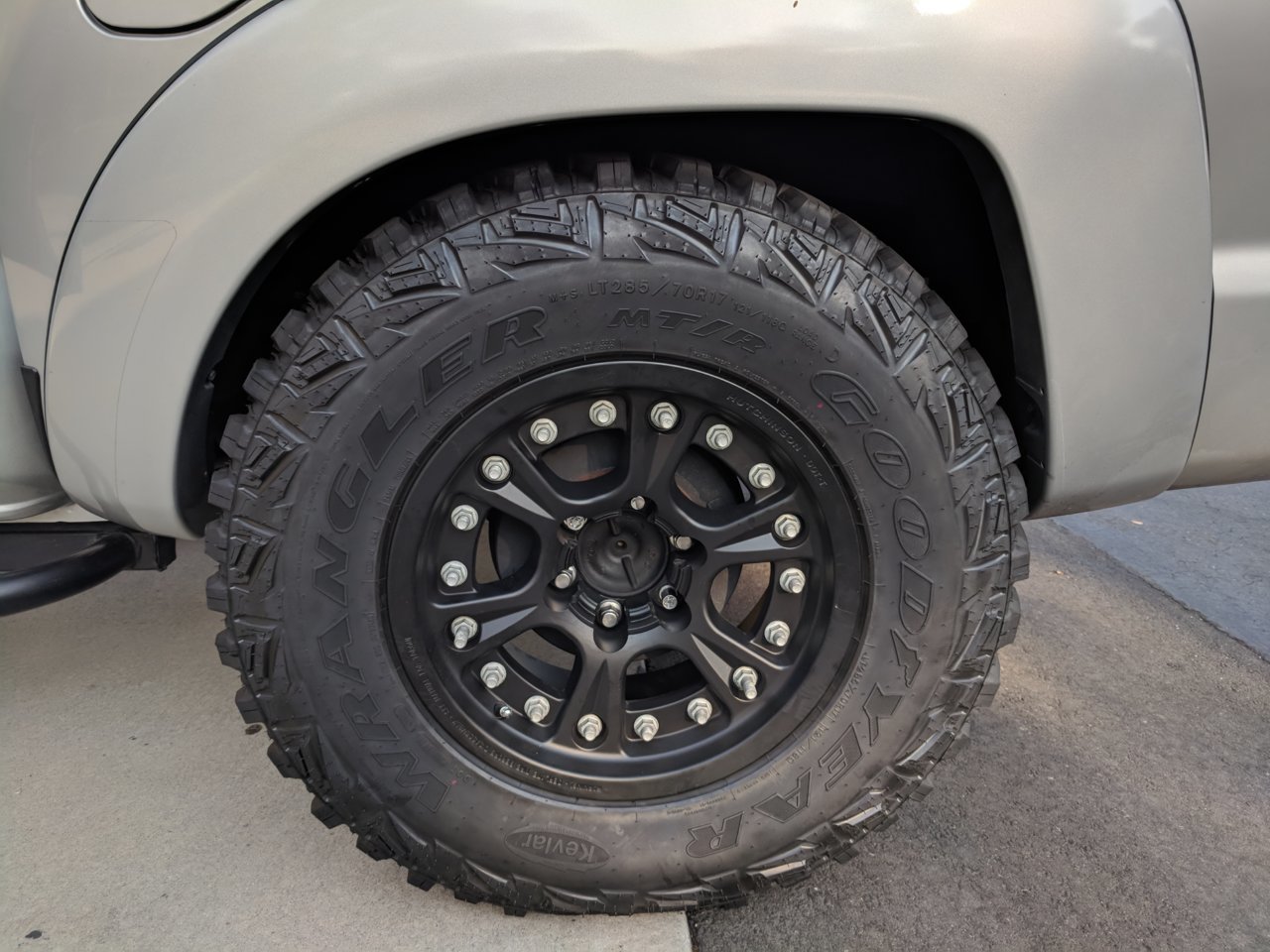

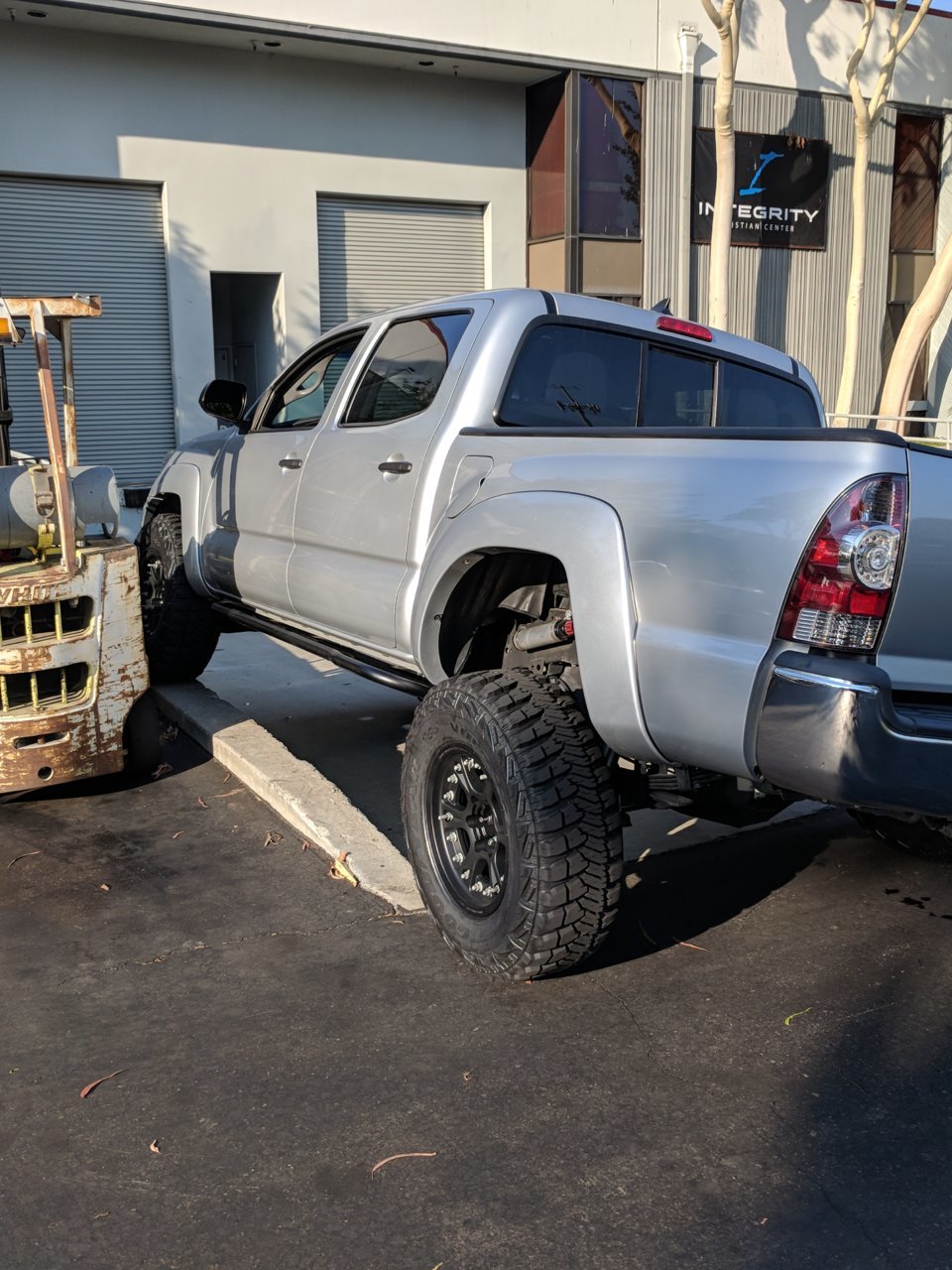

    Noticed I or may not have as much lift on the front as many of you with the same shocks. I have 700lb springs. I have not adjusted the shocks much other then getting the taco lean out. Has anyone been able to level the truck. Would like to be at the max logical lift without wearing out something the rear is about an inch higher. Was able to check out the rear shock today by getting some some flexing in. need to check out the fronts but need a better spot.

    You want to have at least 2" of droop travel to avoid having the shock top out to easy. The Tacomas are tough to get aesthetically level because of the way the wheel well openings are. I prefer to leave at least a 1/2" of rake towards the rear so that when you load the bed up, you have a better chance of the truck sitting level and not making the front end taller.

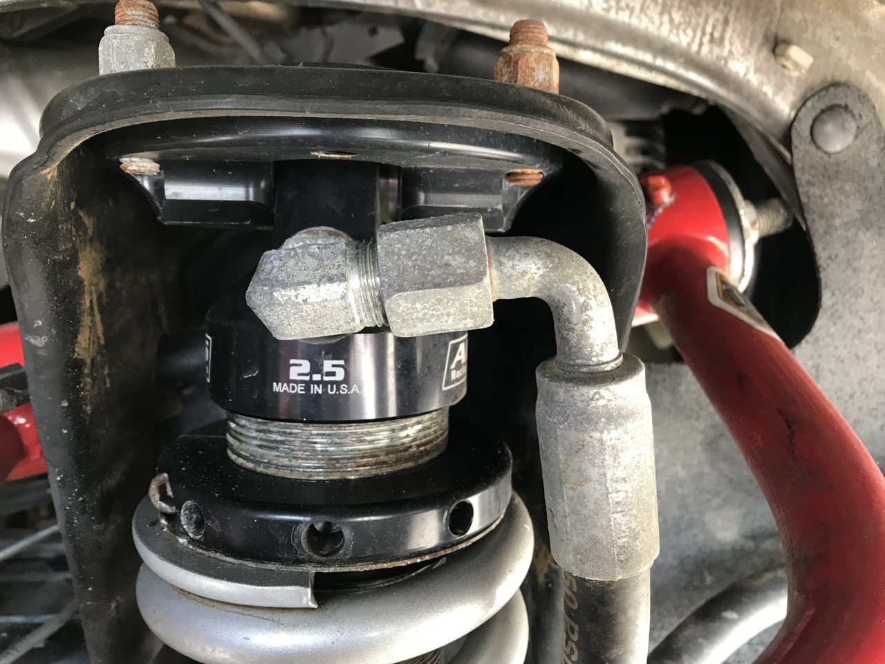

    any luck adjusting these while still mounted?

    Yup, just lube the threads really well. Only back the set screw out until you can turn the adjusting ring. I used a punch instead of the spanner wrench.

    Lots of lube! And if that punch or drift still doesnt move, put a tube over it and use it for leverage. Worked fine as long as the wheels were off the ground

    just went out and cranked my drivers side.
    i have a 4runner with known drivers side lean issues. that and i have a 31m battery installed instead of stock.
    drivers side now has 1-1/4" thread exposed
    passengers side has 7/16" thread exposed
    thats 13/16" difference between both sides
    still about 1/4" variance in lift between the front driver/passenger. but rears are about even with full tank of gas. slightly higher on drivers rear with 3/8 tank.
    ads never did reply to me about how much thread i can safely have exposed. i have 650lb springs.. i think...
    running a plate bumper, and some lights on the front end adding weight, as well as supercharger and oversized starter battery.
    does anyone know how much exposed thread is safe?
