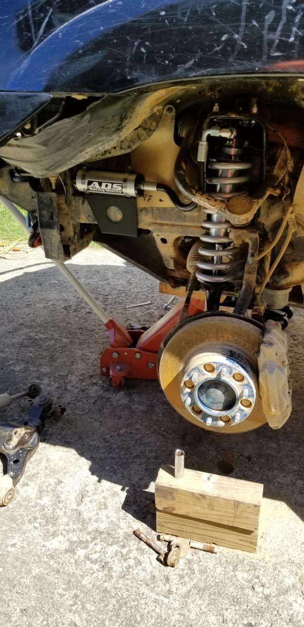

    Hi guys. Just installed the 2.5 COs with remote reservoir on my 2018. Was wondering how you guys managed to route the remote reservoir properly. I have to pull the mount towards the wheel for it to sit correctly with the tubing not hitting against the shock/coil casing. I am thinking I can pull it forward more but I have cut through the fender wall.

    Hey man. I just put some 2.5s in on my 2016 yesterday and it was a bit of a challenge. Here is where we ended up:
    Passenger side:
    Driver side:
    We were very close to the tubing hitting the coil overs. And in fact on the driver side we put in a little insurance against this. Close up:
    Just a bit of material zip tied around the tubing for protection.
    Hope this helps.

    Hmm, I didn't have issues with this on my 2016. Are you guys sure you have the block that you mount the bracket to turned the right way? It should have the bolts you actually tighten down on the bracket forward enough that there's no issues. I can get a finger between my hose and CO's

    Can you send a pic so we can see what you mean?

    I think @Jibbs is referring to the block/ spacer that goes between the frame and the sway bar which is where the resi bracket mounts up
