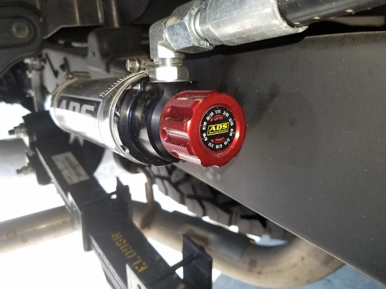

    I am sure you are shocked to learn that my post is about shock adjustment. I am going to admit that I have no idea how to do this. I know how to turn a knob, mind you. What I don't know is how much, what direction for what circumstance, etc. And no instructions came with my shocks, so....
    I guess my two questions would be:
    1. What is the reference point for knowing the current setting? For instance, what is the setting of the shock pictured?
    2. Any advice on what settings to use under what conditions?
    Thanks in advance.

  11. Sep 6, 2018 at 1:38 PM
    #1631
    SpeySquatch
    SpeySquatch Function over Form
    Mar 6, 2018
    #246516
    7,366
    2016 TRD OR DCSB
    C4Fab LoPro, BAMF Sliders, Ext ADS 2.5’s, 4.88's, OVTune (OG to KDMax)
    Damn good question. Is the hose the set spot?
  12. Sep 6, 2018 at 1:40 PM
    #1632
    TACOVRD
    TACOVRD I Identify As A Prius
    Jul 11, 2015
    #159264
    6,437
    TW Addict
    AZ/WA
    2019 T4R ORP - Formerly 2013 DCSB OR Spruce Mica
    Workin' on it....
    Due to the hundreds of different weight combinations front to back, bumpers, bed racks etc. there is no right or wrong for each individual setup - just what works better for you.
    Turning the knob all the way counter clockwise puts you at 0 compression. Every one of the next 20 clicks in a clockwise direction makes the compression that much firmer.
    In order to tell where you are reset to 0 or +20 and count up or down as the case may be.
    I run +12 on my rear shocks with a bed rack and it drives great on road. Off road, slow speed I may soften them up a bit. There are no instructions because you need to figure out what works for your specific rig.
  13. Sep 6, 2018 at 1:52 PM
    #1633
    AgingDisgracefully
    AgingDisgracefully Well-Known Member
    Apr 26, 2018
    #251737
    719
    Peter
    2016 Tacoma SR5 V6 4X4
    Thank you so much. So, as a general rule, firmer on road, less so off?

  15. Sep 7, 2018 at 4:23 AM
    #1635
    TRD493
    TRD493 Well-Known Member
    Dec 27, 2015
    #173269
    1,723
    Dave
    Texas (DFW)
    17 TRD Sport DCLB 4x4 / 01 4x4 V6 Extra Cab TRD SR5
    I just assumed they came in the middle of the settings from ADS. I had the same question about adjusting them....until I wiped all the mud off of them and saw the arrows! When I'm off-road I adjust the fronts up (more firm) about 5-6 clicks to keep them from hitting my bump stops so much.

  16. Sep 7, 2018 at 8:55 AM
    #1636
    riz_atx
    riz_atx #bigpermtaco #teamBP
    Jan 5, 2017
    #206621
    10,674
    Sohail
    Spicewood Texas
    ‘16 4x4 DCLB GFC Locked, Geared, Tuned
    C4Fab/RCI/BAMF, ADS, 4.88, Lockers, OVTune
    Just a slight correction, setting it to 0 gives you no additional compression dampening. you will still be able to compress the shock :)
    I usually run it at 5 clicks on the road. This allows me to not have to slow down whatsoever on speed bumps. Off road, I tend to firm it up even further to prevent bouncing... especially if I am loaded up. if we are planning on going fast off road, liek 35 mph+, then i will turn them way up.
    When I spoke to Brian @ ADS, he mentioned that at full 20 clicks, should be able to hit a 7" rock at 35mph without any issues. I can confirm that you can drive a lot faster on rugged terrain with it turned most or all the way up.
    Best thing to do is to set it to something, run some trail. Change it, run it again and see the difference. This will really quickly get you into the right setting for you and your truck on that trail.
