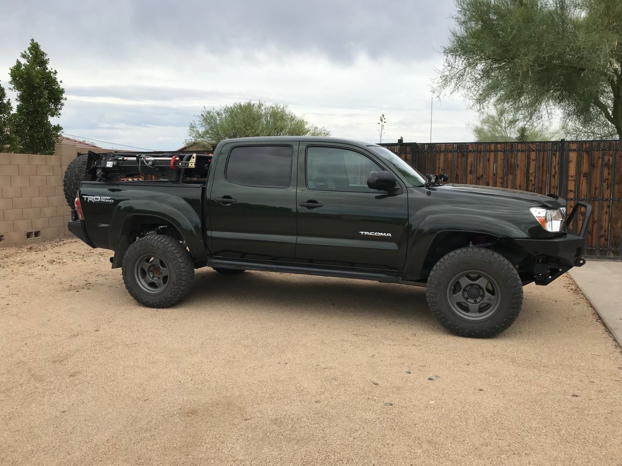

    @SpeySquatch
    Here is with the TRD Pro Bilsteins up front (600lb spring rate) and ADS rear shocks in the back. There is no winch yet but it is planned. I'd like the front of the truck to be about 1" - 1.5" higher than it currently is sitting so maybe the 650's might get me there.

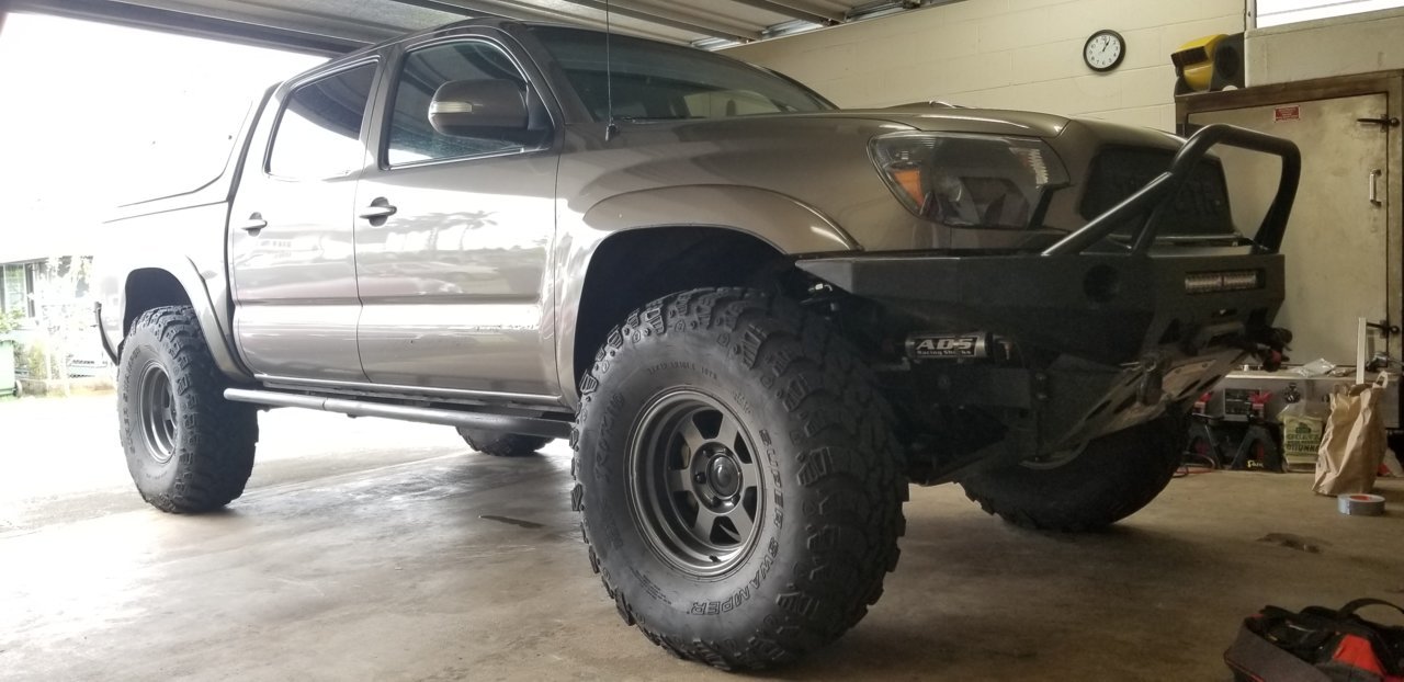

    Just try the 700's first. You need to remember that there's nothing wrong with preload. That's what the adjustable coilover is made for. Just don't exceed the amount of preload that you will reach the block height of the spring. I'm actually installing the 600's later today and if my calcs are correct, I will have to preload them .26" more than the 650's, which is fine with me. I personally think that it's better to have a lighter spring with preload than a heavier spring with no preload at all.

    There's a little, maybe 3/8" to 1/2" of threads showing. But I wanted my ride height pretty low.

    Those tires you are running look Huge!

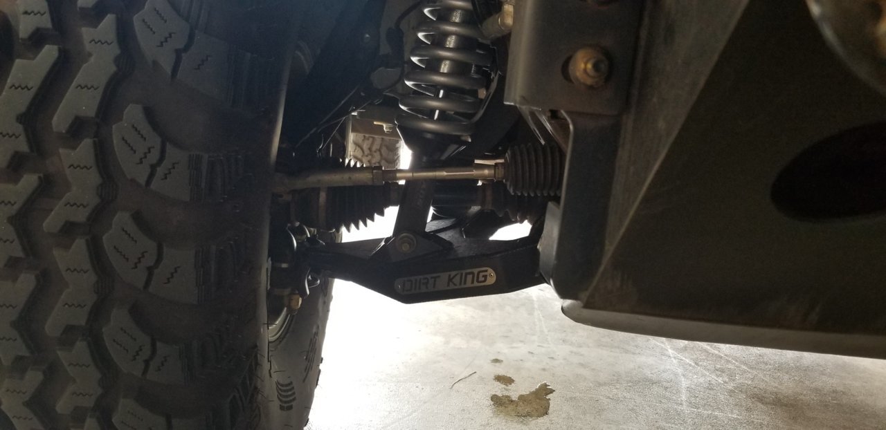

    Nope. 14 x 500. I have a decent amount of preload.
    No coil bind though
