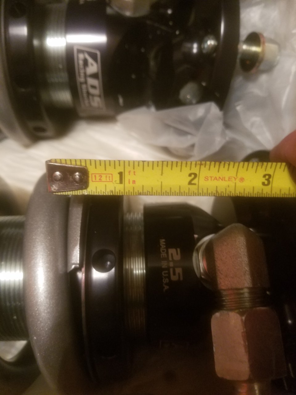

    With the winch and all it is probably closer to 2" preload, but I have limited experience and I am pulling that number from the air with a little bit of an educated guess. I have the 700lb springs also, and with no armor I am at 1" preload for 2" lift. It is super easy to adjust the preload on the truck but not recommended by vendors and I cant be held responsible for peoples safety ;) I sprayed some wd40 on the threads above and below the collar and used a 5/16" pin punch, a 5/8" extended socket over the punch with an extension on the socket to add leverage. Was not too difficult, remember to have the wheels off the ground so that the weight is off of the coils.

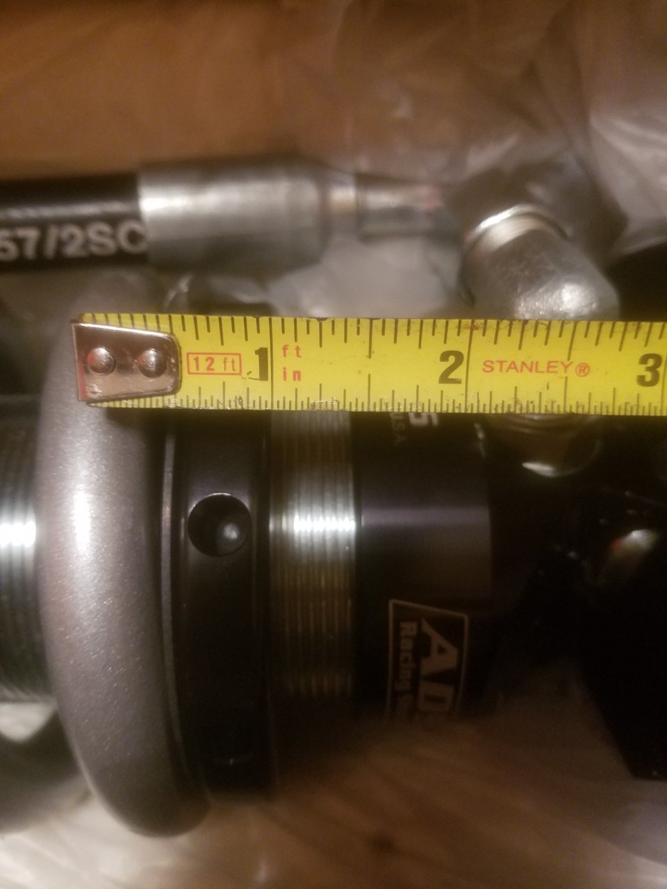

    The factory preload of 1/2" had me at ~1" lift, I took the preload to 1" and am at ~2" lift.

    Left the tires on, sprayed wd40 on the threads above and below the collar, loosed the collar, then used a 5/16 pin punch to adjust the preload. I slid a 5/8 socket over the end of the punch and put an extension on the socket for leverage. Of course, I had the wheels off the ground with the truck frame on jack stands and the wheels hanging. It was pretty easy to adjust.

    Nah, at first I tried it without wd40 wince I couldnt find mine and I ended up bending my punch. I then bought wd40 and it was easy. I sprayed all around the collar and let it sit a few minutes then started turning. I am not a big guy 5'11" 145lbs and could turn it pretty easily with that method. I went to 1" preload using this method.

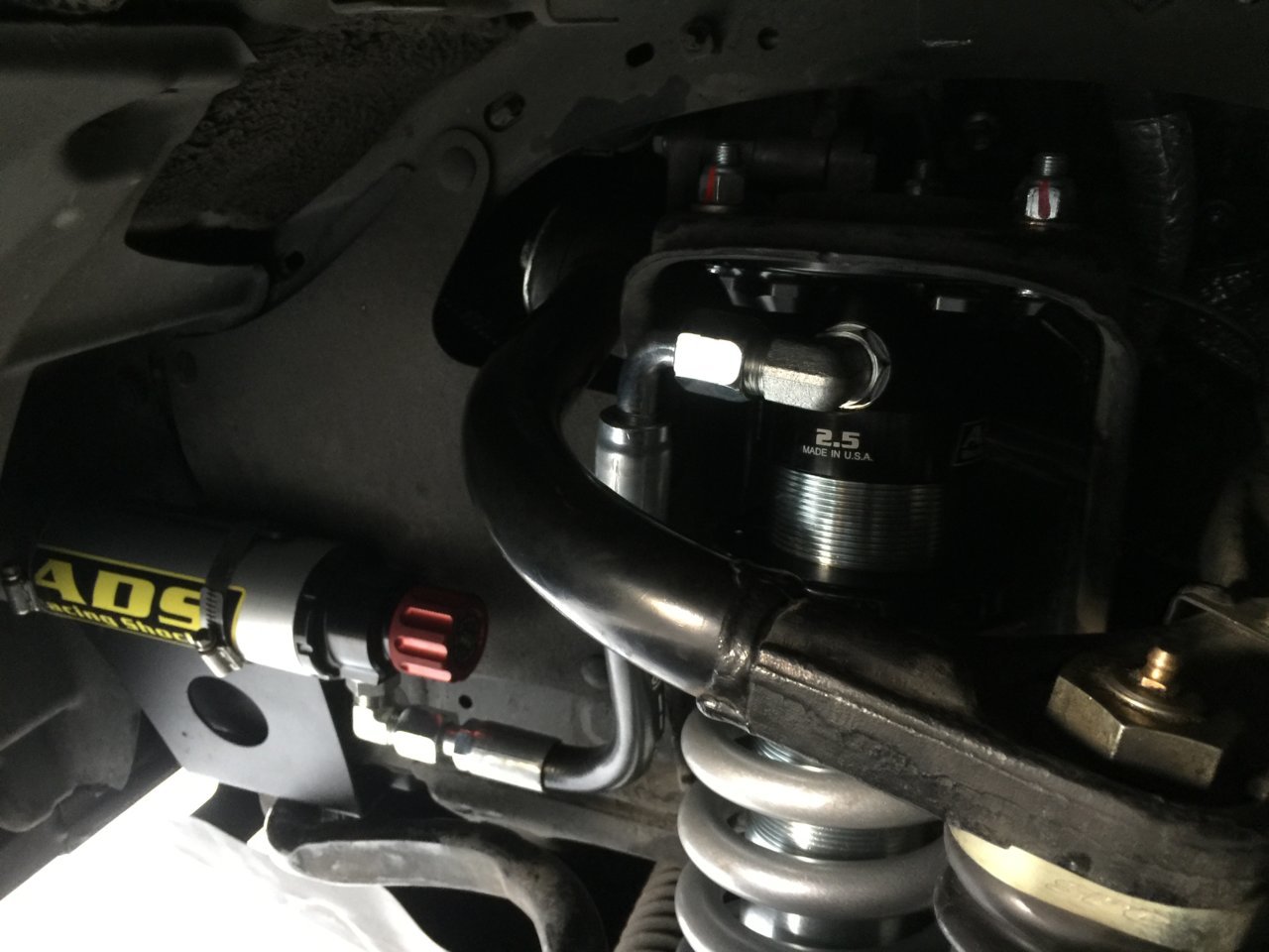

    Ok, got the shocks on, but I am sitting at 1.75” lift with 1.125” preload (bumper and winch at 130lbs) and hoping to go another 0.5”
    I will obviously need another alignment after I do this, but they ride nice for now. Fender sits from center of hub at 22.75”
    Still running the OME rears
