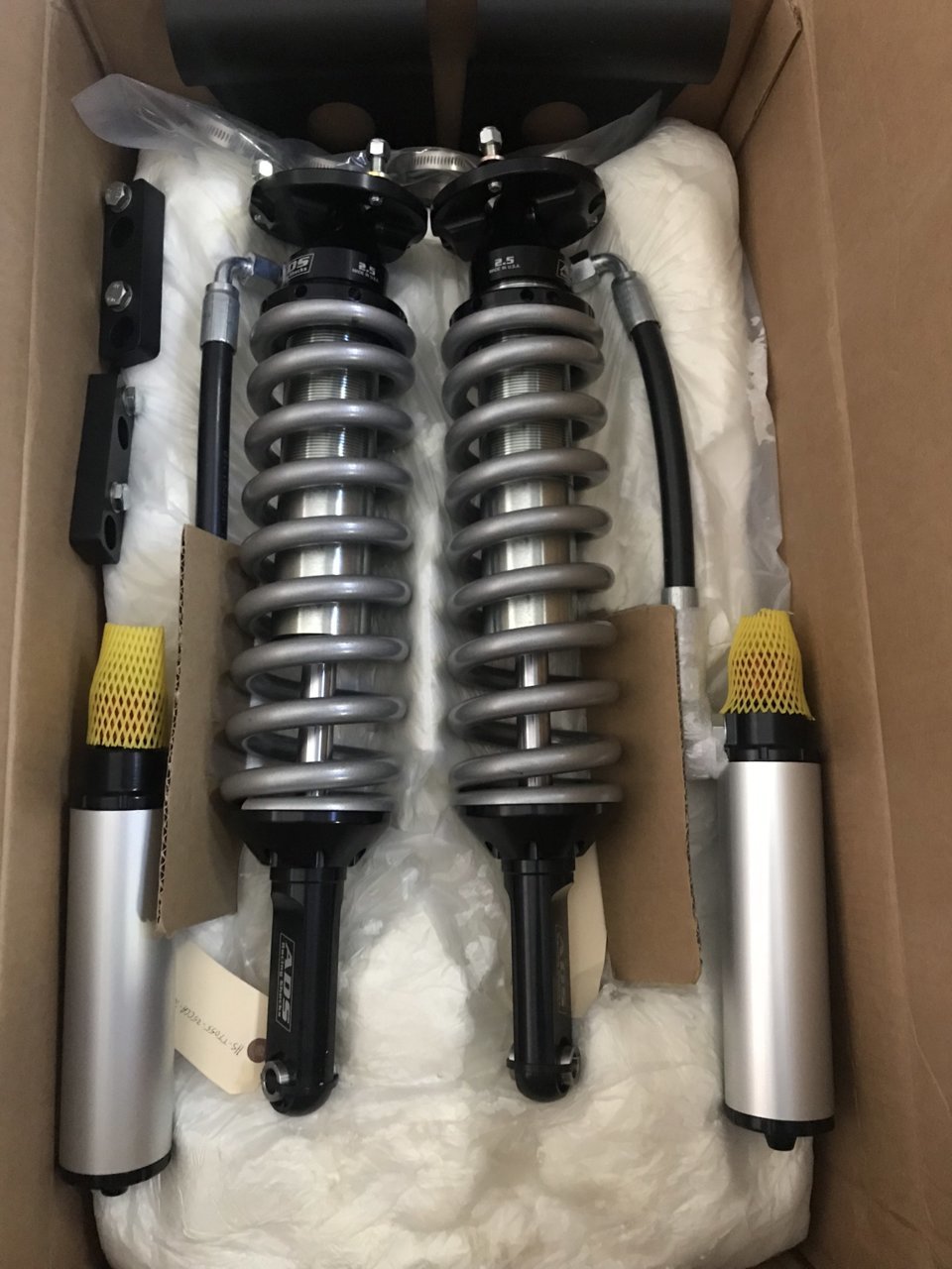

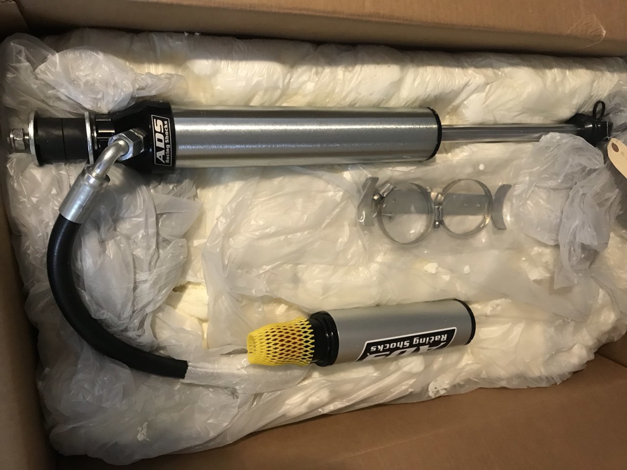

    ADS suspension is in. Here is everything I did this past weekend.
    Miles ~21,400
    Changed both front and rear diff gear oils, used Lucas 85W-140 per ECGS, sending oil sample to Blackstone for analysis
    ECGS Bushing
    Front ADS 2.5" Coilover with RR and Clickers
    LR SPC UCA, ball joint grease with STA-Lube SL3330
    Rear ADS 2.5" Shocks with RR and Clickers
    HD Dakar Leaf spring with energy suspension polyurethane bushings
    Steel braided extended brake lines, bled with Mobil 1 DOT-3
    It was a hell of a job for the driveway. A friend of mine came down and helped me knock most of it out Saturday. I ended up not doing enough research and messed up one of my shackle bushings due to the metal collars they put in them at the factory. I eventually figured it out, used a jig saw to cut the collars out, ordered new shackle bushings, and completed the install today. Overall pretty straight forward install. My driverside preload is ~1" and my passenger side is ~7/8" and I have achieved ~2" of front end lift. The rear of the truck is over 3" lift, I dont have my camp weight in there yet, also waiting for my GFC to be installed in November. I am hoping itll settle down some and I may add some weight to help until I get my GFC. I left the sway bar off as well, we will see how it goes. Did a quick test drive and it feels good so far.

    Looks great man! I’m going to pick up my fronts tonight.
    Just an FYI if you haven’t already planned on it you are going to want to get some different bump stops in there to account for the new travel of the shocks and leaf pack.

    Thanks, I was going to get some wheelers superbumps but I wanted to flex it and figure out if I will need spacers or not.

    Your trucks looks ideal and superb. I’m doing the fronts on Thursday. Looking forward to it.
    Hope to get 2.25” from my current 1.5” OME.
    Try DOT 4 brake fluid next time you change. It’s like $3 more per bottle and has a 100 degree higher boiling point than Dot 3... I have boiled my fluid with Dot 3.

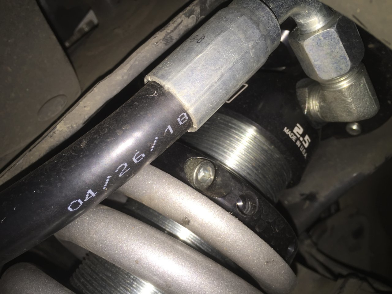

    Try to adjust the hose so it doesnt kink like that...

    4runner kits take a while.. when i ordered my 5th gen kit, it took a while..
    the front reservoir brackets... had to be cope-saw copied from icon brackets.
