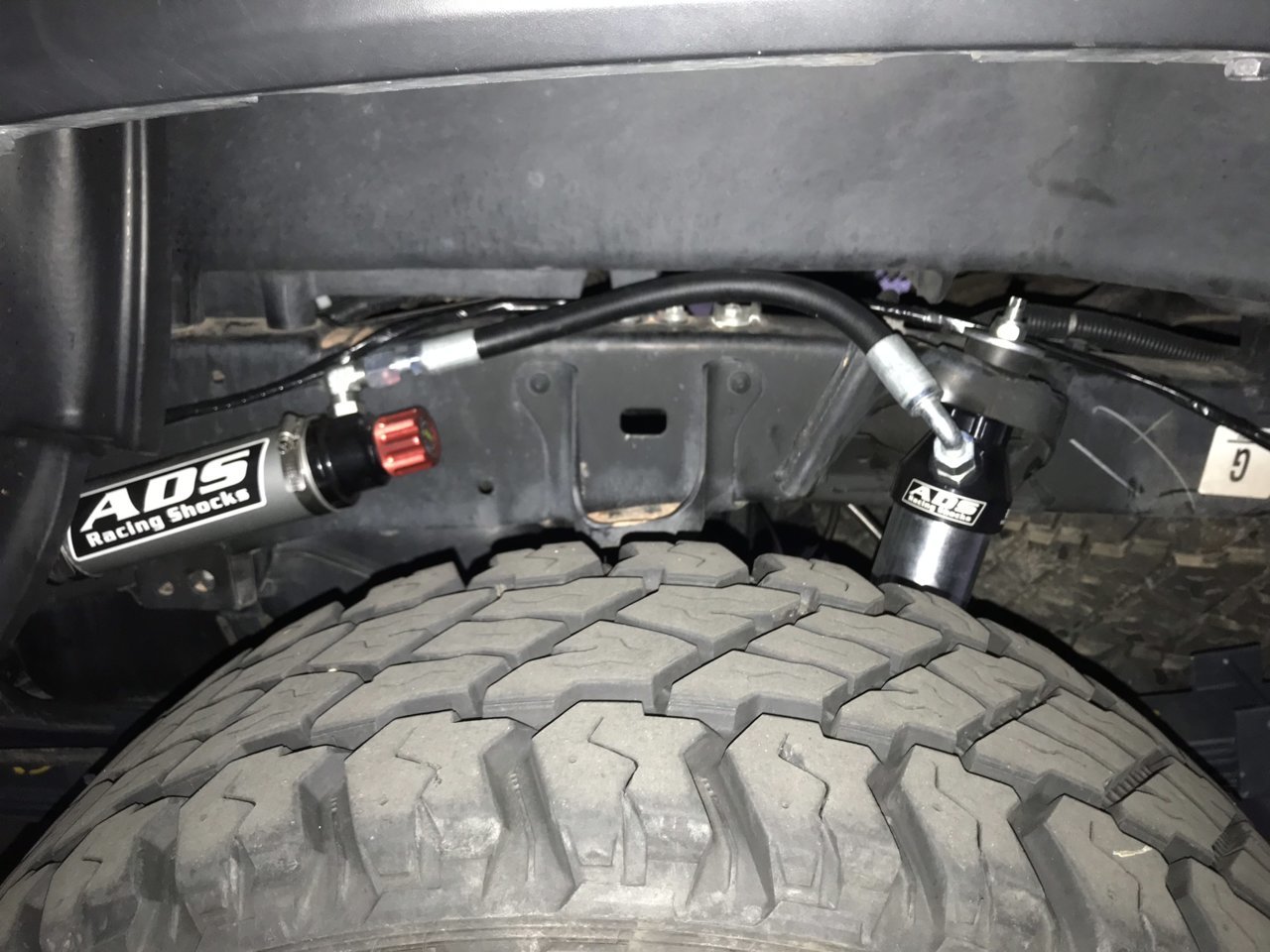

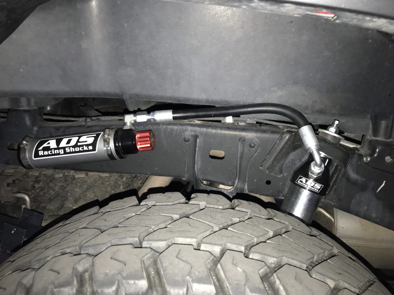

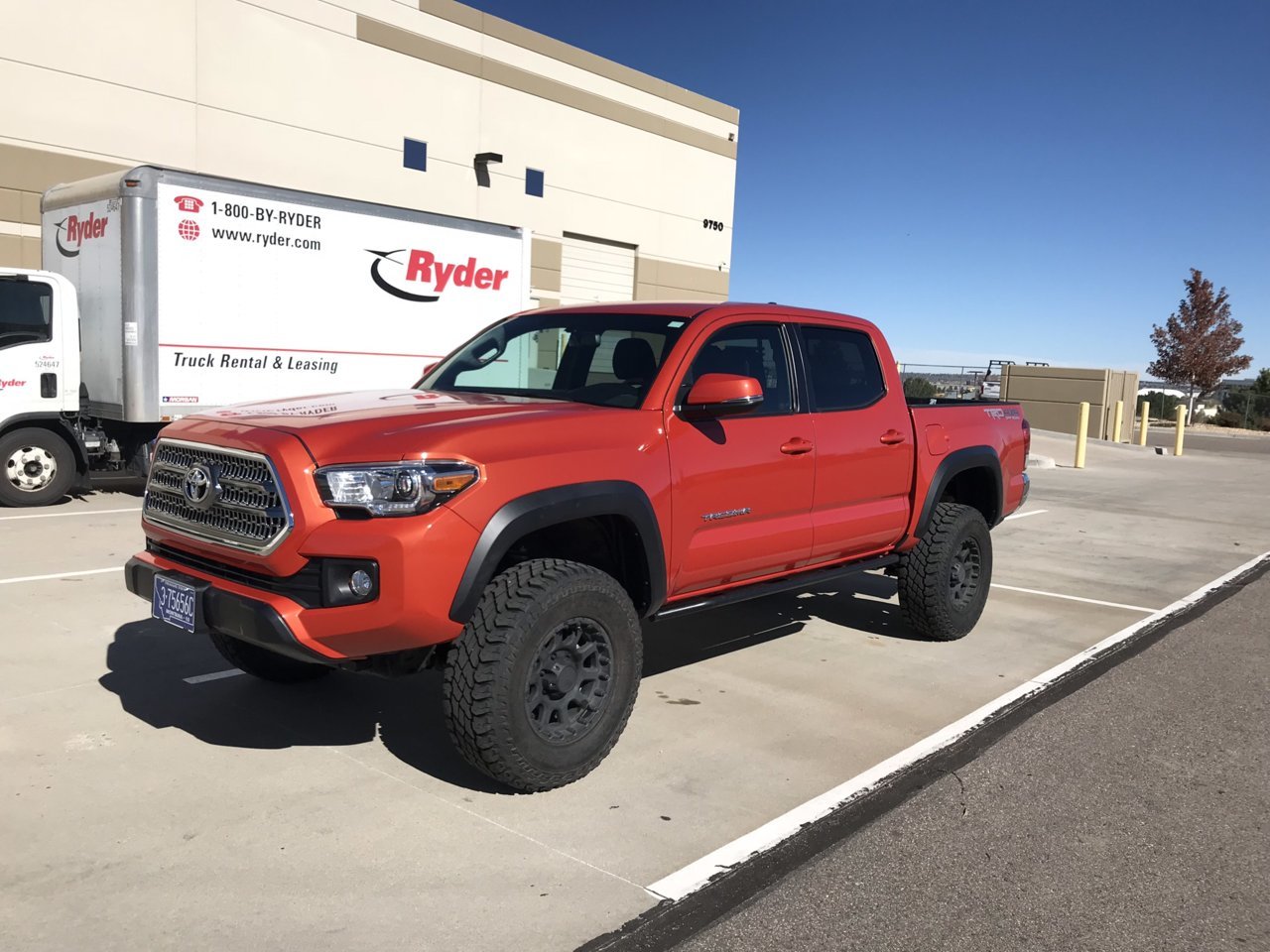

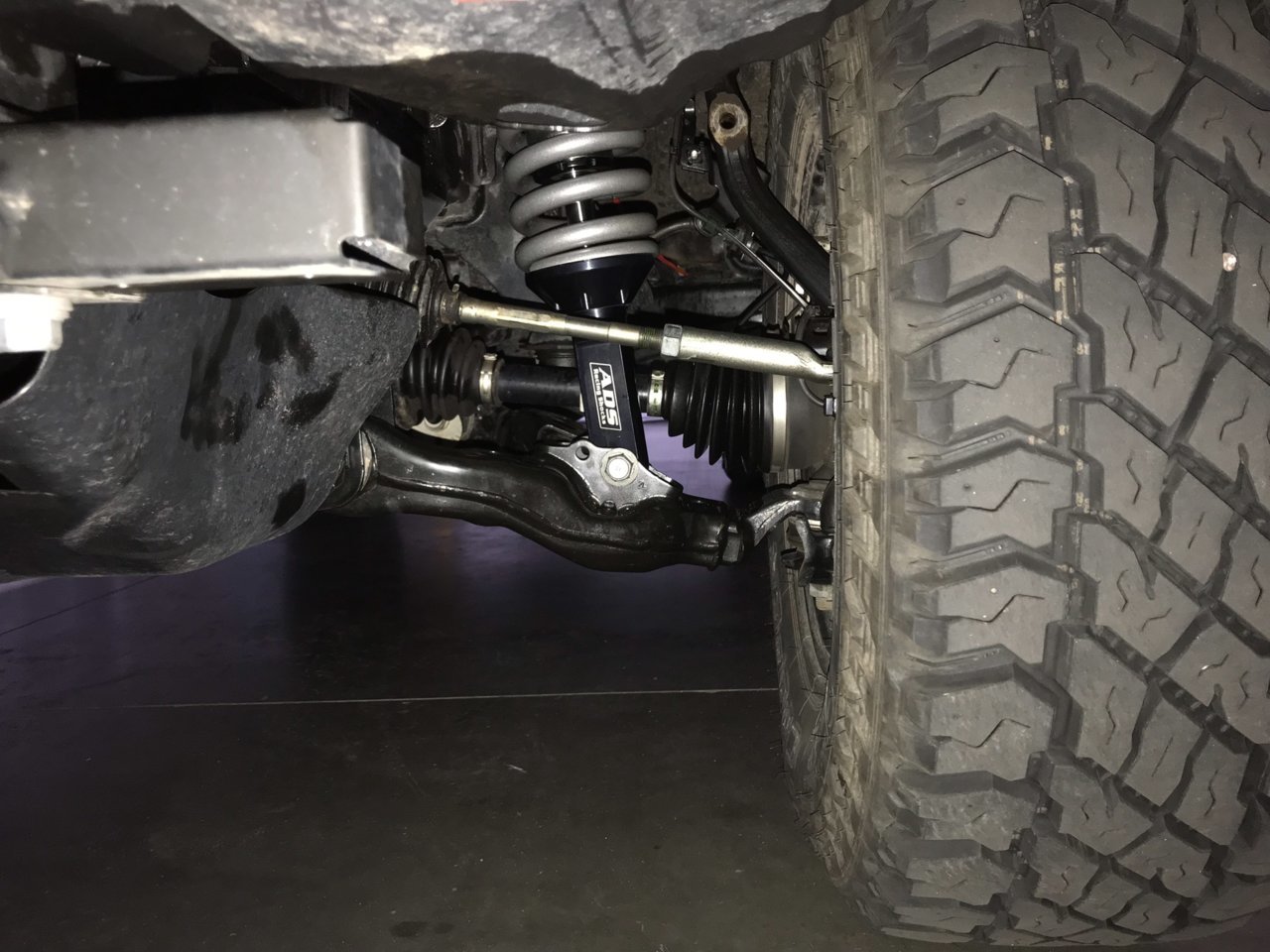

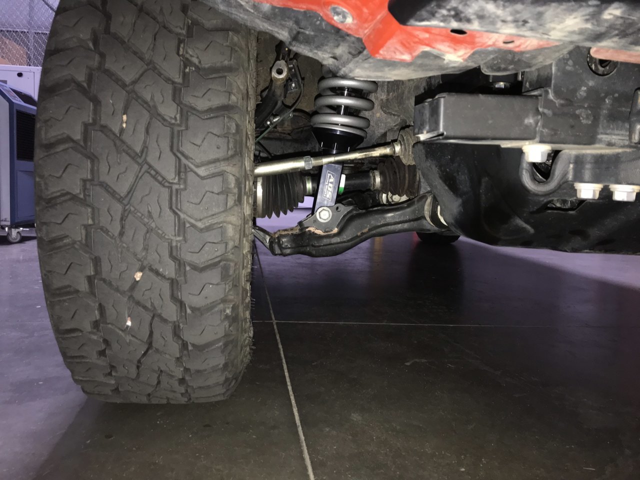

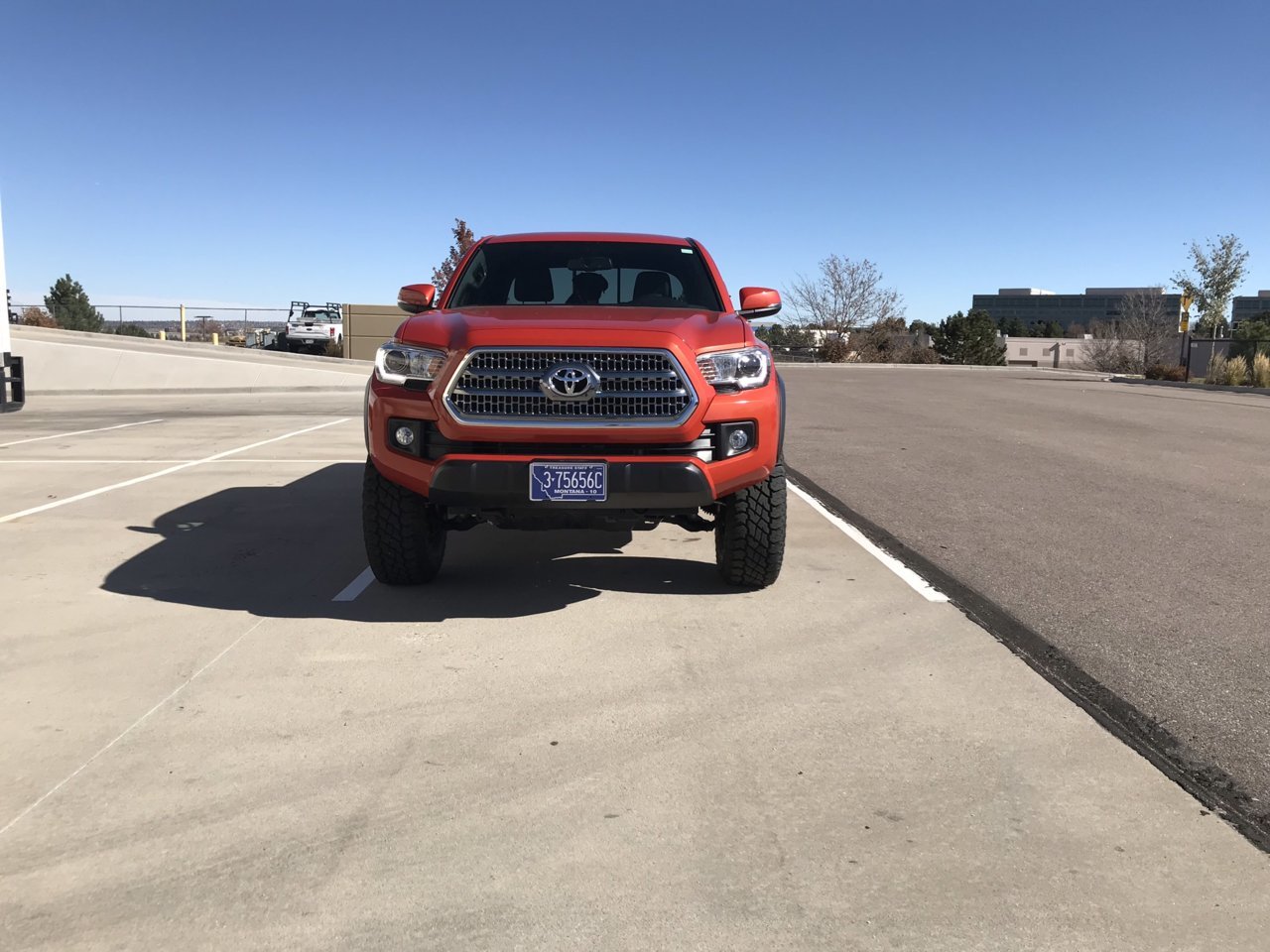

    Finally got a chance to take some pictures of what she looks like after the install. Driving without a swaybar is taking a little getting used to as I can feel the stiffness gone on sharp turns but overall it doesn't affect the driving too much. I have all of my clickers set to 0 at the moment and I am hoping to get on some trails to test out the different setting. There was an obstacle I tried with my bilsteins that I didn't have enough flex to get over so I am excited to try it with my new suspension and see home much more flex I am going to have.
    I am feeling good about how my truck sits currently, I am hoping that it doesn't settle too much. Measurements from fender to center hub are as follows.
    Passenger Front: 23.5"
    Driver Front: 23.25"
    Passenger Rear: 25"
    Driver Rear: 25"
    Tires Cooper 265/75R16 probably going to be getting 285s in the near future.
    I gained a full inch all around from my previous measurements. Now the only issue i am having is a vibration around 20-25mph and after measuring my drive shaft angles I ordered some shims for my rear axle and I am hoping that fixes the issue when they get here. Seeing as I have a 8hr road trip to Montana tomorrow I am crossing my fingers that something doesn't happen with the vibration to delay my trip.

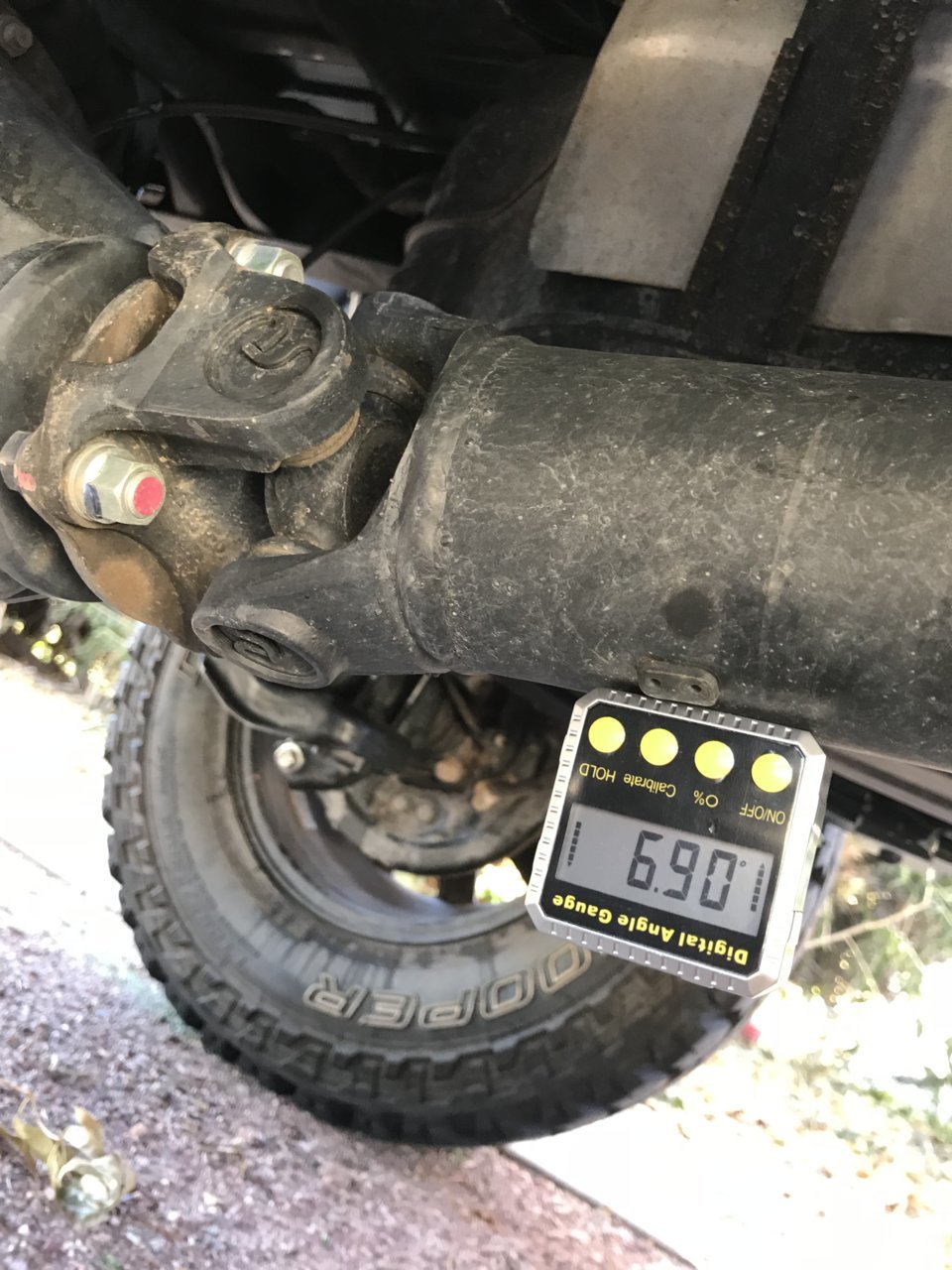

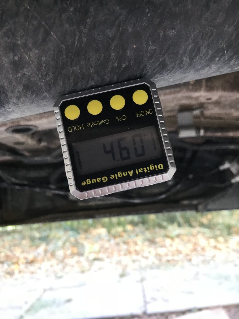

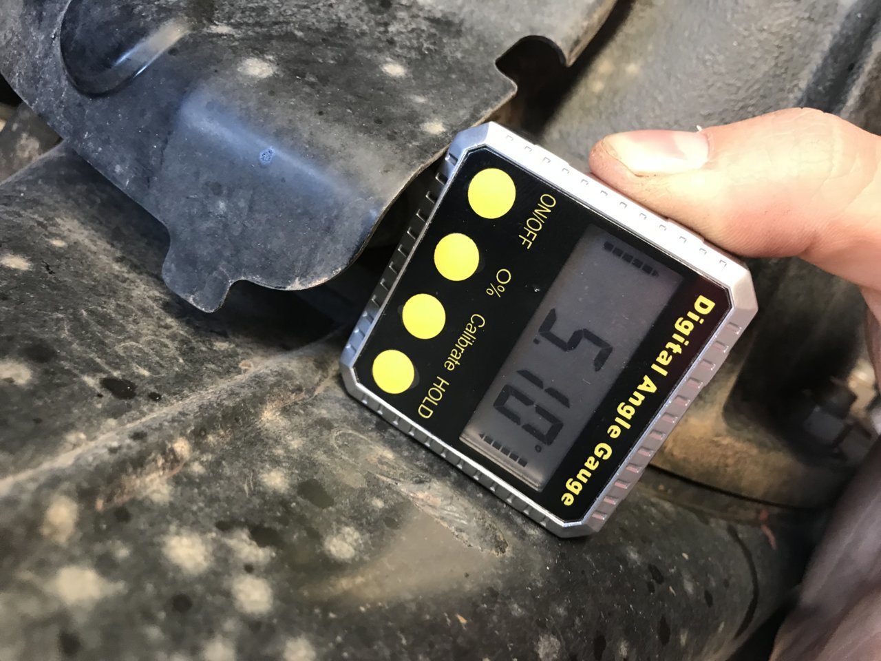

    These are my current measurements and from the thread I read I ordered 3* shimsE8B30CBF-3A2F-40AD-83EF-8BD47BA75D2E.jpg9AE08481-CACD-4491-A868-65DF6C91511D.jpgBF2CD264-D741-43A5-AF35-B1E559908978.jpg
  20. Oct 22, 2018 at 10:24 AM
    #1920
    SpeySquatch
    SpeySquatch Function over Form
    Mar 6, 2018
    #246516
    7,366
    2016 TRD OR DCSB
    C4Fab LoPro, BAMF Sliders, Ext ADS 2.5’s, 4.88's, OVTune (OG to KDMax)
    Is that a diff guard in your last photo? Did that come stock?
    Also, 3 degree shims should be ideal
