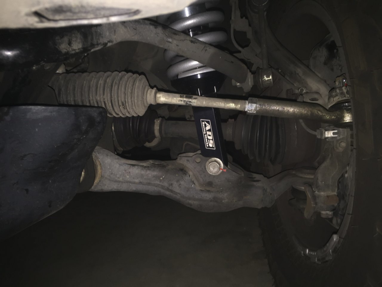

    What front bumps for this setup (if you can see it)
    Sitting at 1.75” of lift with 14” extended travel.
    For the rear running a 6-leaf dakar

    Its the stroke of your upper and lower control arm that dictates what size the bump stop needs to be. For all stock width LCA's we make one size bump stop. They are also Dual-Durometer just like the rear. You can see videos of the front bump stops in action on my IG account and website.
    www.toyotabumpstops.com
    Love them ADS
