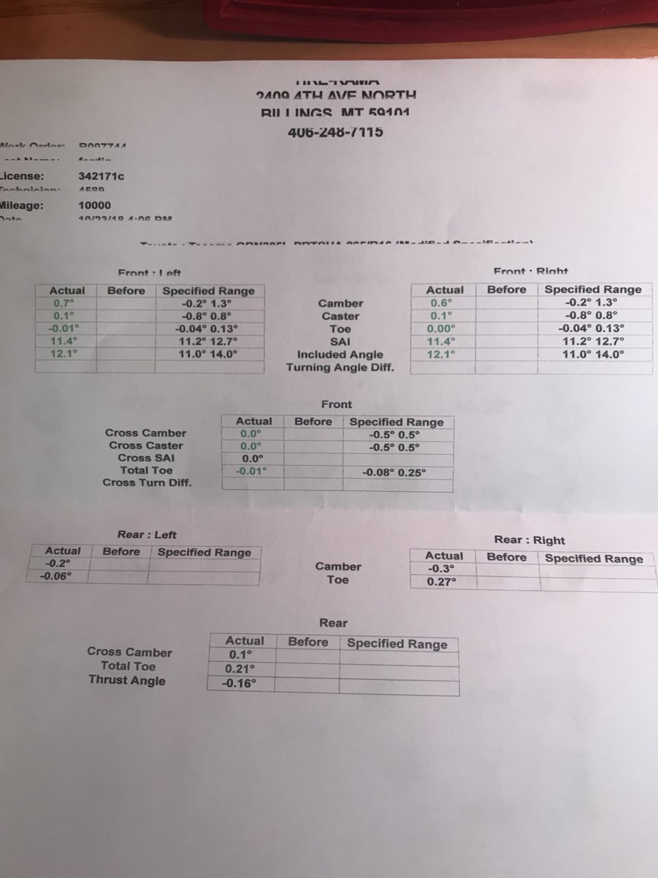

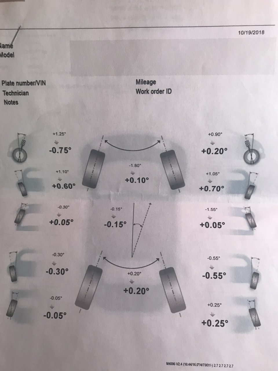

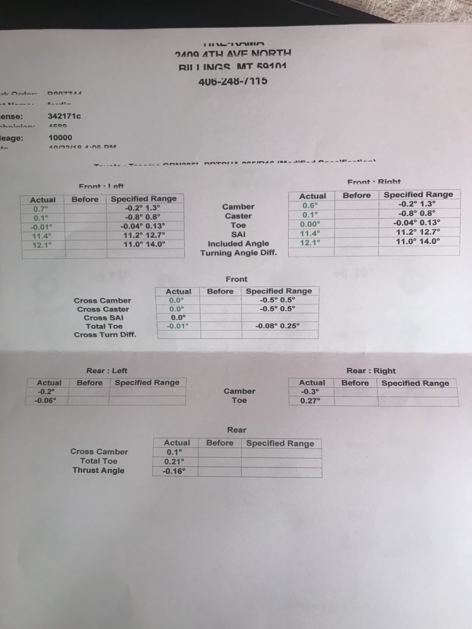

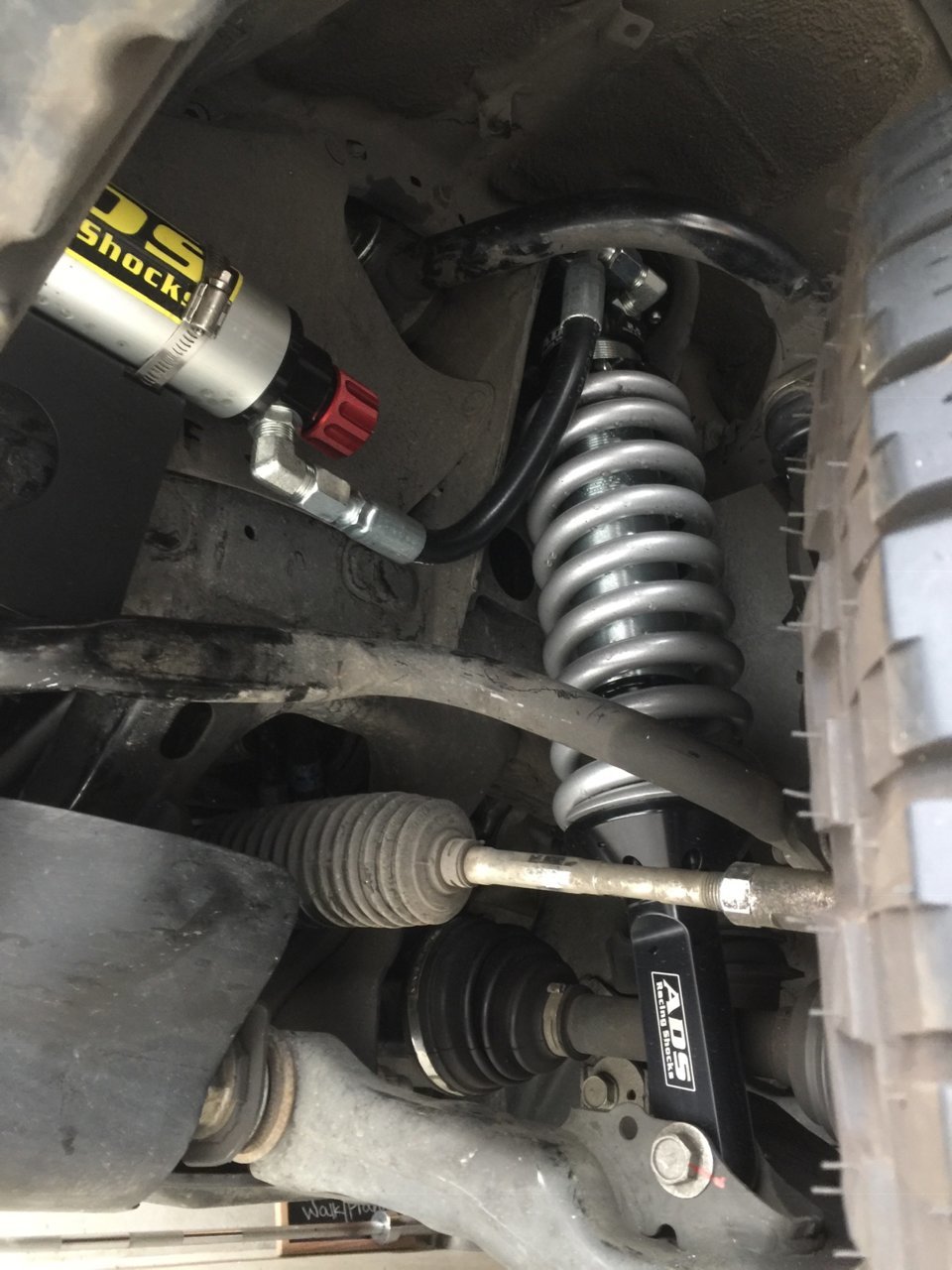

    Anybody with the level three suspension and Spc UCAs having alingment issues? My truck keeps drifting to the right no matter what kind of road I am on. They’ve tried swapping the front tires to see if that’ll help. I’ve also had them recently balanced. It only started doing this after my install of my suspension. Maybe somebody with more alingment knowledge can lead me in the right direction.

    Is your steering wheel straight when it drifts?
    (Serious question)
  6. Oct 23, 2018 at 10:04 PM
    #1946
    Theetrentmeister
    Theetrentmeister Well-Known Member
    Dec 14, 2017
    #238533
    217
    It is not, it tracks where the truck goes.

    C4Fab LoPro, BAMF Sliders, Ext ADS 2.5’s, 4.88's, OVTune (OG to KDMax)
    Hmmm is your steering loose? Power steering fluid low? I’m not sure ...it could be the “toe” angle of one of the tires

    217
    Steerings tight and all my fluids were just checked at my most recent 10k mile inspection. I always have bad luck with alingments, I’m gonna go to a shop I trust when I get back from vacation and see what they can do but I’m stumped.
    The print off you showed looks more dated than the one I get. The angles and measurements display with more detail and what not. I’ll try to dig one up and send it over

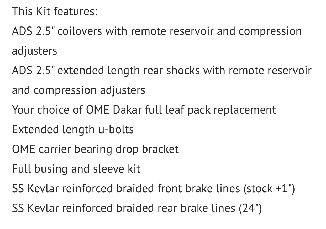

    So does anyone have any input if I should go with a ADs level 3 kit or bilsteins 8112s? They are some what close in price. I’d be ordering the kit from headstrong. I messaged them the same question and they suggested going with the bilsteins but wanted to check here as well.
  11. Oct 24, 2018 at 10:05 AM
    #1951
    Theetrentmeister
    Dec 14, 2017
    #238533
    217
    The reason I went with the ADS was because of all the good things I’ve heard and the ADS kit came with more stuff. It came with small things like extended brake lines and carrier bearing drop kit but the big thing that got me was the full leaf pack. I didn’t want another add a leaf. It was very tempting to go with the bilsteins again though but I wanted to try a different brand.

    Scratches
    Up your caster to the 2.5-3.0 range
