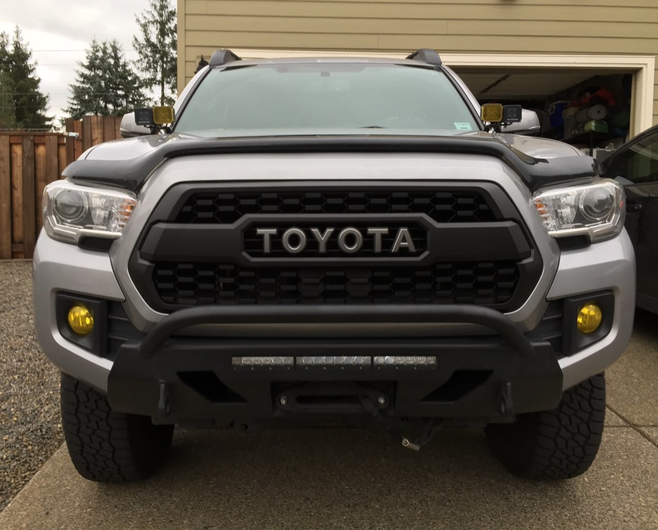

    Yeah as soon as I drop a winch in there I’m going to have to adjust the preload. Glad I went with 700lb springs over the 650’s.

    Definitly. It rides great with this and 700# springs for me. Total bumper and winch weight is around 130lbs

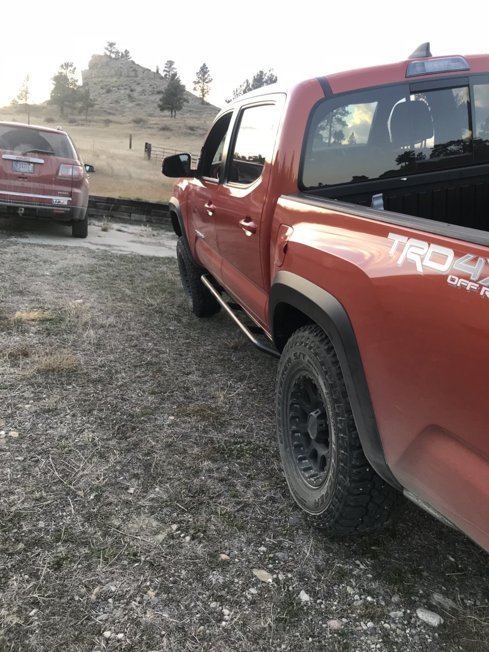

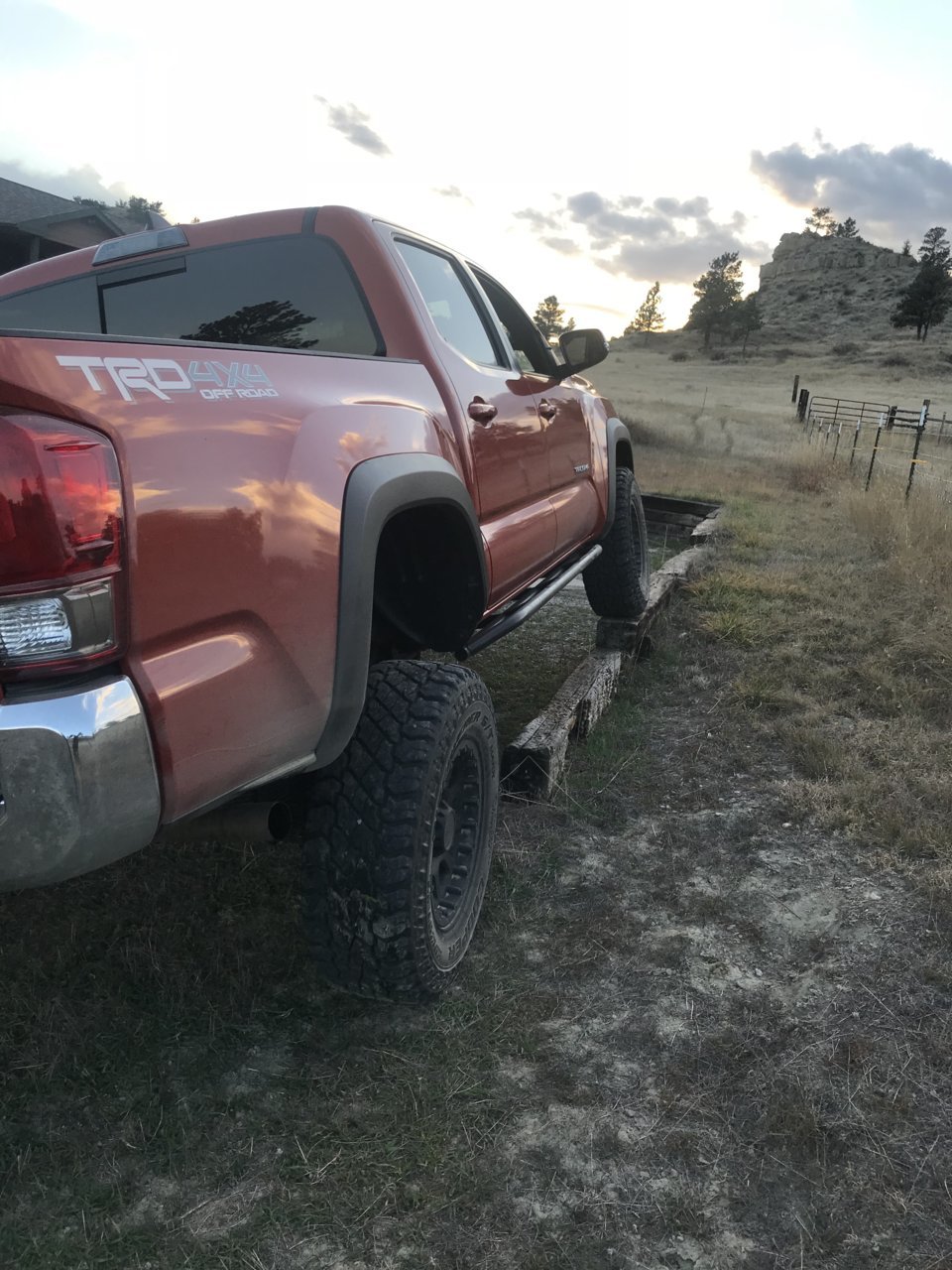

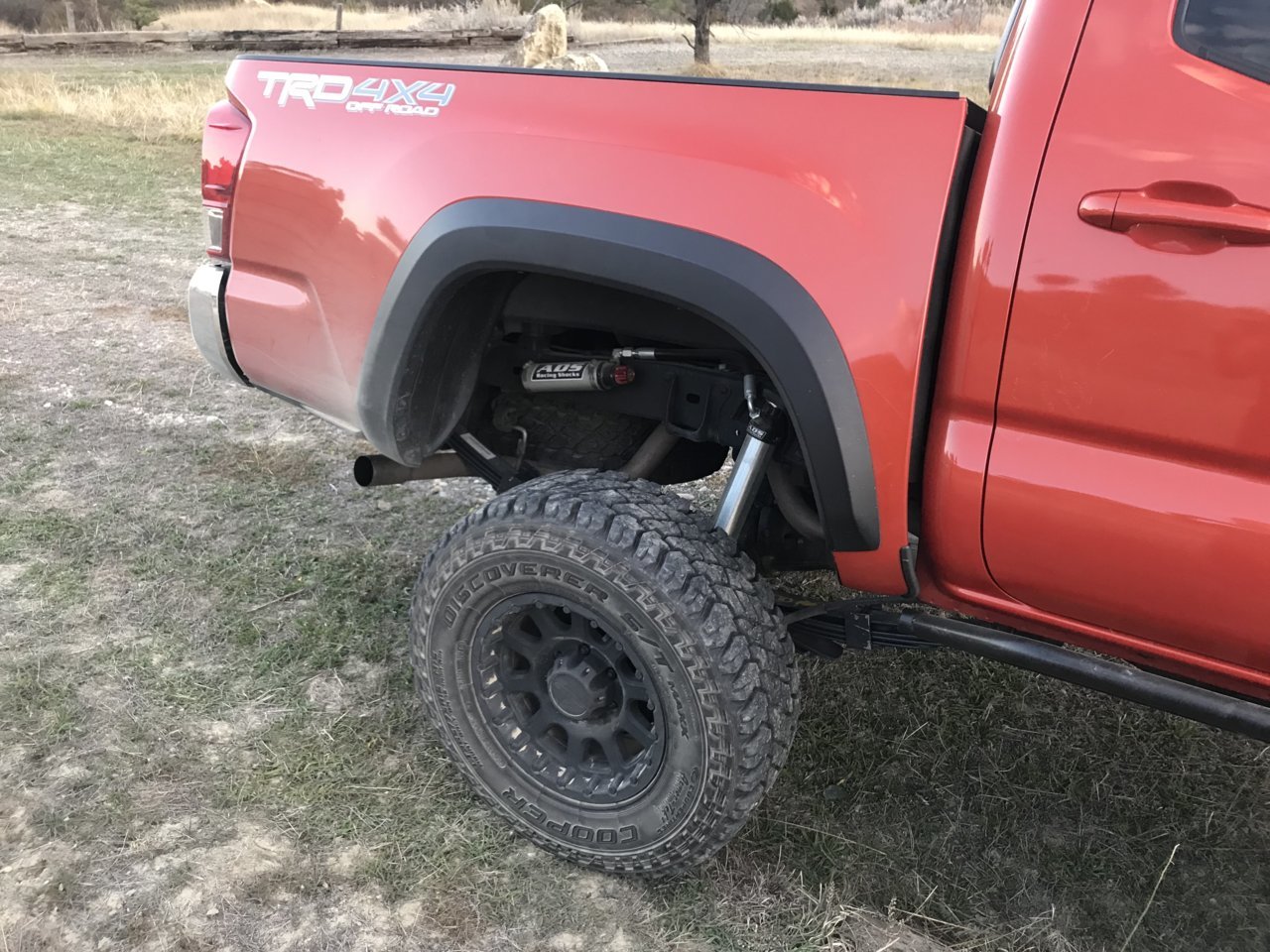

    A few pictures of the flex I am able to get, if I had one more railroad tie I’m sure I could go up that without my rear coming off of the ground. It is 10X better then my old shocks that I bottomed out my driver side on and it started leaking fluid.

    Hell yah! I’m definitly getting those next. How many leafs total do you have? I’m running a 6-leaf Dakar (use to be the HD 7-pack)

    I am running the full HD pack and it doesn’t feel bad at the moment so I’ll probably keep it at 7. How much better is temovong one leaf? I don’t have anything in the rear at the moment and it won’t be for a while since purchasing these was such kick in the pants haha

    The HD pack was awesome when I ran a bed rack and a lot of weight, but since I went to a soft canopy that weighs like 20lbs it was a little jarring. The 6-leaf pack still holds 500lbs effortlessly with little sag. I like the ride better (a little more cushy), but if I still ran weight I wouldn’t have taken the third leaf down from the top out. Good to see you are getting that much flex with the full pack!
    Believe it or not when I had the full HD pack I put 1000lbs (25 forty pound bags) of bark chips back there and it drove great with .75” sag

    I’ll have to think about taking the third leaf out, I have shins coming my way so taking one leaf out wouldn’t add much more time to that install. I’m gonna go back to the obstacle that over flexed my other shock and see how these ones do. I also have my sway bar removed so I want to see how much that increase my flex.
