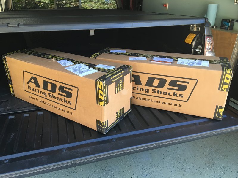

    soon i can haz.

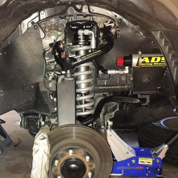

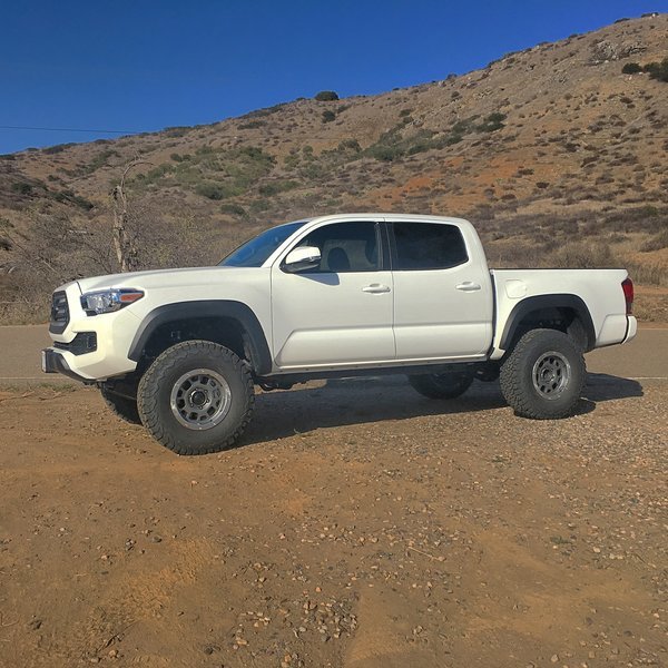

    I installed the suspension over the weekend and got it aligned earlier this week. Really happy with how it turned out! Going to hit the desert next weekend to break it in. Very impressed with the performance so far, especially the rear end. Very smooth! The only thing I can complain about is the noise from the bypasses. Sounds like there are a few rocks bouncing around in the bed. I knew they would make some noise though. It's worth the minor annoyance seeing how well they perform. I will post more pics soon and let you know how it does off road.

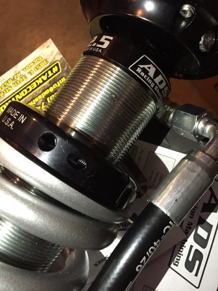

    Anyone else notice a carved L into one coilover or am I making something out of nothing.

    Where ya looking?
    Wait I think I see it. On the coil collar part?

    yes, it looks deeper and wider in person, hard to capture it in a photo.
    inbetween the two holes on the collar

    looks incidental to me, probably when wrenching in all that preload

    I don't have anything on mine

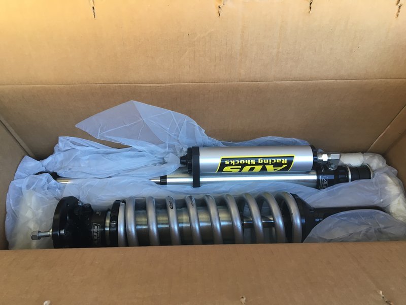

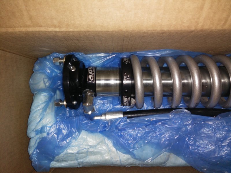

    That's a shit ton of pre load. Did you use a wall mounted spring compressor to get the spring nut down that far? How much lift are you getting? From ADS mine gave me 1.25" of lift. Cranked them up to 2.5". Settled to 1.75" of lift. I need to crank them back up, but I can't budge them anymore. Tried a 2 foot cheater bar, and they just won't turn. I'm going to wait for my bumper to be mounted up then pull them out, and use a wall mount compressor to hopefully achieve desired lift.

    That's about how much I have it came that way, was about equal with how much lift my OME gave me.
