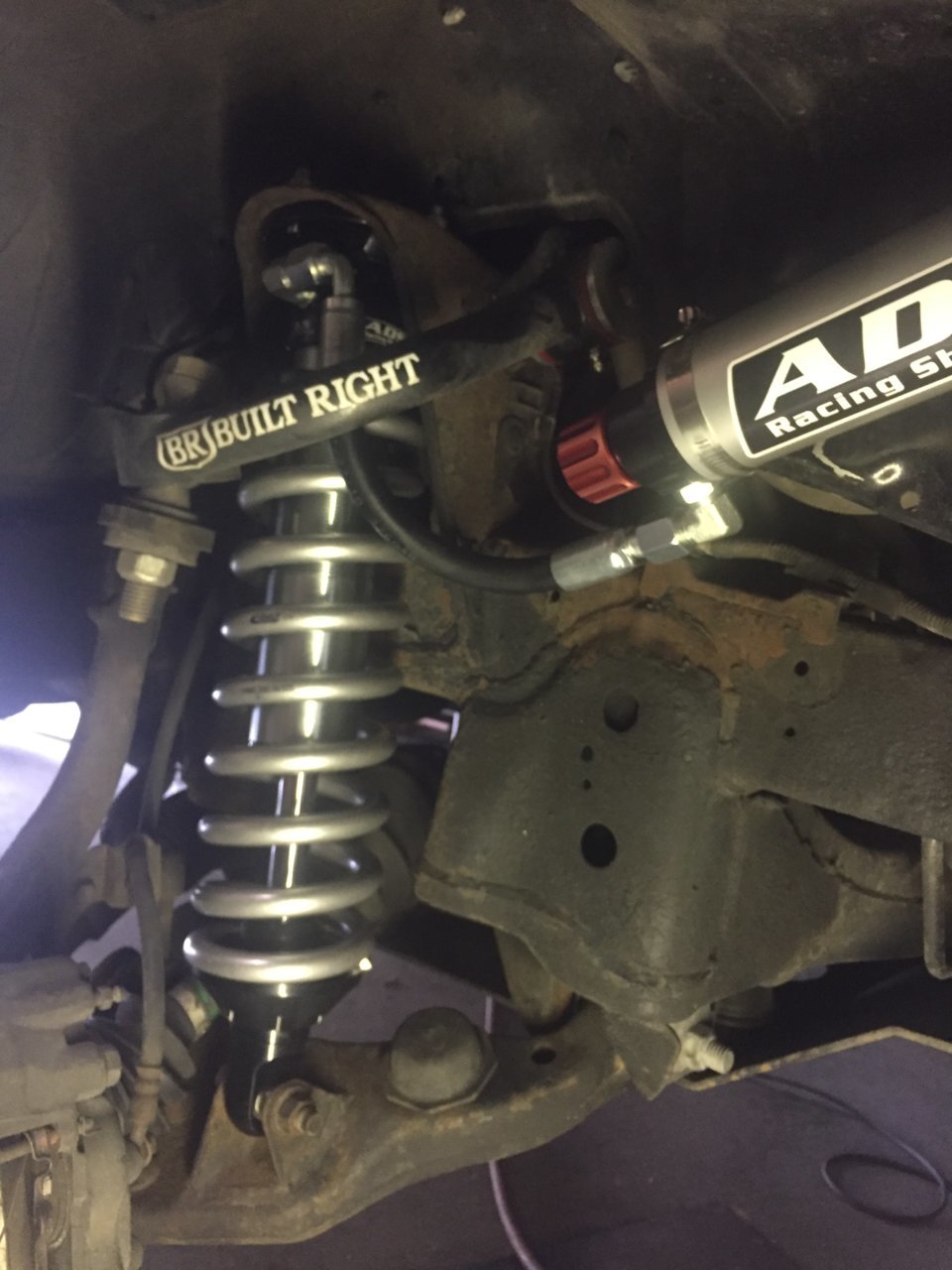

    Just ordered a set of ADS coilovers from Headstrong Offroad. Definitely looking forward to installing them. This forum has been the most helpful in making my final decision between these and Kings. Will post pictures once they're in.

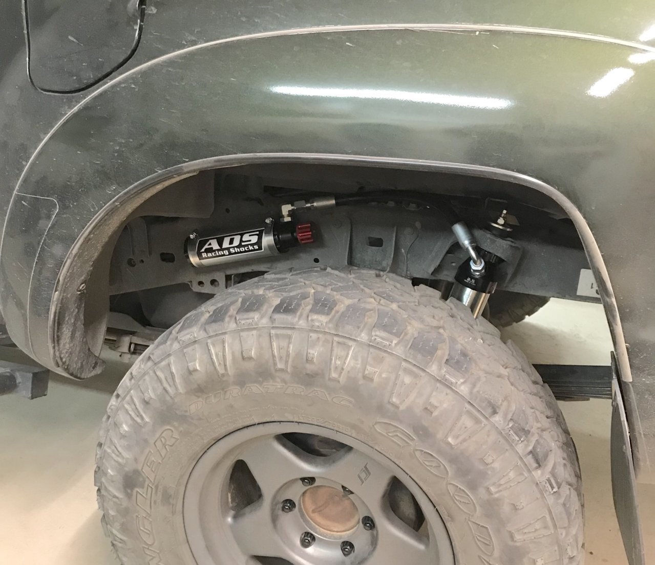

    Coilovers are installed and are a night and day difference from the Bilstein 5100s I had. Went from the 620 lb Eibach springs to these with the 700 lb springs. The truck handles so much better with the proper spring rate. Only complaint I have is that the Allen bolt that locks the adjustment ring was positioned directly behind the reservoir hose fitting making it impossible to fit a hex key in to without some work from my angle grinder. I cut the hex key down and was able to jimmy it in. Once I was able to gain access to the Allen bolt, adjustment was fairly easy given enough spray lubricant was applied to the shock body.
    As many of you know from past experience, @HeadStrong Off-Road is a top notch company. Ordered these coilovers last week and received them on Wednesday the following week. Will definitely be ordering through them when it’s time to rework the rear end of my truck.

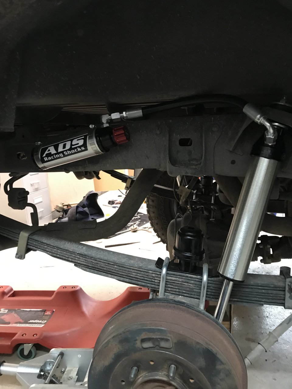

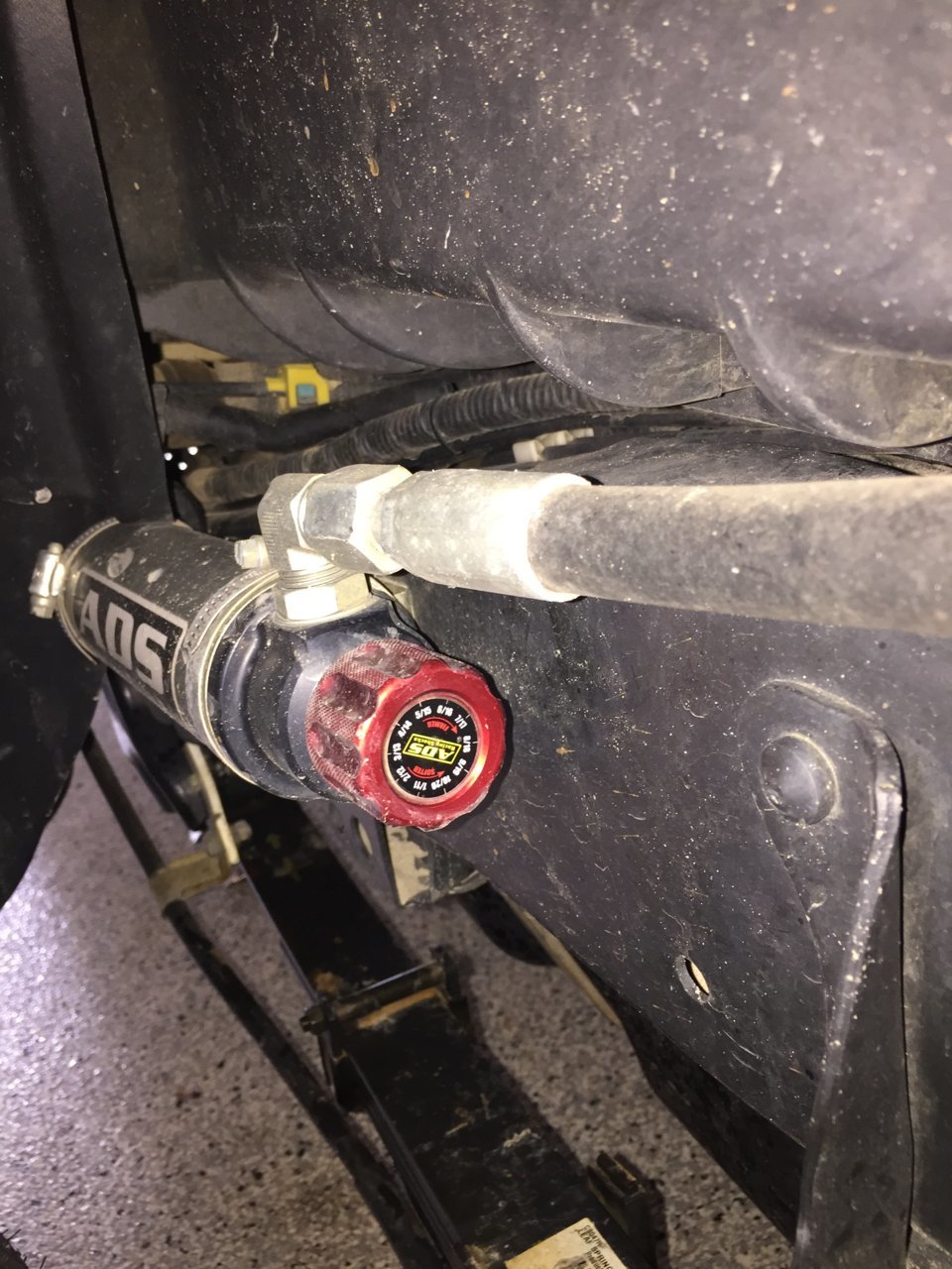

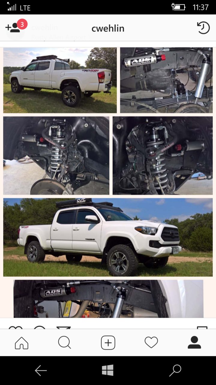

    Anyone got any pics of their rear resi shocks mounted?
    Here is where I mounted my brackets because it seemed like that was how the hose wanted to lay.......trying any other configuration was met with a lot of resistance because the hoses are so tough and I didn’t want to put any stress or torque on the fittings.
    Passenger side
    Driver side
    Any thoughts? Where I have the hose shouldn’t be pinched by the bed or if it does some major mounts and support structure have given way even with frame flex I would think?

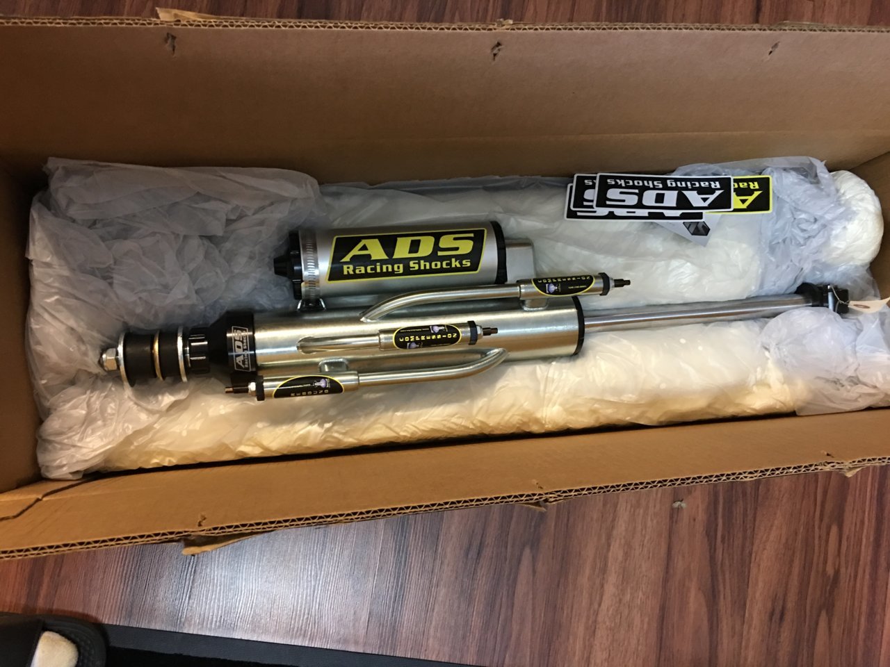

    Picked these up in person today! Thank you once again Marie and Robert! Always showing love when it comes to customer service and etc! @HeadStrong Off-Road is the way to go no matter what.
