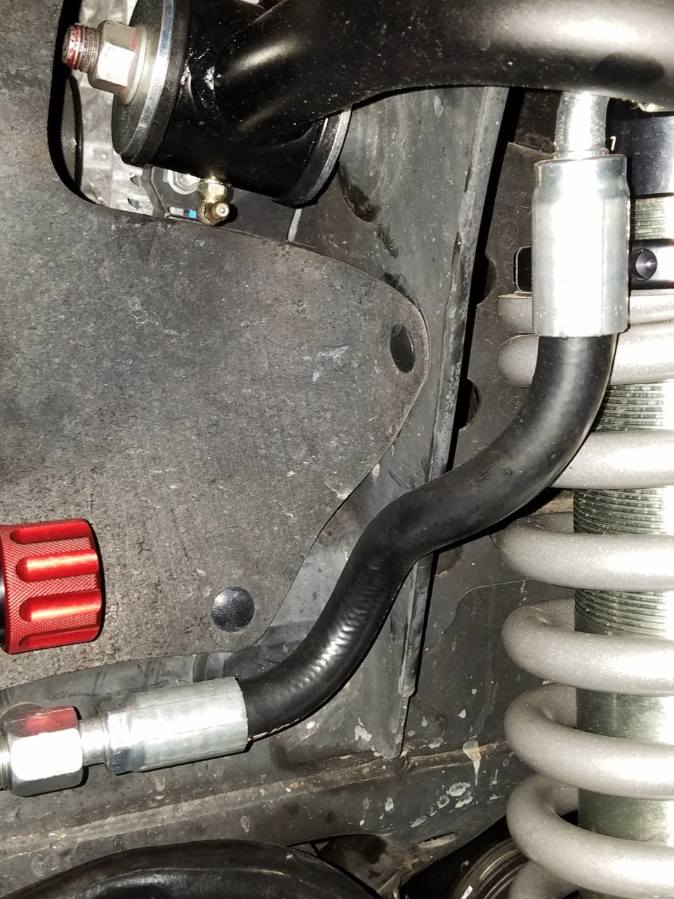

    This is exactly what I did to keep mine from looking like yours. I'll see if I have a picture to post, if not I'll take one when I get home tonight.
    Edit: Here's a picture....not the greatest but you'll get the idea.IMG_4969.jpg

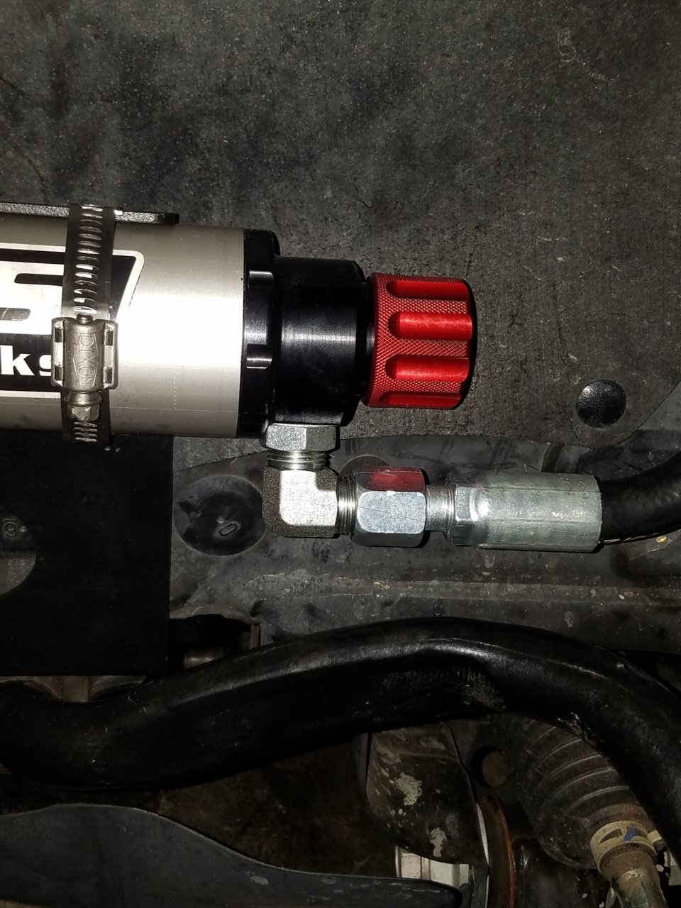

    Here is the best I could do on my driver side.
    I just can't get the smooth looping in your pic.
    I think one difference is that the hose just doesn't attach to my reservoir at the same angle as yours:

    You have to loosen the nut slightly at the reservoir and turn it. Mine came the same way as your picture and we ran into the same problem you're having. You don't have to loosen it very much to move it to where you need it.

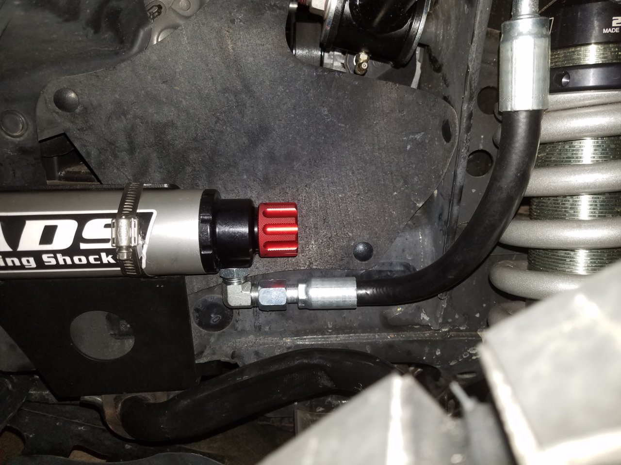

    So, I contacted ADS today and it was interesting. I called them and their support person said the "S" shape was fine, but suggested I write them. I did and the person that responded to that told me that it wasn't-it would could cause internal binding or something like that over time-and that my hose wasn't attached to my reservoir quite correctly.
    I'm not going to lie: I am kind of annoyed by that. They should ship correctly and, barring that, there should have been some kind of directions addressing this (there were no instructions whatsoever with the shocks). But anyway, we made an adjustment and here it is:
