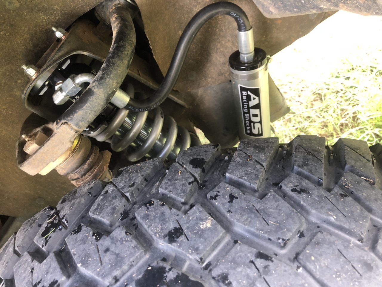

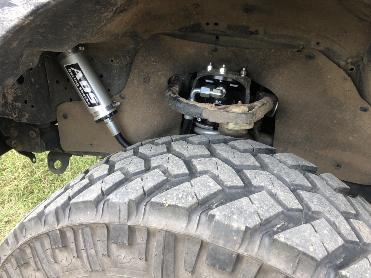

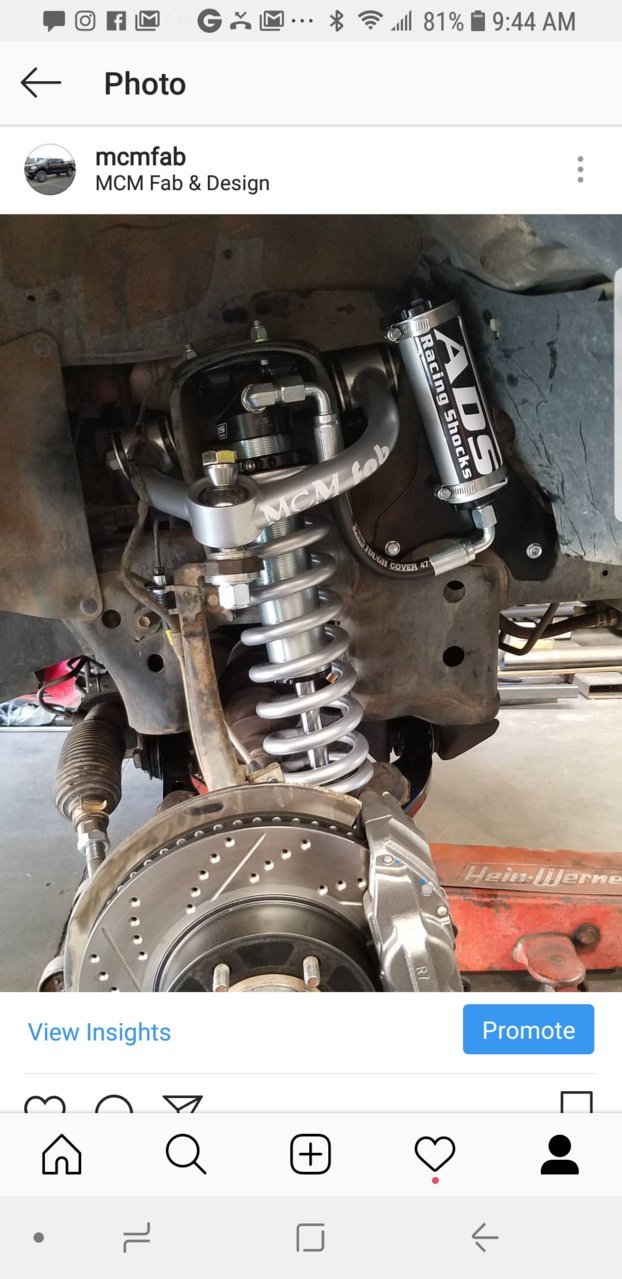

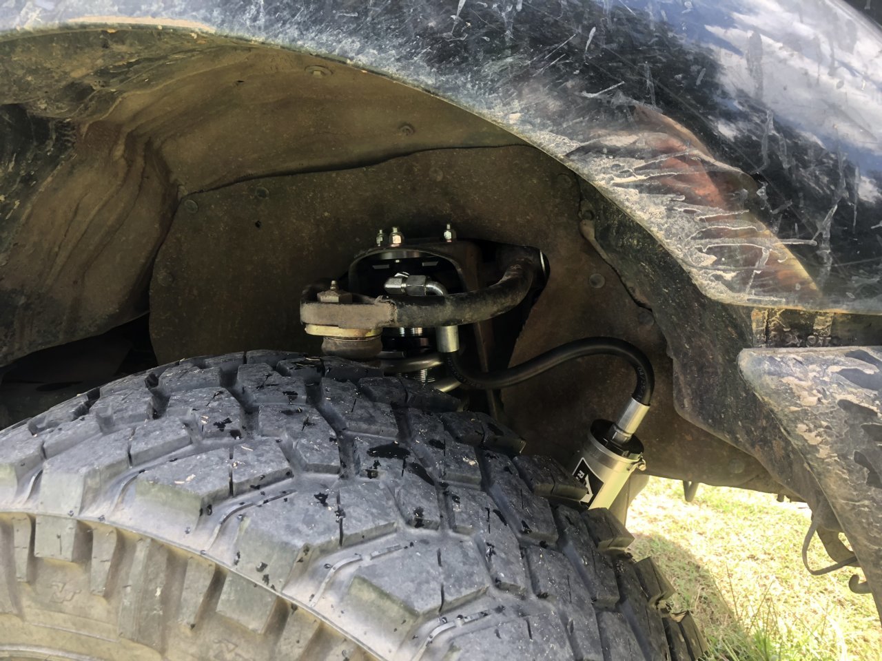

    First gen guys, how did you end up mounting your resi? The first picture is how I mounted the drivers side. It clears, but the tire will rub the hose at full lock, especially hitting a bump. Second and third pictures is the passenger side, and it’s no where close to working. I’m having to be careful turning to the left at to not to hit it. I tried to mount it like the fourth picture, so I swapped coils around so that the fittings would line up right, but with my LR UCAs, I felt the arm came too close to the hose and fitting for it to work. I got the picture from this thread, I can’t remeber who’s truck it is...

    I order them differently for the 1st gens. I made these brackets last year for the 1st Gen Tacoma/3rd Gen 4 runner.
    The way yours are, the resi was meant to attach to the frame, sometimes they have clearance issues though based on the wheel offset and tire size.

    How did you do the passenger side? My washer resivour cover is in the way to mount this way

    Same way. Get a new washer fluid reservoir that fits under the hood. If you have larger than stock tires, you're probably rubbing the washer fluid reservoir anyways.
