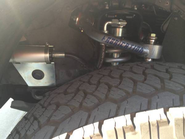

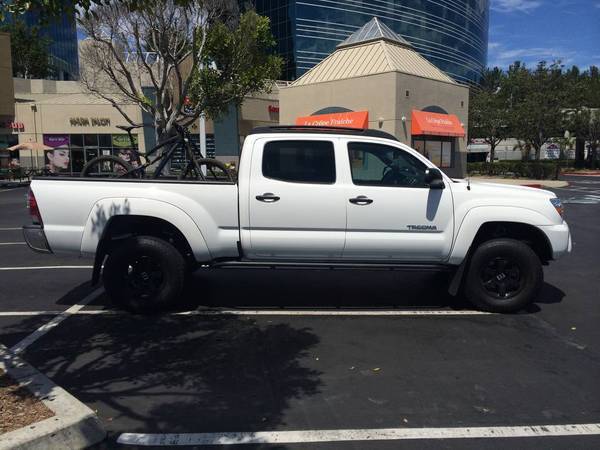

    Here is my setup. Went with the RR 2.5 shocks. Couldn't be more pleased.

    It looks great! You could be more pleased:confused:. Do explain!

    *Couldn't haha sorry. This setup is great and for the price I couldn't beat it.

    gotcha! It's a great company and their product is fantastic! I maybe should have gone RR in the fronts but I don't have money hahaha

    They look great! Top notch build quality from what I can see. You definitely should consider some RR's in the future though to keep them cooler if you want to wheel hard.
    The # spring will not raise you up at all, it's all dependent on the overall spring length. For example, going a 14" spring from a 13" will require you not having to wrench down on the adjuster so much when it comes time to lift the truck. Saving you some preload, and also threading on the shock body. Whatever you do, keep the lift under 3 inches or your axle CV boots angles will be all jacked up.
    They appear to be a very well built shock. I almost went that route, but I ended up going SAW/Fox combo setup.
