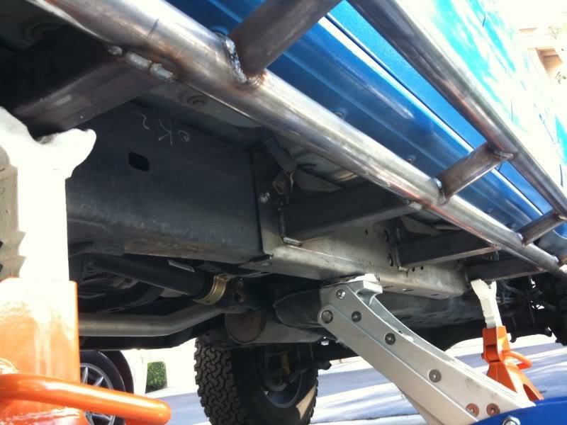

  10. May 6, 2011 at 6:57 AM
    RZRob
    RZRob Well-Known Member
    Dec 9, 2009
    #27315
    817
    Robert
    Anaheim Hills
    This is ridiculously inaccurate information. While I went with Bolt-on, they need to be bolted in locations where it counts.
    RZ Rob
    Exhibit A:
  11. May 6, 2011 at 7:02 AM
    JLink
    JLink Well-Known Member
    May 9, 2010
    #36795
    12,582
    Josh
    Ocean, NJ
    Lifted, Locked, Armored. Ready To Wheel.
    Lol.. I was thinking that sounds familiar.. Then I remembered I wheeled with you at RC. Those sliders look good.
    I ordered a set of Demello hybrid bolt ons. Even though they are pricey, I like the ability to take them off easily and re sell them if I decide too.
