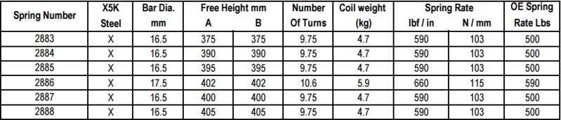

    Okay what is the best ome spring to pair with the 5100s for just under 3 inches of lift settled? 888 or 887? I hear conflicting ride heights with these and I hear add a leafs ride even stiffer than blocks ??

    I would go 2885 or 2887's. They are the same spring rate just different lengths. You can go 2885's and get 2" lift. 2887's - 2.85" lift. You can cheat and use 2885's and put it on the clip just above the stock clip and get around 2.65" of lift.

    This information is 100% correct for the 2nd Gen Tacomas. Unfortunately it is incorrect for 3rd Gen tacomas, and the person you were answering to has a 3rd Gen. The lift springs OME provides give .5" to 1.25" less lift on a 3rd Gen compared to 2nd gen. Although I haven't seen this first hand, I have heard a few conflicting reports on the matter.

    That's what I hear so unsure on lift the 888 achieves on my 3rd gen double cab long bed 4x4

    From what I hear, those 888 springs get the truck higher than the 887 springs.
