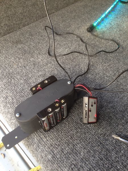

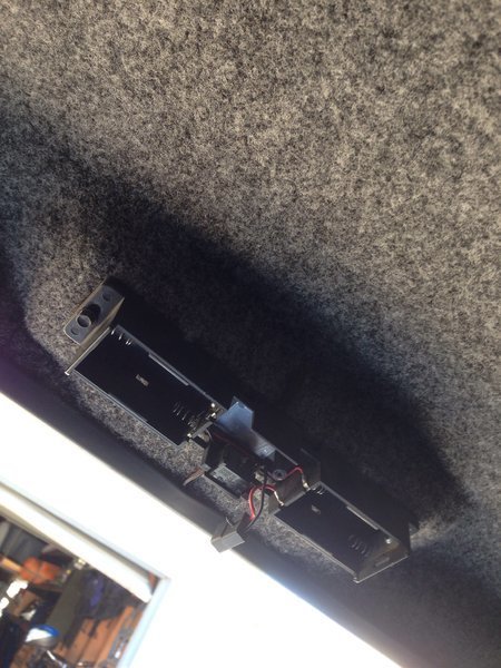

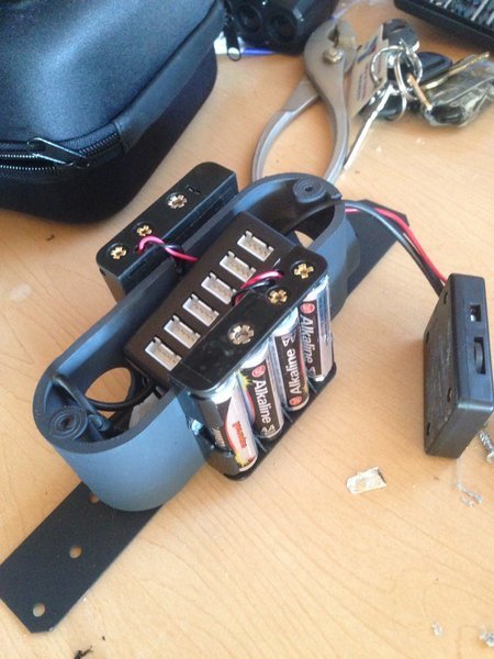

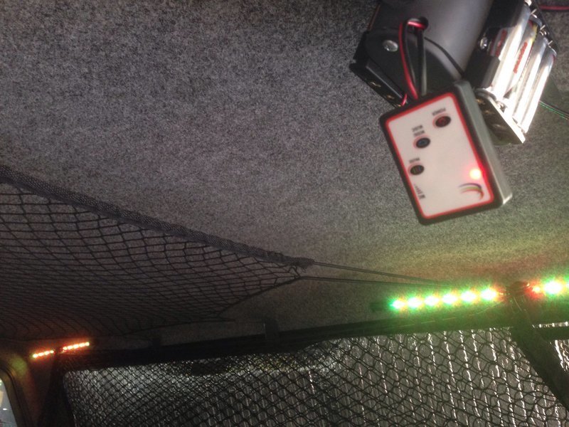

    Well installed LED lights! Bigger project than what I thought!
    I was just going to wire up my lights to the stock single bulb thing. However, my LEDs are for 12 v and 4 AA only makes 6 v.
    So bought 2 4-celled AA battery holders and wired them up to the LED control box. I needed a way to hid all the wiring from all the cords to my LED bars so I bought a 1 inch conduit box to store it all. Cut the ends off where the tubing is and spray painted it black. Also bought a metal bar thing that fit perfectly the length between the screw holes in the camper. I attached the box to the metal
    Installed!
    May have to put the box on an angle bracket so you don't tap your head on it coming into the bed. Only sticks out a little more than the old one but just enough you might bonk your head. Or just spray paint one side bright orange

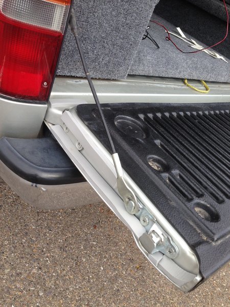

    how did you weather proof the gaps in the tailgate?

    Went to home depot and found some thick weather stripping! Don't know the exact size but I think it was medium width and thick. I can see if I can find the package

    If that method doesn't work out there are tailgate seals that may work a little better; I tried the flat foam like you have and ended up switching to the seal. I honestly haven't found anything that works great though.
    I'd also say you need to have someone slide around under your truck with a bright light while you are in the empty bed and look for light leaks then seal them. The cubbies all need some help as do the seams in the composite bed where they overlap. Make sure that your shell doesn't have gaps at the corners where the rear glass is. On my last Tacoma I ended up gluing some ruber flaps in the opening for the rear door to seal against and that helped. Not really a problem on the east coast but when I was out west that fine dust would get in. I put my clothes and bedding in bags when out west.

    good tips! Cept I don't have composite beds so don't have to worry bout that! I do have two drain holes at the front of the bed where I should fill.
    I'll look into those tail gate seals and flaps as well as I can still see gaps with the weather stripping.
