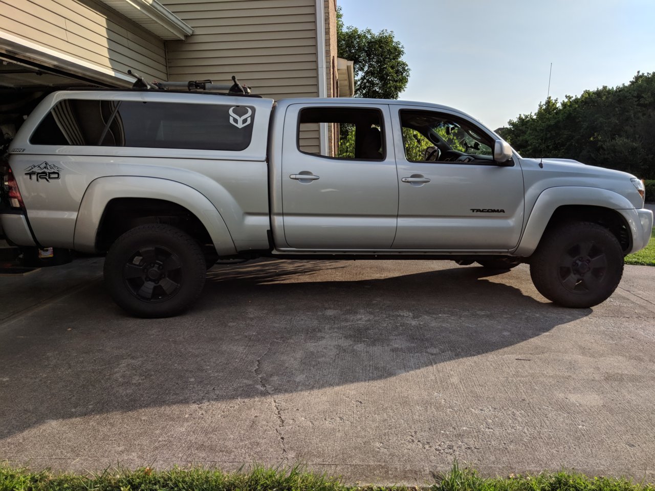

    Picture of my Outback I use now and our teardrop camper. The plan is to use the truck for our weekend adventures and the OB is my everyday car

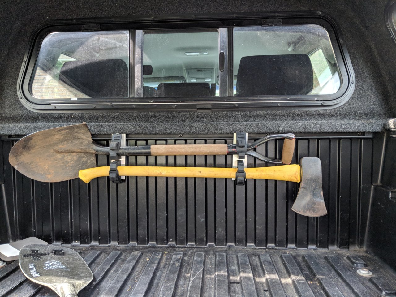

    Made some mounts for a shovel and ax. Some Amazon t nuts and flat stock worked great for mounts. Have to say I love having the track built in to the bed. Makes mounting some much easier!

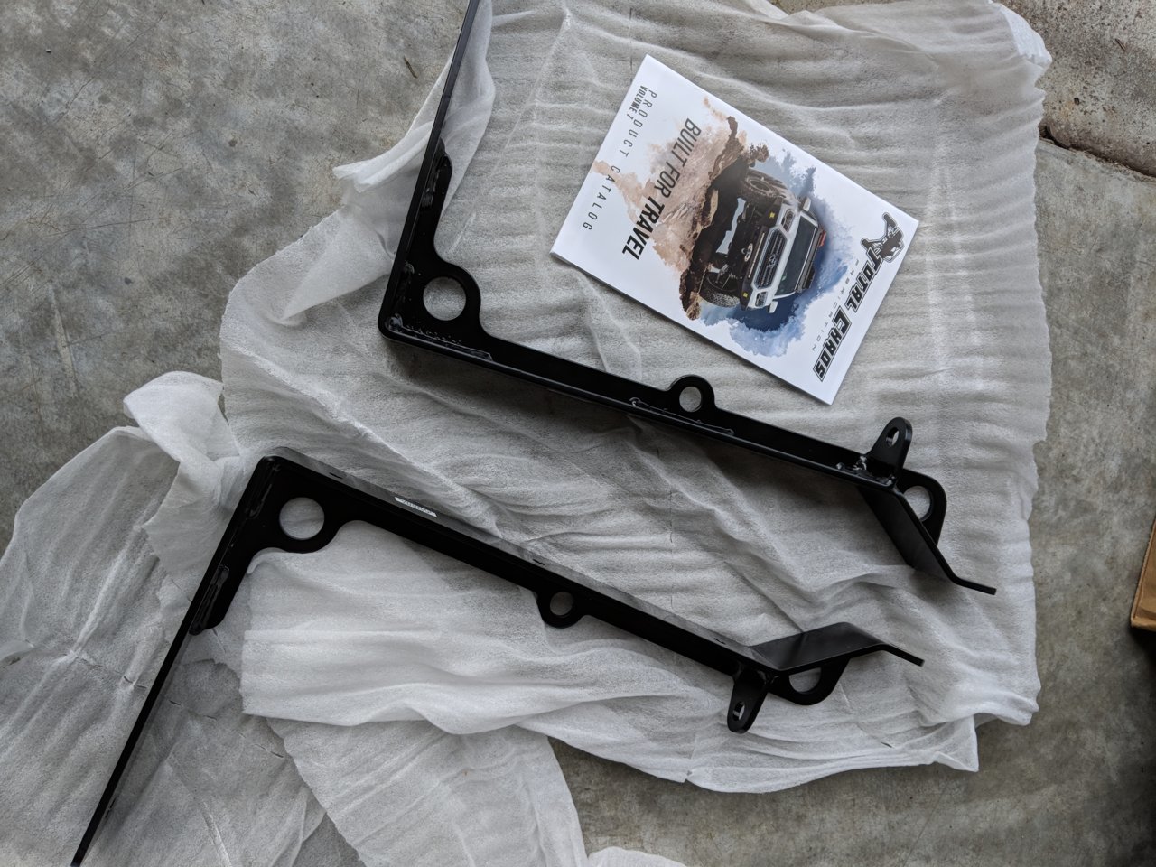

    Knoxville TN

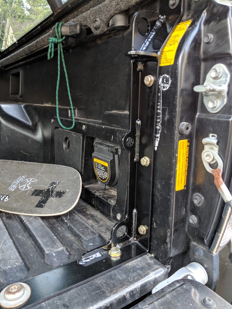

    After reading on here about the beds flexing under weight I went ahead an ordered a set of bed stiffeners from Total Chaos. Install was very easy and straight forward. The brackets pulled my bed in 1/16" on each side. Not much but better safe than sorry later on

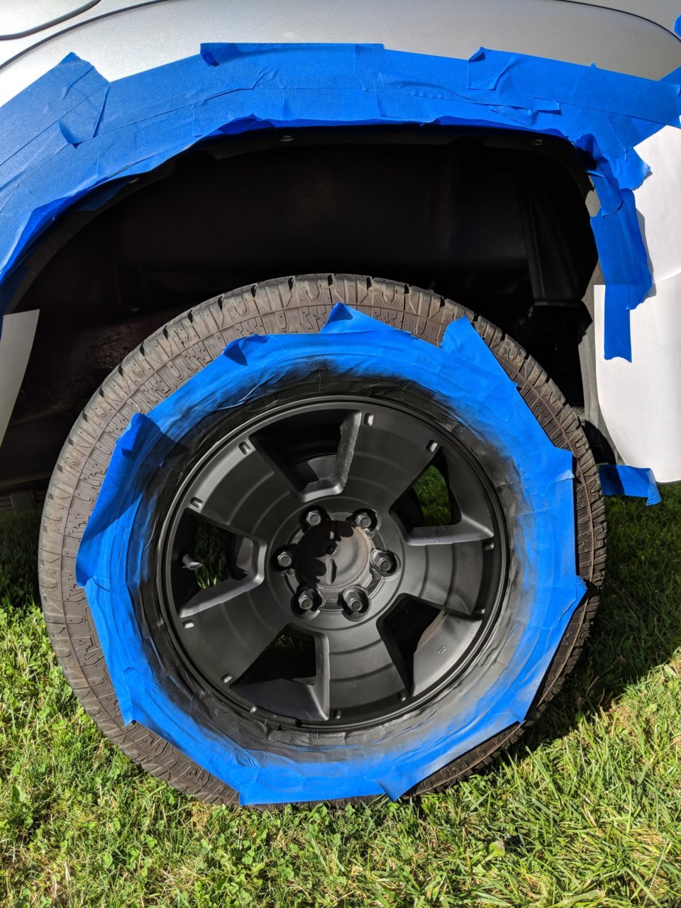

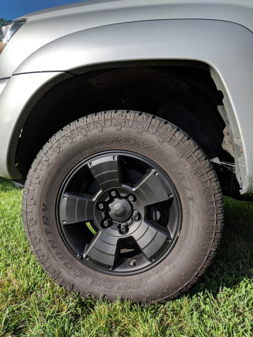

    When I bought the truck the wheels were in bad shape. The silver was peeling and they looked bad. Once I need to replace the tires I am going to replace the wheels but until them I figured I would pain them. Ended up chipping all the coating off I could with a scrapper, then sanded the wheels. Wash and dry and them multiple coats of flat black paint/primer. I think for a 6 dollar fix they turned out pretty well. Time will tell how long they last!

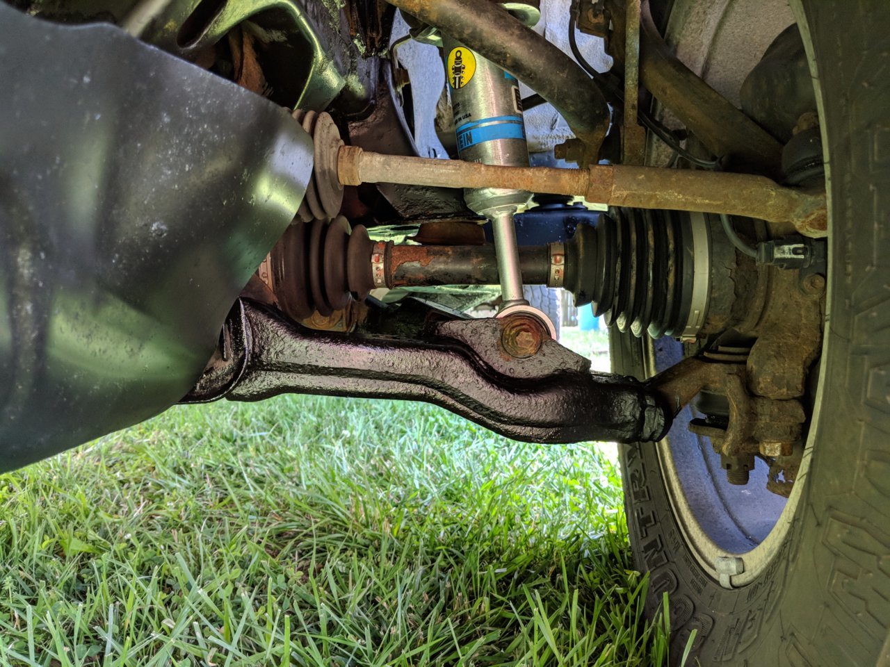

    I had new shocks installed on the truck, Blistien 5100's front and rear. I set the front on the second ring from the bottom (about 1" of lift) but with the old leaf pack and the weight of the shell I got the bro lean. So after talking to @Headstrong I ordered their Off-Road 3 leaf AAL package to compensate for the weight of the shell and gear that gets loaded. The AAL should arrive next week and hope to get it installed soon after. This should put my stance back to about 1" higher in the rear and the front until loaded down.

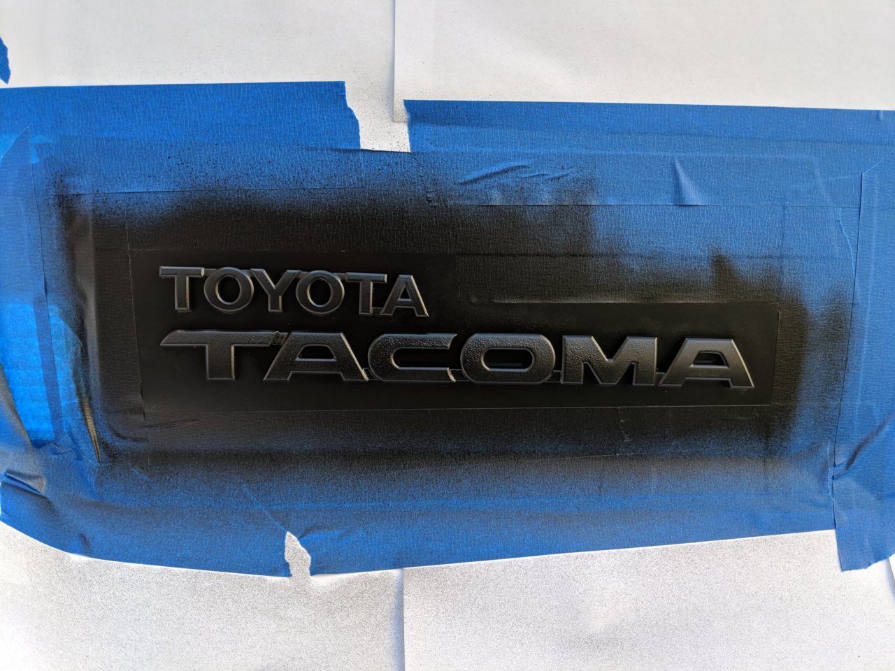

    Knoxville TN

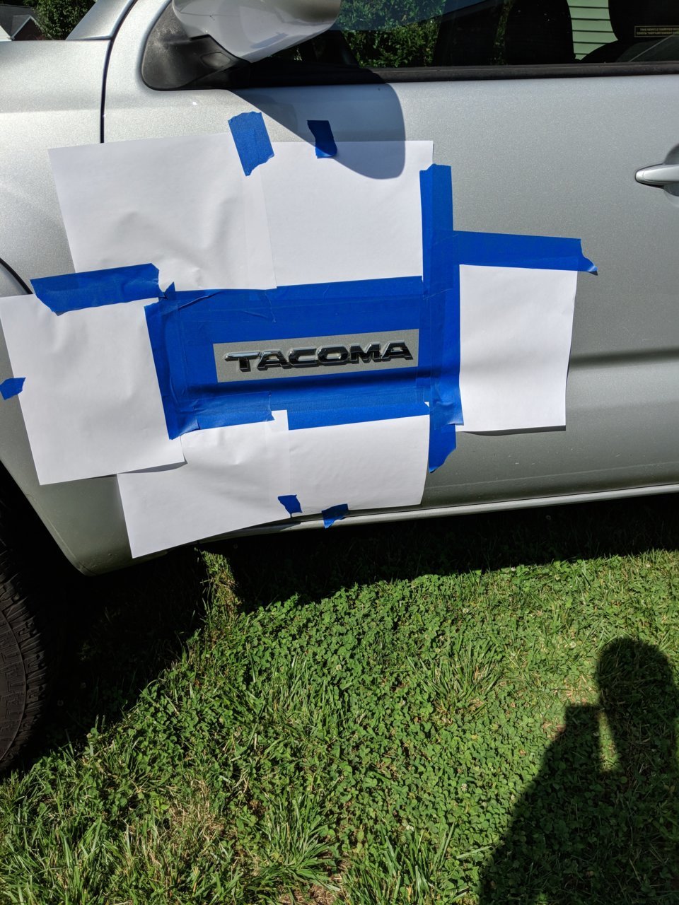

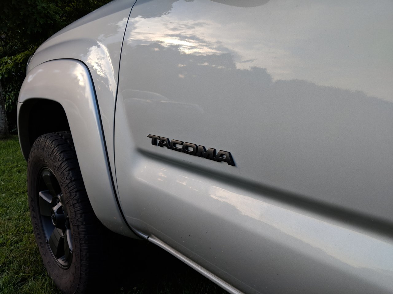

    After painting my wheels black the chrome emblems didn't match the theme of the truck. I decided to try plastic dip...never used the stuff. I clean the emblems, masked off around the area and applied 4 coats. I waited 30 minutes between each coat. The plastic dip seemed to work pretty well. Not sure how long it will last but it was easy enough to do

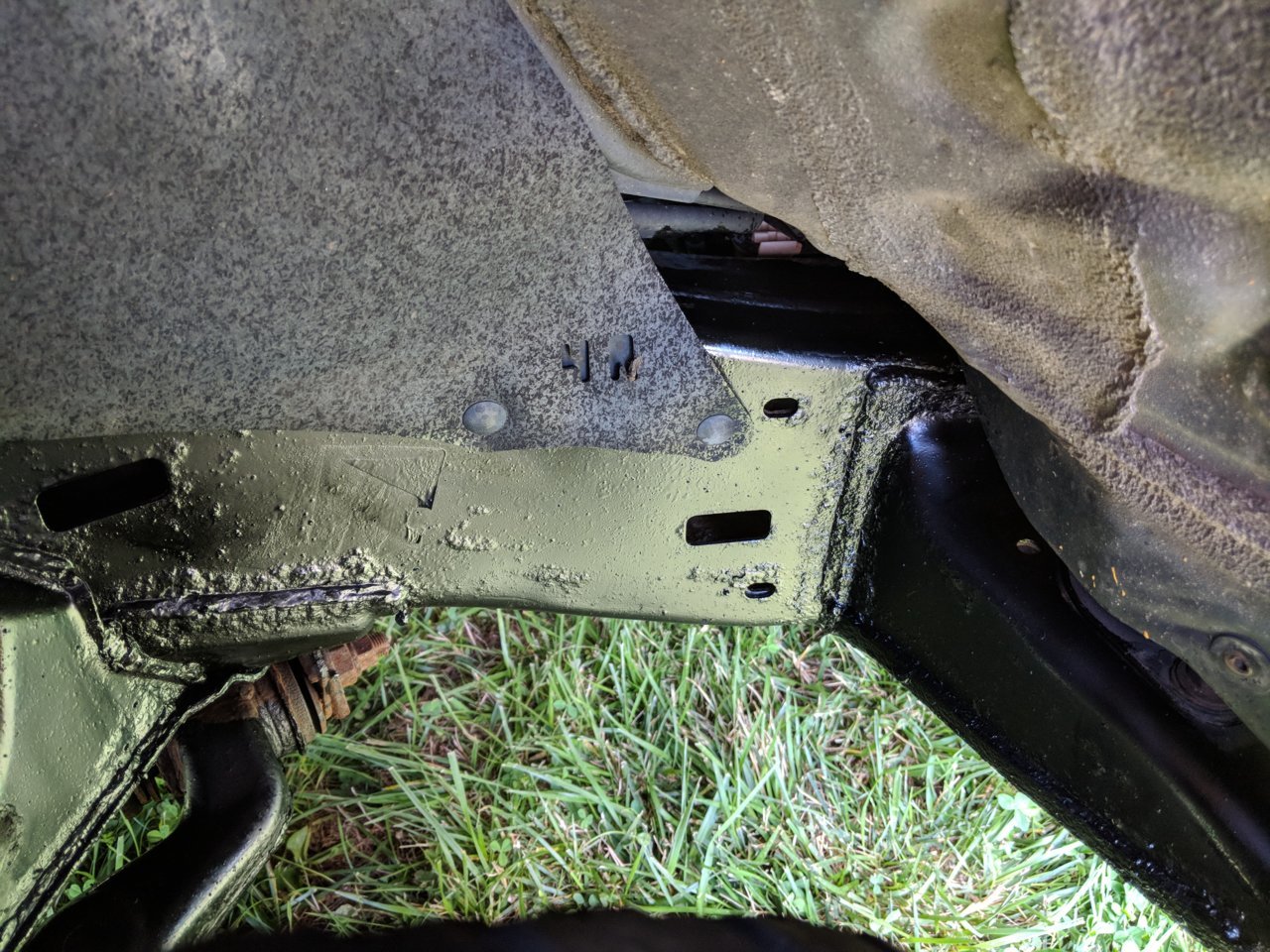

    Knoxville TN

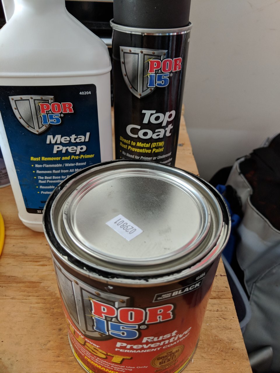

    Ive owned my Tacoma for about a month and first thing I noticed was the rust on the frame. After taking the truck to the dealer and having the frame inspected (it passed) i wanted to paint/coat the frame. Lots of reading on TW and it sounded like POR15 was the best solution for what I wanted. So after about 3 days of work I finished my frame. I am very happy with how it turned out. Clean loose rust off frame, use metal prep, 1" foam brush for the POR15, then use the top coat to cover any areas that will see direct sun light. I just hope it last for a long time!

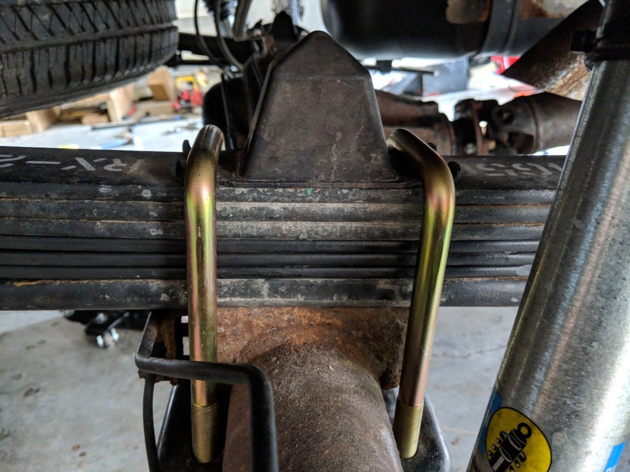

    My @HeadStrong Off-Road 3 leaf AAL arrived today and I got it installed with no issues. I'll post pictures soon. But first impressions are I got about 2" of lift (I left the over load in). Ride seemed firm and so far no vibration. I'll drive the interstate tomorrow and see if any new vibrations show up at higher speeds. Can't wait to load the truck with gear and see how she preforms

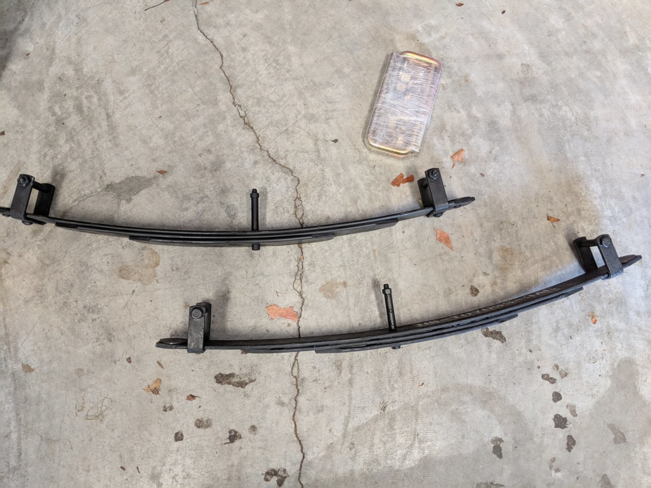

    Drove the truck to work today, 30 minutes of highway speeds and not a single vibration! Didnt have to lower the bearing or add shims to the axle!! Here are some pictures i took during the install
    Headstrong 3 Leaf AAL right out of the box. I got the kit that came with new U bolts.

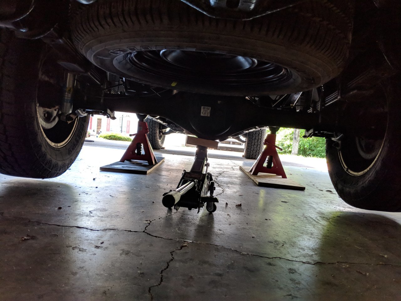

    Knoxville TN
    Jacked up the rear of the truck, set her on stands, then used the flow jack to move the axle around. No issues getting it all back together. You can see the new leafs are much thinner than the OEM leafs. I have a total of 7 leafs counting the overload

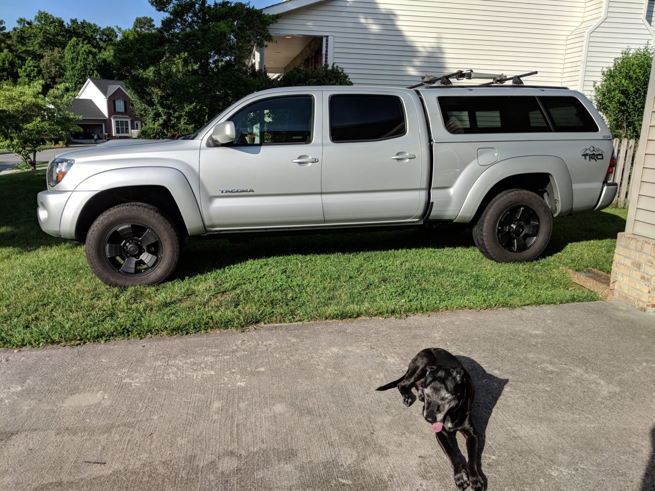

    Got the rake back I was looking for (rear a bit higher than the front). Picture is with no weight in the bed (just the camper shell). Once I add camping gear and kayaks I think the truck will sit about level. Very happy with out this turned out!

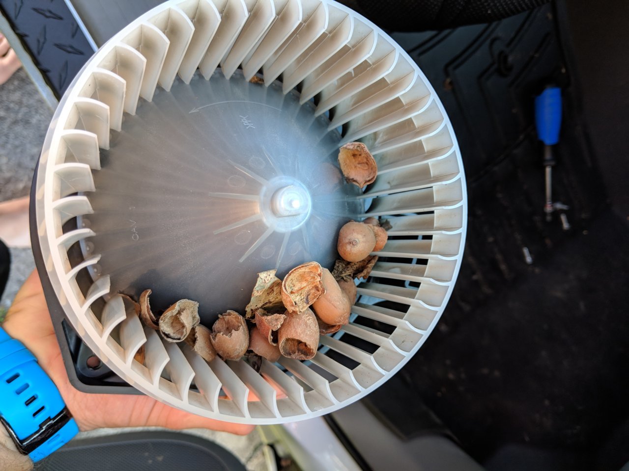

    Knoxville TN
    Had time today to remove the blower fan for the AC. It had been making some noise when turned up past the second notch. You can see why after I dropped the fan lol. Just a few nuts in it!
