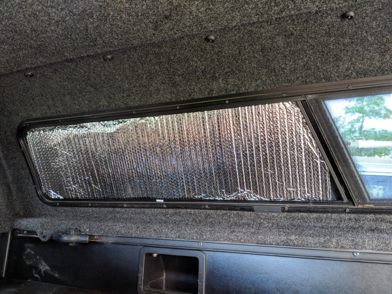

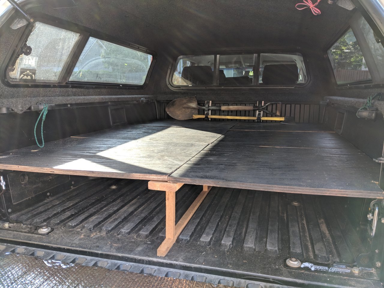

    Working on the camping space in the Taco last night. Built an easy to remove sleeping platform and got some insulation cut to fit in the windows to keep the light out. Also ordered some Velcro cargo netting I am going to try placing on the roof of the shell for small storage items. Should be delivered friday so I can test them out
    MarX and Juforrest like this.

    Tested out the sleeping platform this weekend while traveling to WV for a race. Platform worked perfect. Wife was happy...so everyone else was happy! Plus came in 2nd in my event which made the trip that much better!
    MarX likes this.

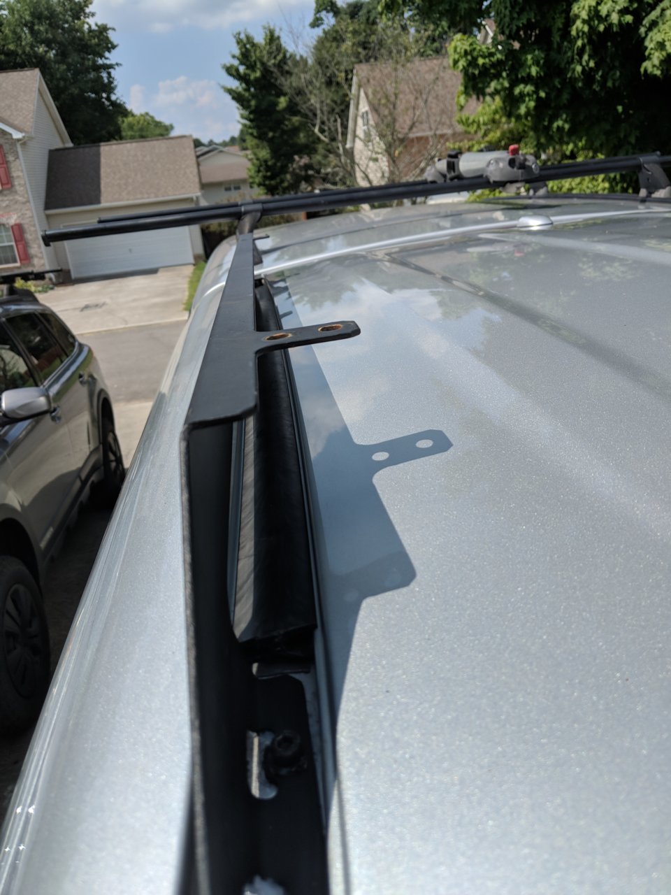

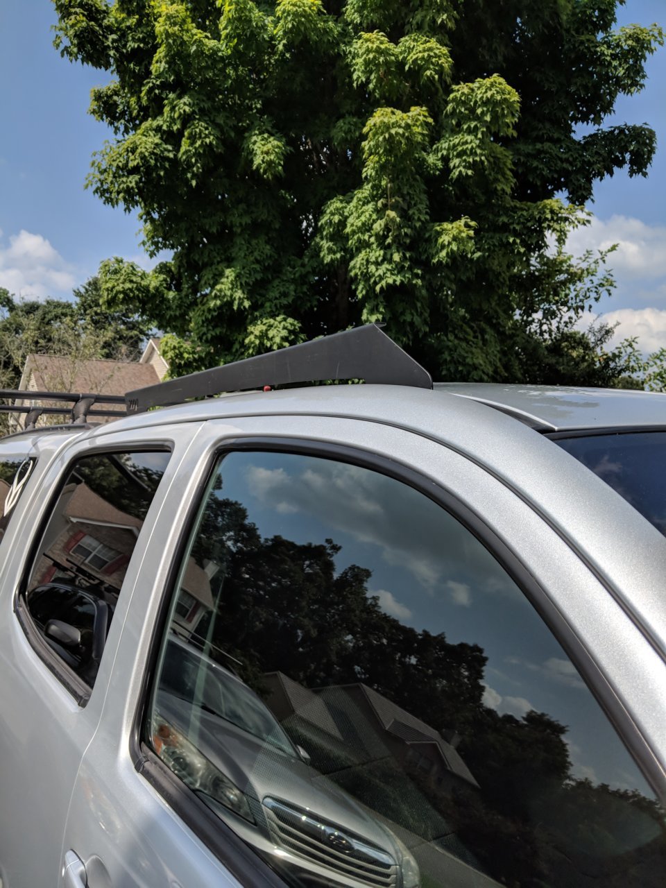

    Got a great deal on a warrior products roof rack platform. Picked it up yesterday and got the side rails installed today. Just waiting on some paint to dry on the top rack before I put it on.
    MarX likes this.

    Paint dried and rack install is finished. The platform feels very sturdy and looks great! Cant wait for our trip out to CO next month!!
    MarX and Casper66 like this.

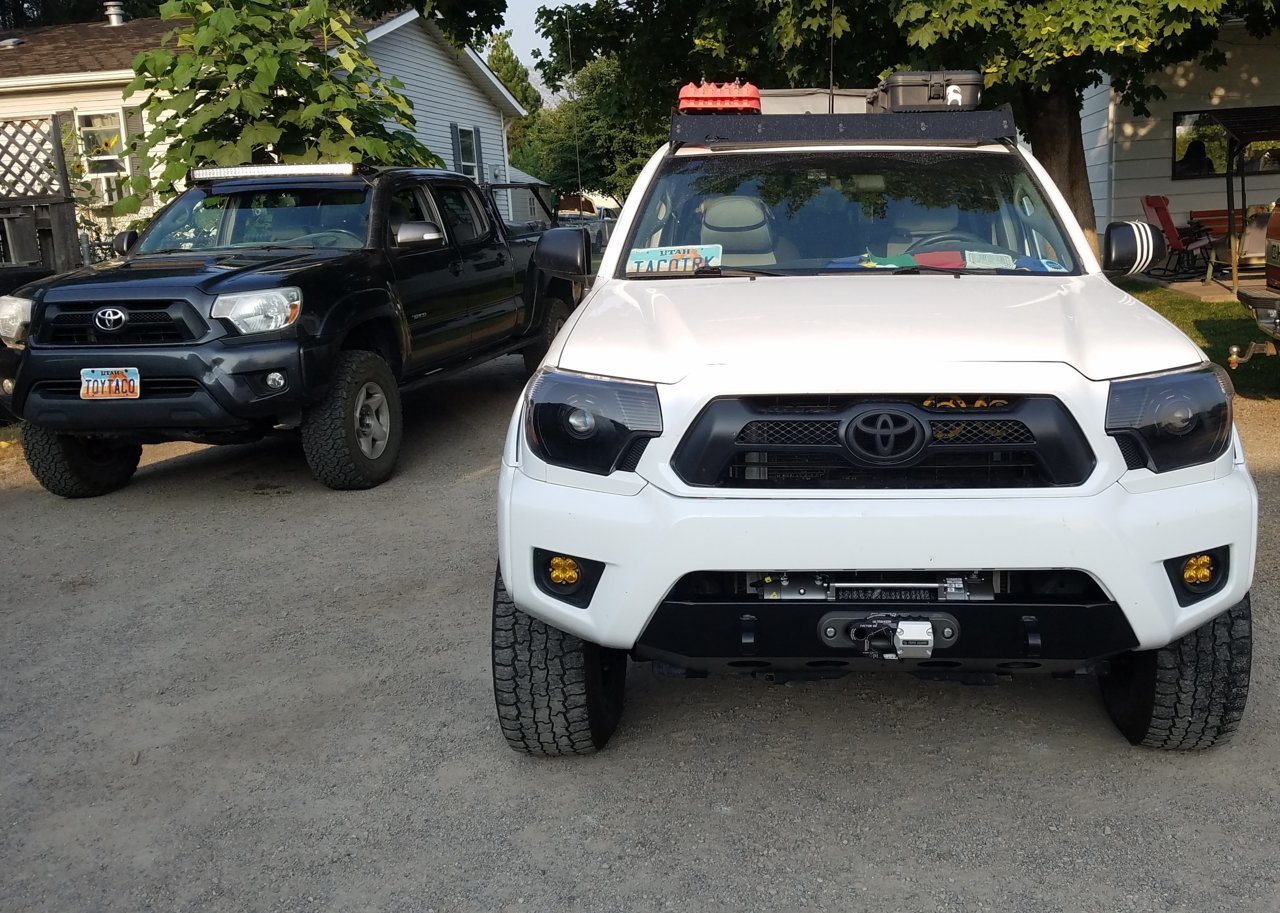

    @brvermilli21
    If you are looking for a low profile piece of front recovery kit, I'd HIGHLY recommend the bumper insert from US Offroad. Super low signature, and it pretty stout to do snatches and block and tackle winches off of. After last weekend yanking much heavier race trucks bogged in the sand with great results, I'm sold.

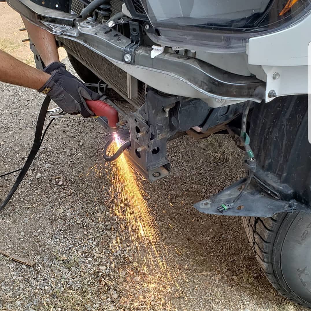

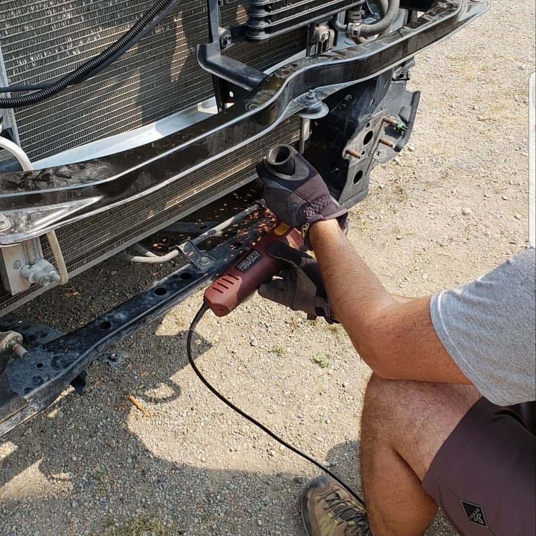

    Nice!! How much did you have to cut from the front bumper? Any install pictures?

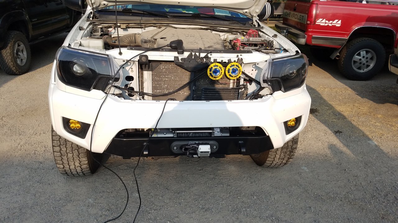

    You just have to cut off the shipping tie down on the driver's side and chop the lower center valence. It is pretty soft, so a hacksaw could do it if you had the arms. I borrowed a friend's plasma cutter and angle grinder though, because why not! Took about 6 hours, in line with USOR's instructions. Granted I also redid my negative terminal and cleaned some stuff up while I was doing it. Very clear directions too btw!

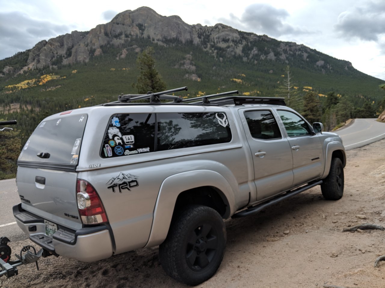

    Finally getting around to posting some of our pictures from our road trip to CO. What a trip!! The Taco did great driving out and back....not an issue at all. We slept out of the back of the truck for a week and it worked perfect! I cant wait to go back out west and do some more exploring.

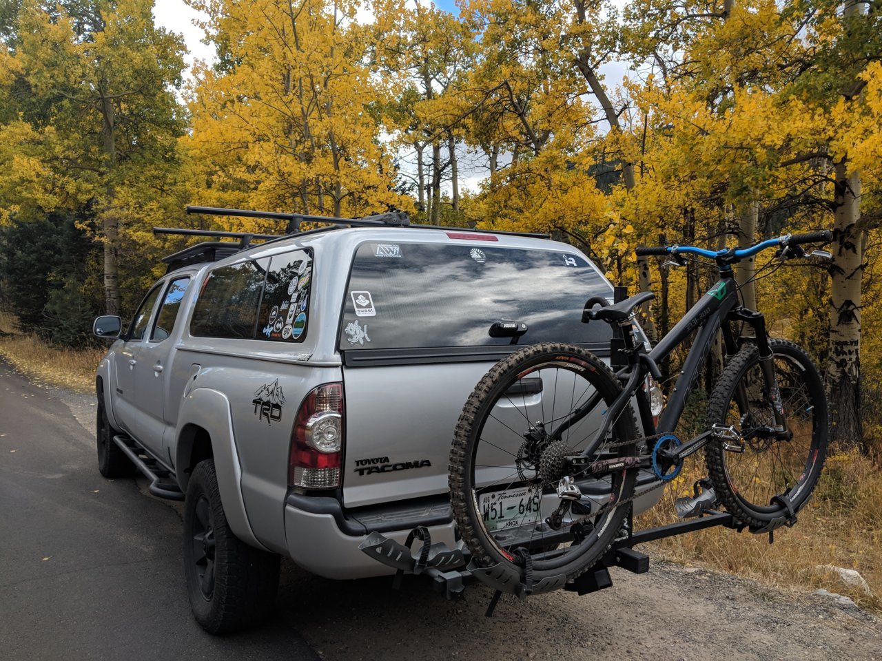

    more pics...
