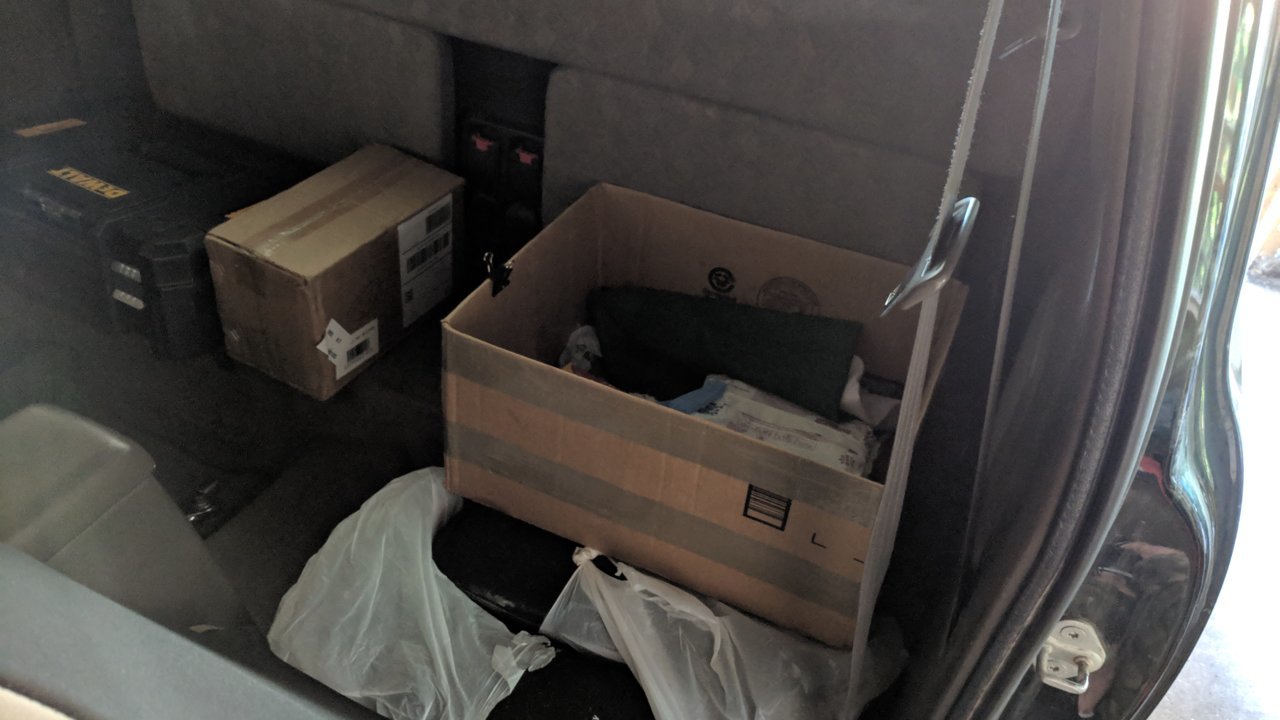

  11. May 17, 2019 at 1:01 PM
    #2091
    Blackdawg
    Blackdawg Dr. Frankenstein
    Dec 31, 2010
    #48500
    81,598
    Monte
    Wyoming/St. Louis
    The Trifecta of Taco's
    Mine go in the back seat standing up with the toes under the front seat. Couple of walmart type bags go on them to keep dirt of of shit if I have other stuff back there. Otherwise I have a floor mat back there anyways. (in Igor of course)
    Like them in the truck so I can put them on in the truck if needed. Have had to do that several times.
    RobZ9132, MR E30 and turbodb[OP] like this.

  20. May 17, 2019 at 5:12 PM
    #2100
    turbodb
    turbodb [OP] AdventureTaco
    Feb 9, 2016
    #177696
    8,496
    Dan
    PNW
    2000 Tacoma Xcab 4x4 SR5 V6 TRD
    AdventureTaco
    It's actually two bags. Here's the situation - you can see how they "puzzle" in there; keeps the box (usually full of misc stuff - snacks, etc. - on a trip) from tipping down in front when headed downhill over bumps, etc.
    Same - was nice to jump out of the truck with them on.
    I used to keep them in the bed (under the tent in a little cubby I have behind the fridge). But I found that the sliders were nice and muddy a lot of times when I wanted them, which defeated the purpose.
