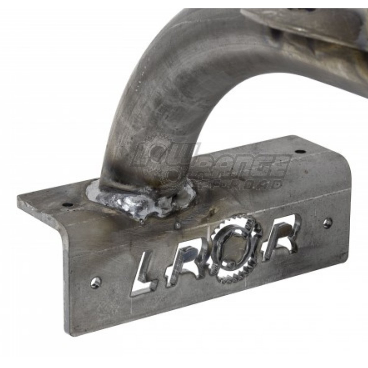

    Rago fab makes 1st gen bed stiffeners. Not sure if I've seen anyone install them or give feeback though. :notsure:

    Huh wonder how that works.

    There's a few different versions floating around out there, same as the rear bedside stiffeners. I got mine, as well as my bumper from @At The Helm and they're great. A riv-nut or drilling a hole for a bolt, or just welding would work fine i'm sure.
