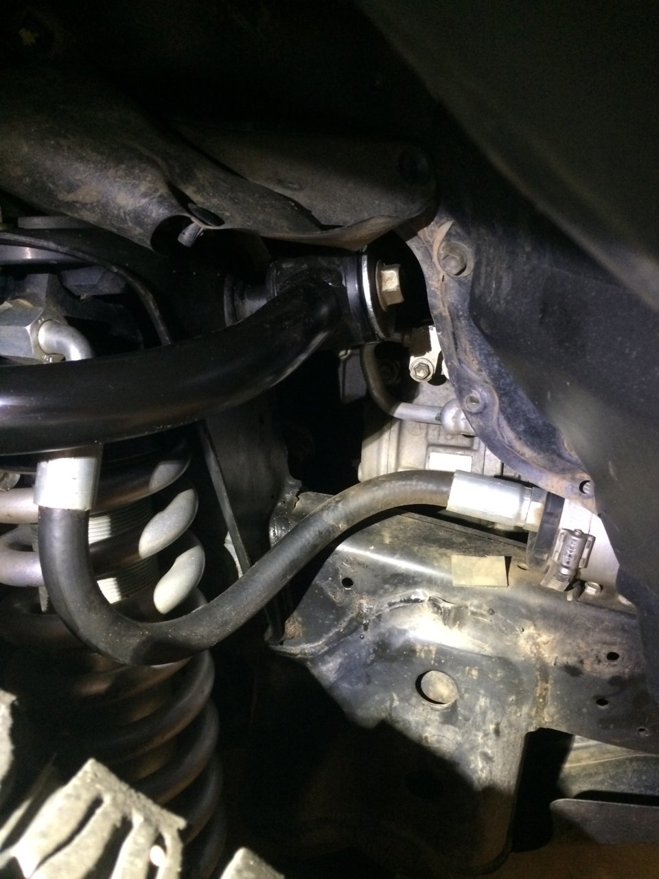

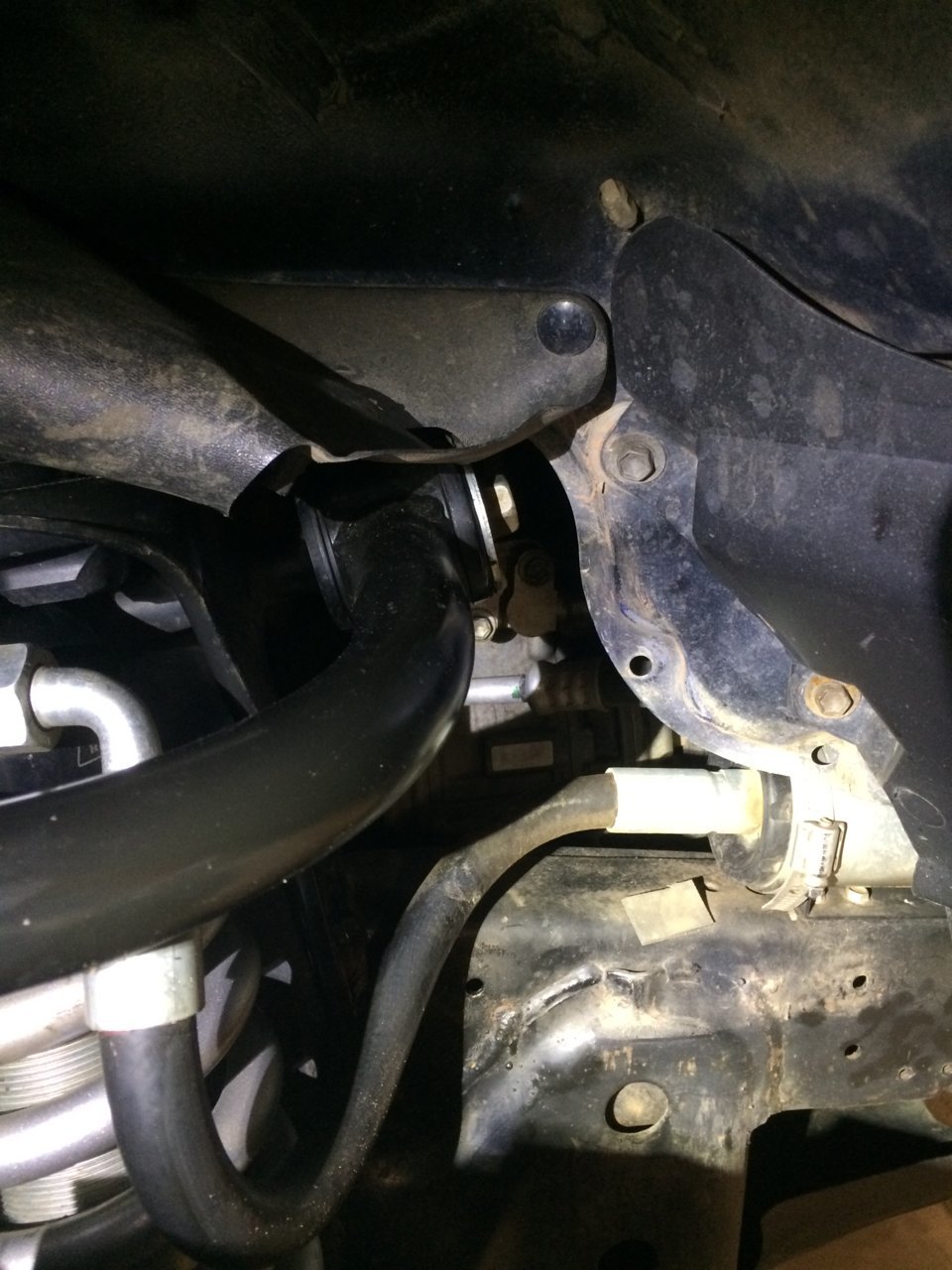

    For the ADS resi mounts - what does the connection between the hose and resi look like for you? Is it a straight fitting into the resi? Those are definitely the ADS brackets, so if I can get them mounted up there, that'd be awesome.

    Yes, It is a straight fitting into the resi. Here are a couple of pictures. Hope they are clear enough:
    rob1208 and turbodb[OP] like this.
