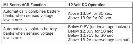

    I would check that ML-ACR out. It should isolate batteries soon after the charging voltage is lost. Mine does in about 10 seconds or less. Not sure on your model though. I have the 7622. From the instructions:
    The ML-Series ACR automatically combines batteries during charging, and isolates batteries when there is no charging sensed on either battery bank.

    The ML-ACR only works "sort of" like that. Right below the line you quoted, the table is actually a better description of how it's designed to work:
    So, if you're seeing the ACR isolate in 10 seconds or less, then you've got a battery that's under 12.35V (or so), and so it's isolating them to protect the other battery.
    The way it works - or at least the way it's designed to work when the manual switch is in the "automatic" position (not forced link or forced isolate) - is that it keeps the batteries connected if their voltages are similar and above the lower threshold, which looks to be about 12.35V. That can be for quite a long time - for me (and others I've travelled with) - even until morning on nights that are reasonably cold and so the fridge only comes on once or twice.
    Still, you're point of checking it is a good one. I did actually do that (which is part of why I can say how it should work, lol), and quite a few other things in the last couple of weeks and I've got it all written up to post here in the near future. Just a couple final pieces to fall into place, and a couple other posts to come first ;) :thumbsup:.

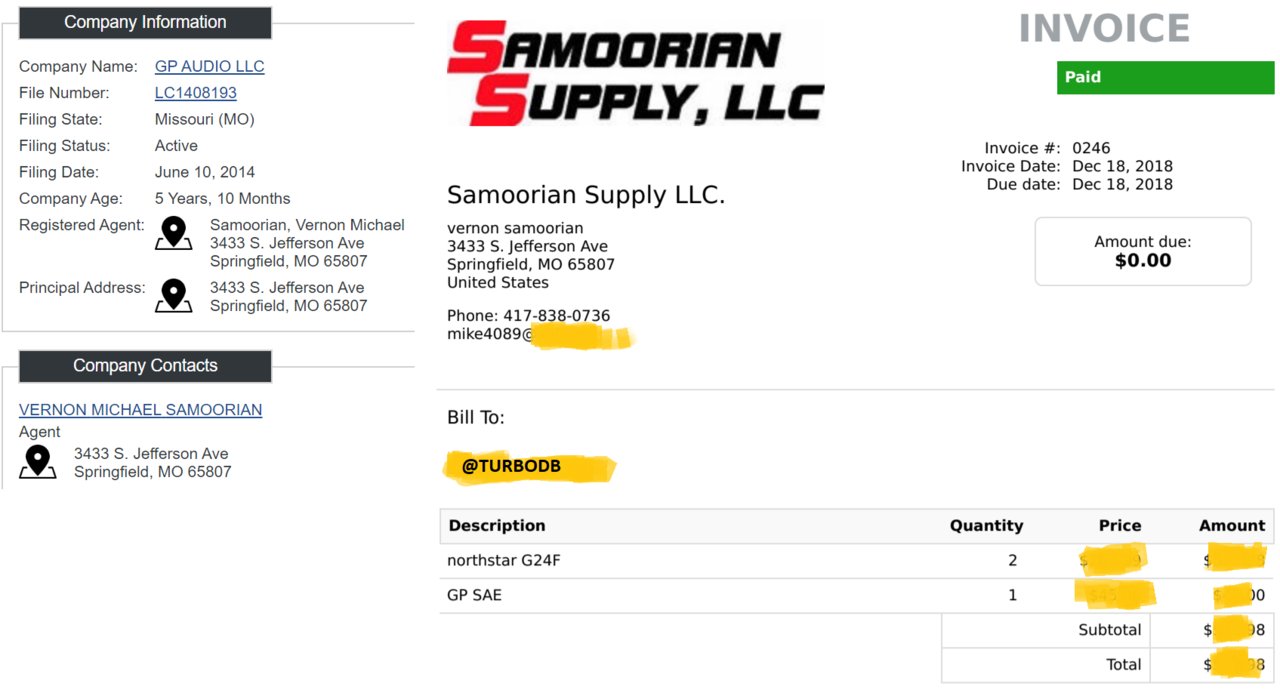

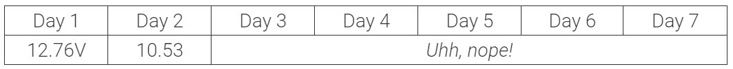

    Is There a Problem with My Second (House) Battery?
    On our last trip to the Eastern Mojave, one of the things I noted early in the trip - actually, before the trip even started really - was that the battery in the cab seemed low. I chalked it up to an error on my side and figured that the long 20-hour drive from home to our first hike would be enough to get it back up and kicking.
    It sort of did, but the battery seemed weak the entire trip, dropping below 12V reasonably quickly - much more quickly than it has in the past.
    Initially I figured that I'd just warranty the battery, but as I thought about it, I realized that before jumping to that point, I really needed a bit more information about what was happening. Replacing the battery would do no good - in the long run - if I had a parasitic drain somewhere that was causing it to run down.

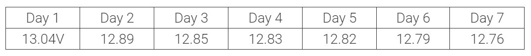

    The first step then, was to get the battery back in tip-top shape. To do that, I turned to a CTEK 56-959 MUS 4.3 Charger/Conditioner/Tester. I don't know if the CTEK is better than any other similar product, but it was recommended by Mike @Digiratus as something he's been using for the last few years. I've been wanting one for a while, so I used this as an excuse to finally pick one up from Amazon.
    More than just a charger, the CTEK 56-959 has a couple extra functions that - at least according to the manufacturer - can help to keep a battery in better shape than just a run-of-the-mill charger.
    I don't know if these things are real or just marketing but here's what they say. Steps 1 and 6 are the ones that seem like benefits over a simple charger.
    • Step 1 detects sulphated batteries. Pulsing current and voltage removes sulphate from the lead plates of the battery restoring battery capacity.
    • Step 2 tests if the battery can accept charge. This step prevents charging of a (seriously) defective battery.

    My next step was to let the battery sit for a week - with all accessories disconnected - to see what the voltage drop was over that time. Over the course of the week, here's what I found:
    The drop over the week seemed reasonable - or at least nothing that indicated a battery that was completely incapable of holding a charge. So I proceeded with my next experiment - reconnecting the accessories and going for another week.
    Clearly there was a problem - a 12-13mA load overnight should not cause a voltage drop of that amount, so I was reasonably sure that I had a bad battery. A quick trip to my locall O-Reilly Auto Parts for a battery load test confirmed my suspicion - though, I've got to say that the printout of the load test leaves a little to be desired, at least for a data nerd like me...

    For some reason, I thought you had purchased your Northstar's through a TW group buy through Ramon. I am confused.

    I did; but they come from someone besides Ramon you know ;). GP Audio has been the supplier for all the Northstar group buys on TW.

    :smack:Of course. Mine were purchased through Ramon too but they weren't from GP Audio. At least I never saw that name in the transaction documentation.
    Vernon Samoorian is the name on the paypal invoice, Samoorian Supply
    Maybe, as you say, all of his GBs were through the same place, but I think they are not. I can't find anything that says Samoorian and GP Audio are the same. And it doesn't matter really. Just hadn't seen that name before.

    Fun fact: same place. :D
