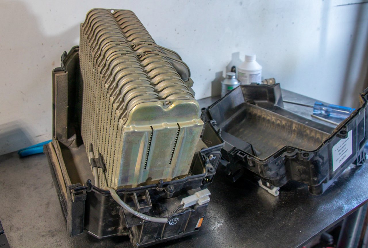

    The Air Conditioning Doesn't Work
    TL;DR - I need to replace the evaporator core inside the cab of the Tacoma so we can get cold air again.
    I'm not sure why this hasn't been in past rig reviews, but it's definitely been an issue for over a year. I took the truck in to get the AC recharged before trips last summer and the tech (at Toyota) initially said that I had a leak. However, upon recharging the system, they couldn't find the leak so they called it good and told me that I could come back and they'd apply the amount I'd paid for a recharge to the diagnosis if the recharge didn't hold.
    Sufficed to say, a few months later, the AC wasn't working again and I took it back to Toyota. They were great and diagnosed the issue for "free." Turns out that after filling the system with dye, there were no leaks in the engine compartment, but when they used a sniffer on the AC vents, they discovered 134A blowing out into the cabin. This, they assured me, was because the evap core had a leak, and so as air blew over it, it was blowing the 134A into the cabin.
    And, it would only be $3,800 to fix. So yeah, I passed on that and haven't had AC since. With summer coming (a second time), it's something worth noting - because even on this last trip, there were times where it would have been nice to have some cool air blowing on us.

    Its a pain but definitely do able to replace the evap core by yourself.
    I did it in about 2 days on my second gen. Could have completed it in one day I think if I hadn't had to pull the supercharger to get access to disconnect the heater core lines going into the cab.
    turbodb[OP] likes this.

    I didn't think it was so much of a pain ;). Well, except that the first evap core I got was faulty, lol. Story coming soon, just been too busy to write it up!

    And then, starting from both the front and back of the cabin, carefully remove the carpet! Note: There are several clips along the door threshold that need to be removed in order to fully remove the carpet.
    Remove these plastic clips prior to removing the carpet.
    With the interior of the cabin removed, the final element to tackle in order to make access for sound deadening is the removal of the interior door panel. This is not difficult, but can be a bit finicky, so pay attention as you do this work. Note: there are many different door panels, so if you have a different panel than me, you'll need to research it's removal. It will be similar, but vary slightly from what I have here.
    First, lower the window. This will be important later when removing the interior panel, at which point the ability to lower the window will be limited since the window lowering controls will be removed/unplugged.
    Next, pop out the two plastic covers on the arm rest and remove the two Philips screws. Note that the arm rest will stay in place.
    Remove the single Philips screw securing the interior door lever, then, carefully push the door lever forward to unclip it from the door.
    At this point, you can see that there is a small plastic clip that secures the door lever to the metal rod that connects it to the door latch. Carefully release the slip by prying it towards you, being careful to not break the clip. Once the metal rod is released, remove the interior door lever.
    Remove the arm rest control panel by prying up from the front edge. Note that if you pry on the rear edge, you will break the rear clip. As you lift out the control panel, unplug any electronics that are connected to it - for power windows, door locks, and mirror adjustments.
    Next, remove the small triangular trim piece near the side mirror by simply prying on it from the bottom to release the clips.
    Depress the center of the clip at the upper-forward corner of the interior panel and remove the clip.
    Finally, starting along the bottom edge, slowly pry the interior door panel away from the door. Once you find the location of a door clip, pry carefully on each side of the clip until it releases; then move on to the next clip. Eventually, all the clips will be released, and you can lift the panel up and over the door lock to remove it from the door.
    "Never been off pavement." - Every Craigslist post, ever.
    With the interior door panel removed, the final elements to remove are the speaker and plastic weather barrier. The speaker removes by disconnecting the plug and removing the five Philips screws. The weather barrier simply peels off.
    And that is the interior removed! It will be out for a while, so arrange it in an orderly fashion somewhere while you do the rest of the work. Good job me! (And you!)
    All that's left now is a bit of cleanup and then actual application of the sound deadening material. Oh, and then putting everything back together again. And I'll address all of that in the next part of this story-turned-tutorial.
