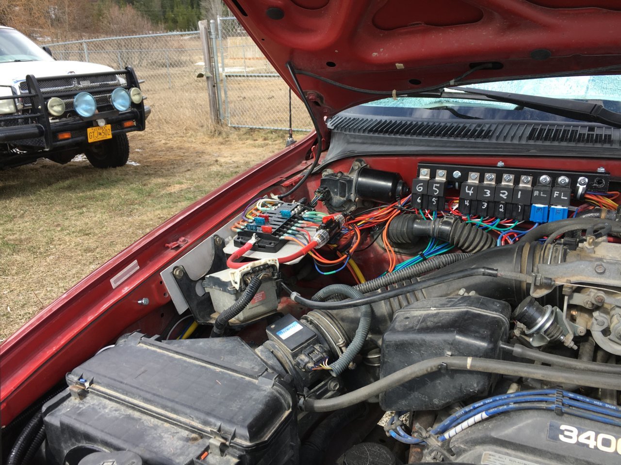

    Great write up on the sound dampening, another one for the to do list!
    Another fun learning experience about this type of project is that while you have to be optimistic about being able to do the job, you definitely have to be pessimistic about having enough supplies. That is where the bush mechanic comes out and then you have enough bits and pieces to do about 1-1/2 more wiring projects . Don’t even get me started on revisions....
    Fuse panel install ver 1.0: next version will have a bigger bracket...B01EAD62-1CB9-44AD-A3A1-C85DAB088975.jpg

    So true. I still have all those electrical supplies I bought for the Bussman, LOL. Will use them eventually I guess. Ironic thing is that now with the dual batteries, a lot of the electronics are in the cab, and the Bussman is used only for the aux lights and compressor, since it connects to the starting battery. Basically, unnecessary. Still a fun project though!
    That looks like a great setup! I'd have put my Bussmann there if I didn't have F$#%#$# ABS! LOL.
    Arctic Taco[QUOTED] likes this.
