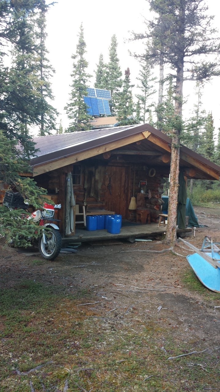

    It fits, although I did outsmart myself(like that is difficult...) and had to move the blue(ceramic road and fog light relays, over next to the headlight relays- headlight services harness mod) between the battery and the fender. Too tight/thick of a wire bundle under the bed frame angle iron(a little clearance issue from the rubber mounted clamps and the firewall) I used to mount the relays to the firewall with.
    I ran all the wiring a bit long so I would have some slack for future fuse panel location adjustment and if I came up with a more efficient way to wire everything(ver3.1?) also ran all the control wiring to the relays for future use to the switch panels inside as well as dedicated wiring for the replacement of the 2 power points-( of course one turns out to be defective- too loose, it will wait till I get back up to AAL next summer, I have a bunch of them for rewriting my off grid cabin)79E9B046-2CCE-410B-AFC8-4D0B22E38CA6.jpg
    and the 2.1A each USB charger in the third one. The Paranoid fab switch plates and marine 12v sockets/USB charger:6D112B33-DEA4-420E-9F76-D692B11A89E1.jpg
    Not a complete crap show but getting there. Now to clean out the cab yet again...
