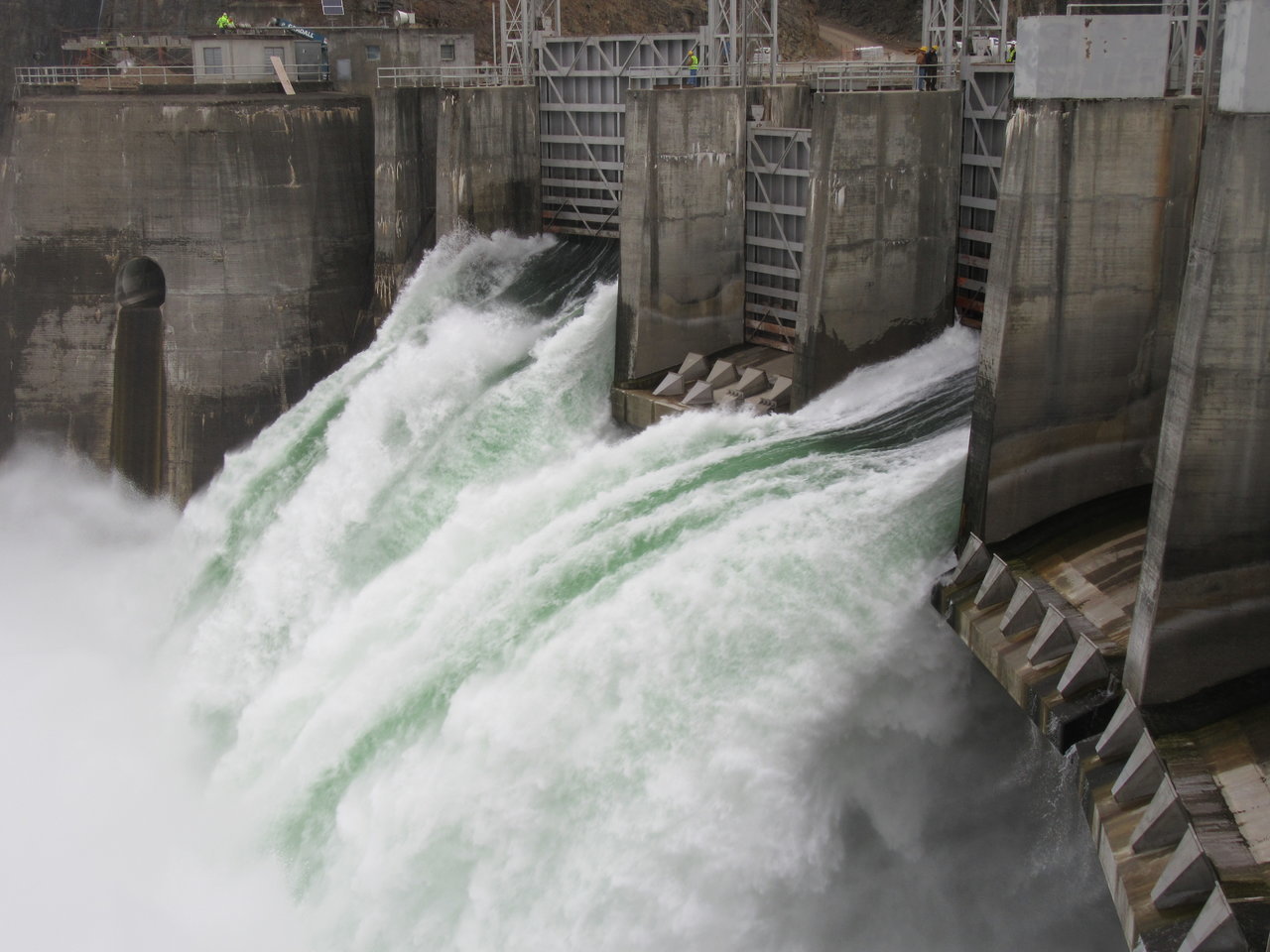

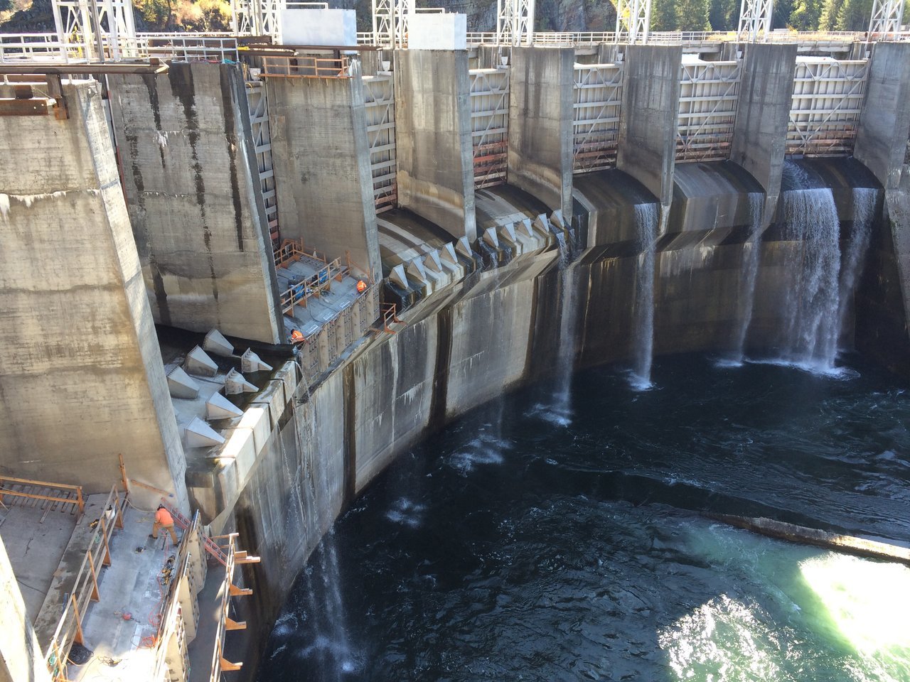

    Course, while you guys were getting snowed on, this is what I was doing in sunny northern ID:

    well that looks cool.
