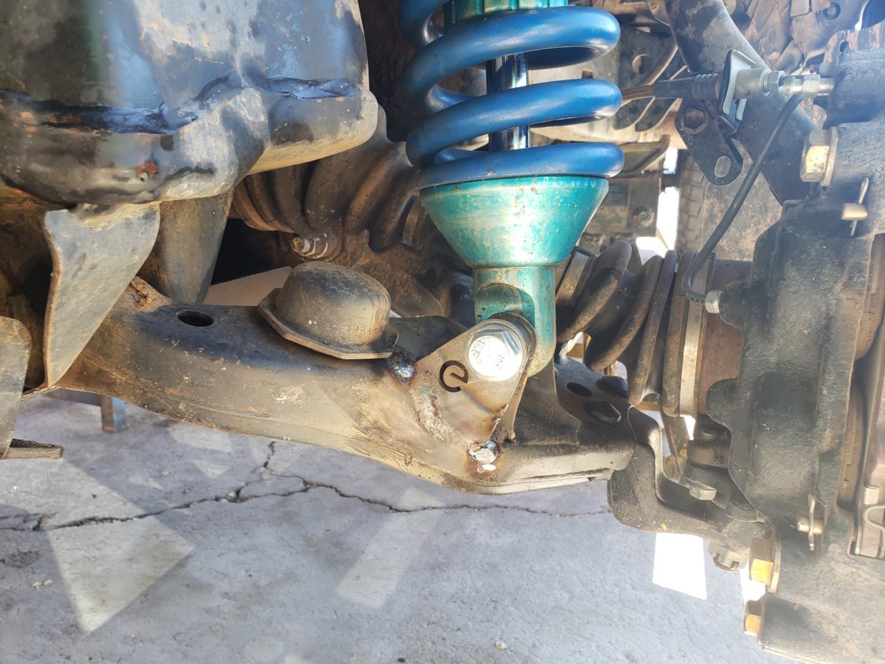

    3. Remove the lower bolt of the front shock using a 19mm socket and wrench.
    If, at this point, the LCA drops down below the lower eye of the shock, that means the shock is limiting the travel of your front suspension. You need limit straps.
    Even if the LCA doesn't drop down below the lower eye, if you can push it down below the lower eye without a ton of effort, that shock is still limiting your travel - and you would benefit from straps. This is because the additional weight of the wheel+tire, and momentum when the suspension is cycling, will result in more downward movement than when the suspension is just sitting on stands.

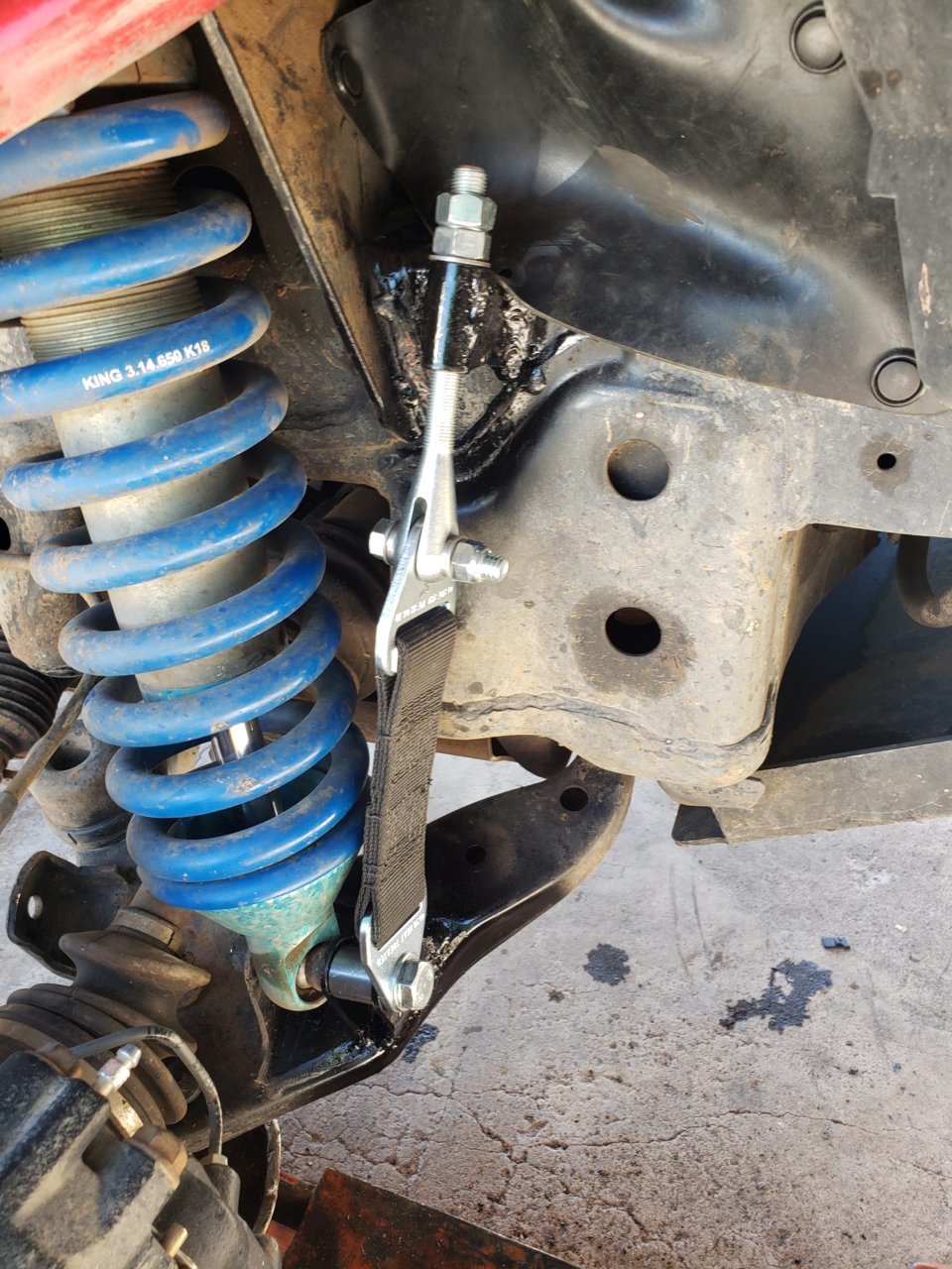

    Strap installation is reasonably straight forward. The first step is to figure out the length of straps that will fit and then purchasing them. For a 1st gen Tacoma with OEM LCAs and the sway bar removed, 7" straps are about right. I ordered up a set of 7" Kartek straps, two clevis' to secure the top of the strap, and two clevis mounts, which arrived a few days later. I also picked up a couple of Grade 10, 9/16" bolts and nylock nuts to secure the bottom of the strap.
    With this configuration, the clevis mount is welded to the frame of the truck, and the bottom of the limit strap is secured to the LCA using the sway bar mounting point. I got started by taking off the front wheels.
    With the wheel removed, the next step was to lay out where the clevis mount would attach to the frame. This is done by
    1. Assembling the limit strap with the clevis and clevis mount. Make sure that the lock nuts at the top of the clevis are at the very end of the threads, such that the strap can be tightened over time by threading them further down the clevis shaft.
    2. Installing the bottom of the strap in the sway bar mount.
    3. Allowing the shock to extend (droop) fully. Note: This fully extended point is the point at which the strap needs to be protecting the suspension. Since a strap stretches slightly, it needs to both engage and reach full stretch before this point.
    4. Note the location of the clevis mount on the frame.
    Having noted the location, I used an angle grinder and flap disc to remove any paint and rust from the frame in order to prep for welding.
    Everything prepped, I welded the clevis mount to the frame, and hit the entire area with a couple coats of primer and paint.
    All that was left after the paint dried was to reinstall the clevis in the mount and adjust it so that the strap reached full stretch when the brake rotor was about ¼" above full extension. This is something I may adjust over time, but I figured that a ¼" buffer was a good starting point for limit strap stretching and to compensate for additional stretch due to weight and momentum of the tire on the trail.
    And that's it. Insurance installed! Reinstallation of the wheel and everything is good to go.

    Hm I'd have plated the spot you put the mount for the limit strap personally. Lot of force being put on that at times.

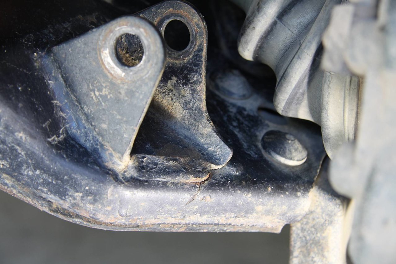

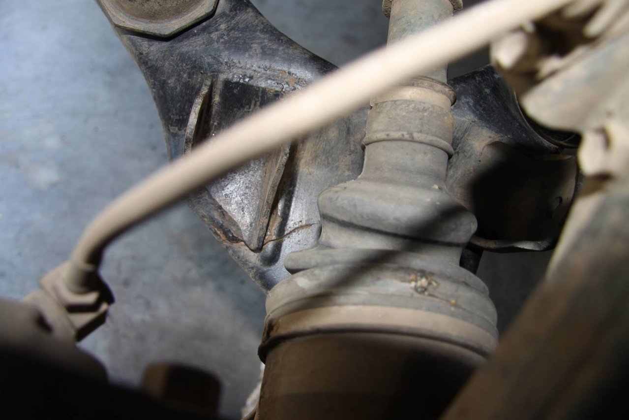

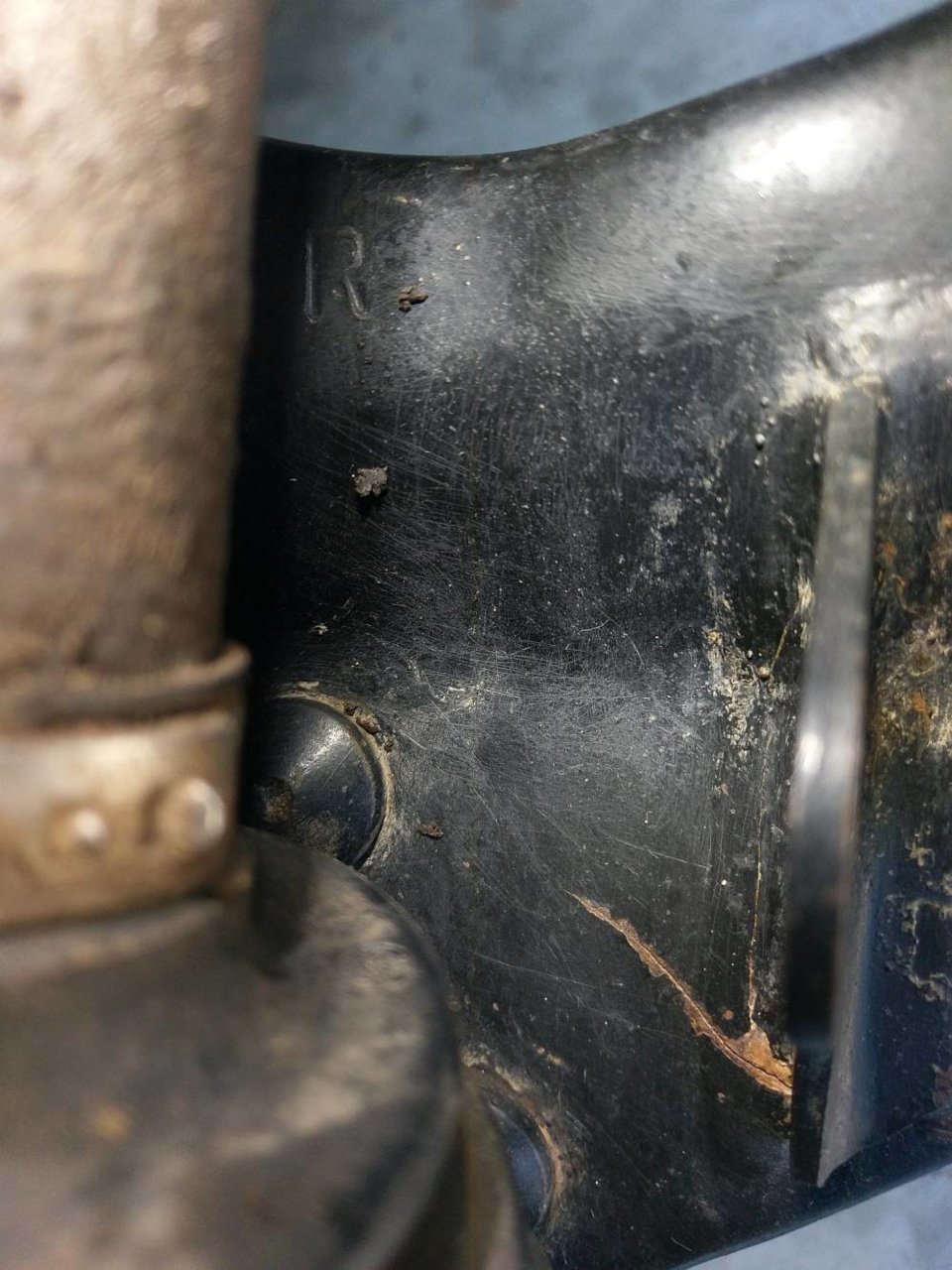

    It may be worth noting that the OEM welds that hold the lower shock mounts to the LCAs can also fail for the same reasons the shock towers can fail. So limit straps will help with that as well.
    Some evidence we found on both of my LCAs:

    Yeah, I thought about it but after looking at it and seeing how thick it is there, and after seeing how Mike (and I think Dan or Zane) did his, I figured it'd be just fine. I've been on ~12 days of dirt since the install and it seems OK, so hopefully it lasts a lot longer. If not, I'll just re-do it.

    As far as the lower shock mounts go - I agree with you, and I should note it in the write-up. One thing I'm curious about is whether I'm going to transfer the "problem" to the sway bar mount where the strap is installed. Seems to me like that piece/weld now has a lot of force that it never had before, and we could start seeing weld cracks there. Time will tell; I'd rather have that fail than the tower at any rate.

    I would agree with you about the swaybar mount except that it appears to be attached much better to the LCA compared to the lower shock tabs.
    I will be curious to see if your straps have stretched or not. Mine did some.
