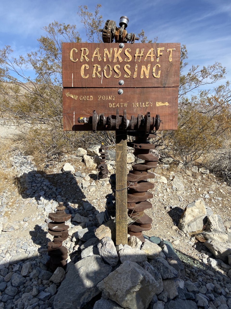

    ...speaking of signs...i was realizing the reality that Crankshaft got a new sign!
    totally bitch’n..i could not read the old sign
  12. Jan 26, 2021 at 7:04 PM

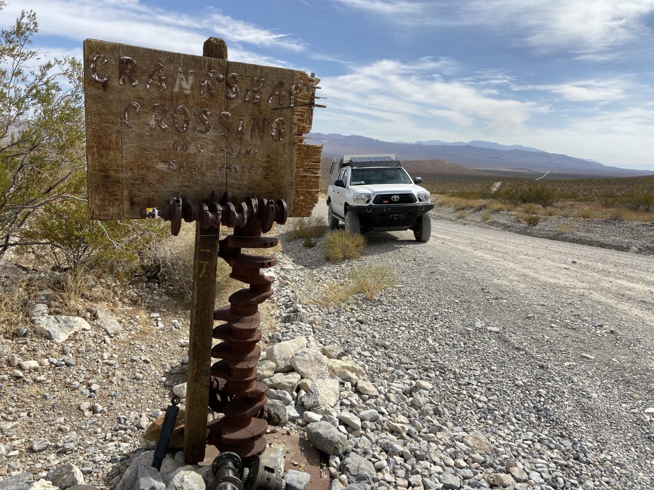

    speaking in tongues about signs...dredged up the previously extant version

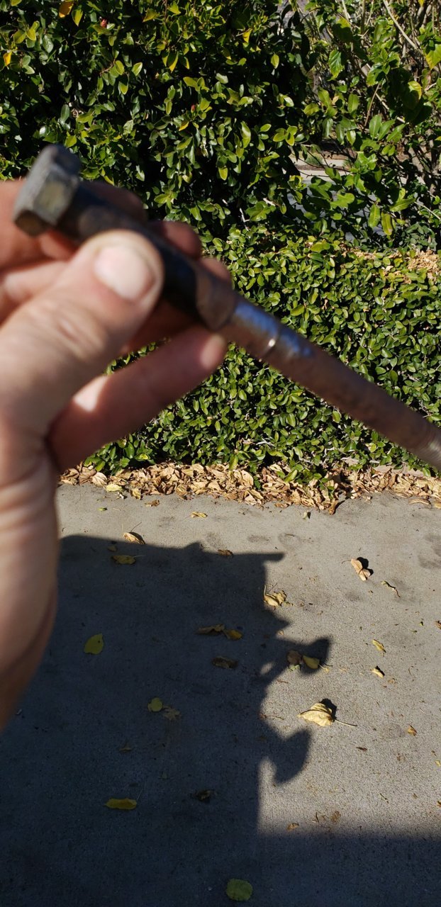

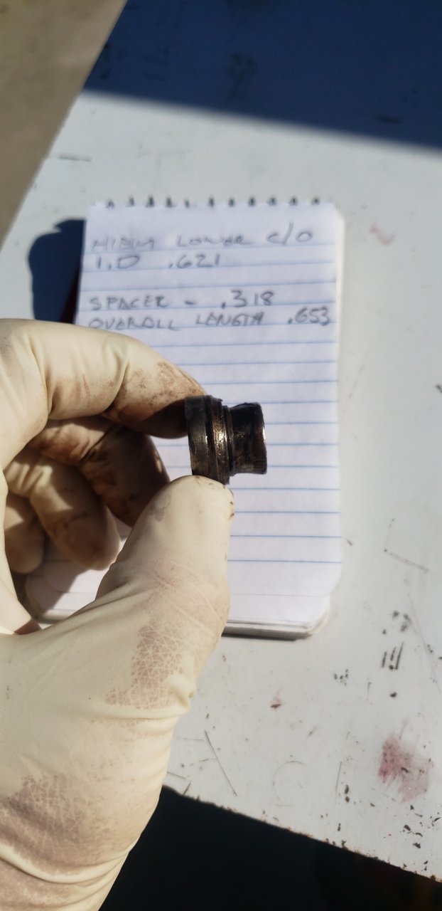

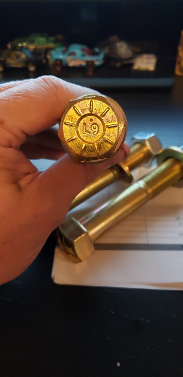

    I recently swapped put my lower coil/over heims and found my misalignments all flared out.
    Most likely from this wear on the lower coil/over bolt.
    So I upgraded all the front end hardware to some fancy bling bling grade 9 L9/F911 bolts
