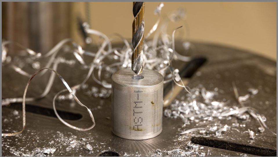

    Little bit of maintenance today.
    • Oil change - a bit late (for me) at 9K miles. Just how trips and timing between them worked out. Oil looked just fine, so not worried.
    • Driveline grease
    • UCA grease
    • 5-tire rotation
    • Spherical bearing inspection after 15K miles. Passenger side is still "OK," driver side is "OK+" or "Good-" hahaha. Definitely not as tight as new - when a bolt/lever is needed to move the sphere. Definitely not loose - there is no space between the ball and retainer. I can move the ball by hand, relatively easily, though more easily on the passenger side than the driver side. Mike @Digiratus - I'd say that the movement is similar (though I could be misremembering) to the movement of yours when you brought your shocks over to adjust the ride height with the spring compressor. So, these SS bearings are certainly lasting longer than the COM10Ts I was running previously (where I was getting a jiggly joint at 10K miles), but I don't know if they would be better than the hardened steel versions. I don't know the price difference either, so it may be a moot issue.
    As far as my rating scale goes, I guess it would be:
    • New
    • Good
    • OK
    • Time to Replace
    • Oops
    In the case of spherical bearings, "jiggly" is between Time to Replace and Oops. Worn bolts and chewed through misalignments is defniitely Oops.
    Edit: And Mike - I got my misalignments from Tyler over at ADS at the same time I got all the COM10Ts. I'm sure @TMFFs are just as good or better. I'd just get it all from him now.

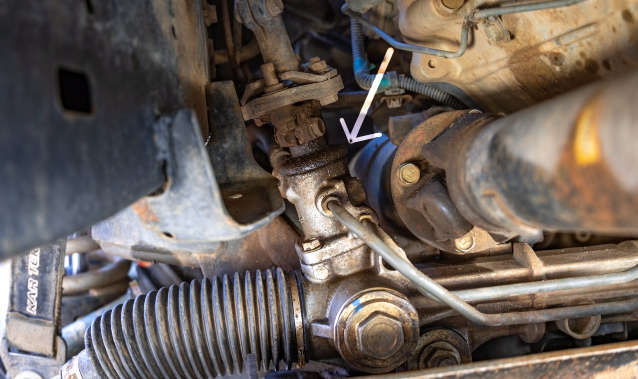

    Oh, and I took this photo that I don't really want to talk about but probably should. Leaking out of the top joint/seal/mushroom thingy. Is that something I can replace, or is it new rack time? Maybe I should post this in the daily thread as well. We'll see if I get responses here.

    Thanks for the 15K feedback. Do you know the part number or FK identifier for the 'hardened steel' version?
    For the leak, I'm pretty sure that Ben is or was fighting this issue. I believe he is planning to replace with a new rack.
    It's a guess, but I suspect the entire rack has to come off to get to that seal. If true, I'd be inclined to replace the entire rack. A new OEM version comes with inner TREs too.
    edit: FWIW, we replaced my rack at 176K and I think that is close to where you are now...
    turbodb[OP] likes this.

    Thanks. And yes, I am near that mileage - over it actually now - 190K! (OMG, how can it be?) Anyway, I'll plan on replacing the rack, but first I'll monitor/ignore it and carry a quart of ATF just in case. I think Ben @m3bassman got away with that for quite a while. :rofl:
    The hardened steel versions are FKS10T. Just for your perusal if you are curious.
    Don't forget that you want the "tightest" version of these, designated by adding an "-F1" to the end of the part. So FKS10T-F1 for instance.

    I recently replaced the rack in my truck. It had been leaking for some time. I went with replacement only because it was quicker.
    turbodb[OP] and Digiratus like this.

    Do you recall seeing an F1 marking on the bearings you used?
    I can find F2 fit bearings all day long. But finding F1s, FKSSX10T-F1, is proving to be more of a challenge. Where did you purchase your F1s from?
    A few things I found interesting (this is turning into a very deep rabbit hole):
    1) F2 fit is considered the standard and by definition their new condition is what you (we) are describing as OK+ or Good. :(
    https://www.fkrodends.com/tech/torque-specs__trashed/
    In your research, you likely already saw this or something like it. But in case you haven't, check it out.
    “The rod ends that we do with PTFE liners come in three different fitments; F1, F2, and F3,” Jay Langley explained. “In a less technical terminology, with an F1 fit you will need a bar to move the ball within the housing, an F2 fit you will be able to move the ball with your fingers but has some resistance, and an F3 fit will move freely.”
    https://www.offroadxtreme.com/featu...king-fitment-on-ptfe-liners-with-fk-rod-ends/
    2) ADS website lists FKS10T-F1 at $15 each. Based on the FK part number, these are not stainless steal and may not be case hardened and they are about $10 ea. less than FKSSX10T(F2) bearings I've been seeing elsewhere.
    3) The imprints on the bearings in this pic do not actually say F! but the packaging below them does.
    Here is a pic of the F2 fit bearing on the Kartek website. Hard to see but it looks the same as yours but Kartek says they are F2 fit.
    https://www.kartek.com/parts/fk-rod...coated-uniball-spherical-bearings-f2-fit.html

    Thanks both. I'll likely go for a new rack too, for expedience. After I procrastinate a bit.
    It is quite the rabbit hole, and you're headed the same way I was when I did this, hahaha!
    The only place I could find them online was here, for ~$20: FKSSX10T-F1 Tighter Teflon PTFE Liner Spherical Bearings, 0.625 Bore (offroadwarehouse.com) That said, after ordering, I chatted with Tim @TMFF and he mentioned that all the bearings he sells are -F1. I forget if they are the COM or FKS series though. I'm sure he can get anything, so in the future, I'm buying from him.
    Yeah, I'd call the F2 fit Good, and the F3 fit is my OK, as they describe it. I didn't see either of the items that you reference, but FK sent me a similar PDF which I uploaded as an image in my post. Says the same thing, and after I read it, I knew I wanted -F1 for sure.
    Interesting. The bearings I bought from ADS were $7.50 each, so clearly not FKS. With the FKS only $5 less than the FKSSX (from offroadwarhouse), it feels a bit like a wash to me price wise. I'd probably ask @TMFF for a set of each, just to see if one performed better than the other, and then go with the better performer. I don't know why, but I wouldn't be surprised if the FKS perform better for some reason that I don't totally understand. In fact, no matter how these do, I'm going to get some FKS from Tim next time, just to try them out.
    You are correct - there is no tightness (-F1) marking on the bearings themselves, only on the packaging.
  15. Jul 12, 2021 at 11:56 PM
