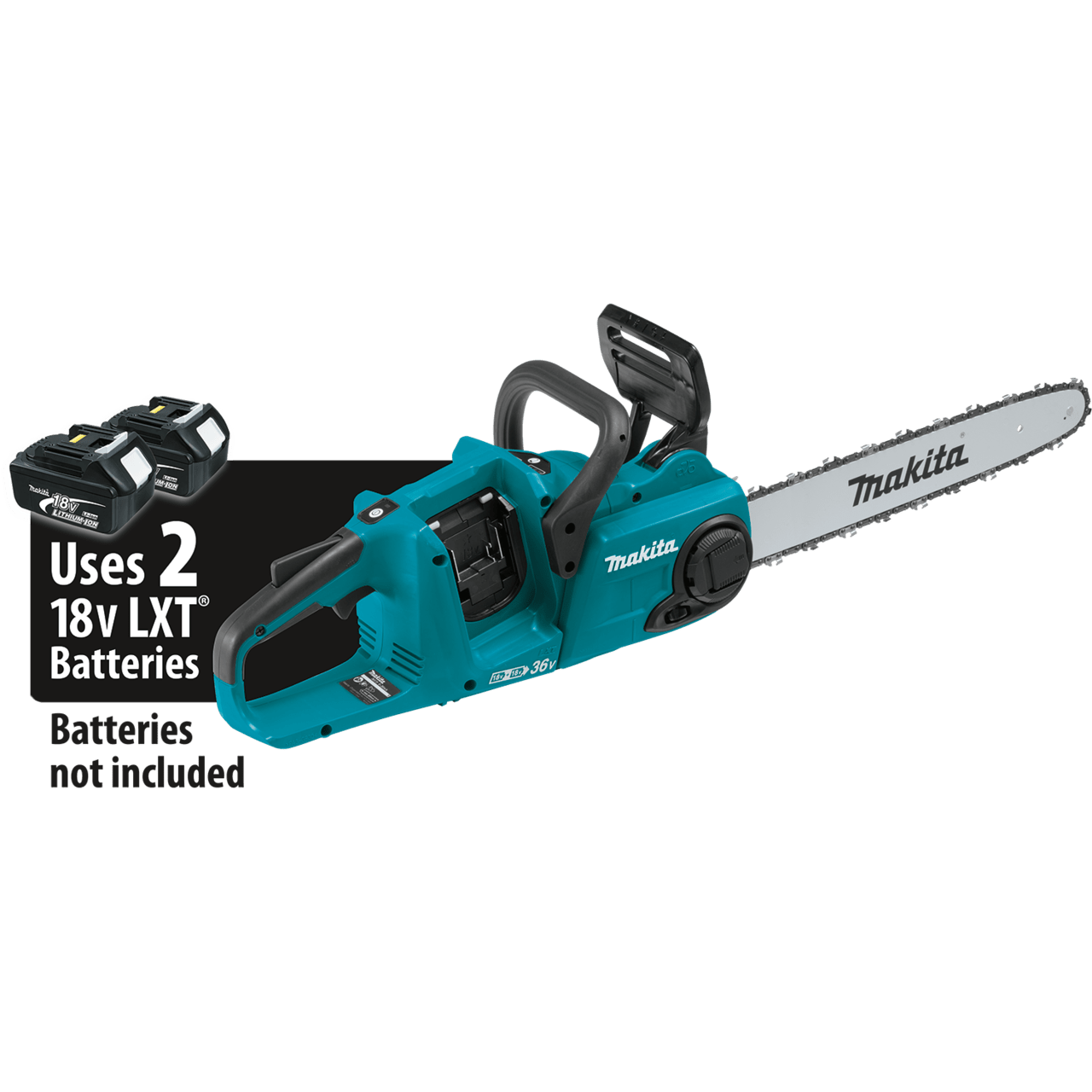

    I think that will be a fine saw, if you aren’t already invested in batteries from another color brand. I’ve also heard good things about the Dewalt, and of course the Milwaukee.
    I think stihl also has one, but obviously the batteries for that wouldn’t be compatible with any of the normal cordless tool systems.

    Yeah I already drank the teal Kool-Aid. Or whatever color Makita is. I think they had like 8 tools total across the whole platform when bought their cordless drill 10 years ago. Now there's like 300 and it's really getting out of hand. I'm waiting for them to make a Brushless LXT Cordless C̶o̶f̶f̶e̶e̶ ̶M̶a̶c̶h̶i̶n̶e̶. Edit: Shit, they literally already do. What's next, a Margareta Machine? (checks catalog one more time...)
    But in seriousness, word on the street is that they're rolling out a 20" chainsaw any time now. So obviously I have to wait for that one now.
    Good point, this is looking more and more like a common-sense investment in my own personal safety.

    I can't find evidence that this tool is certified to a specific IP rating, but it boasts Makita's "Extreme Protection Technology," which although arguably meaningless, suggests that the product is designed with some (albeit unknown) degree of ingress protection.
    What I can tell you is that I've seen this particular chainsaw demonstrated at a trade show. It was stored in a clear plastic box, in which it was sprinkled with water to simulate rain. Not immersed, just light rain. I wouldn't be surprised if they were using distilled water (I would if so tasked) but I obviously don't know. Anyway, from time to time the sales rep would pull it out and someone would get to lop off a short piece of a log with it. They did so in a separate clear plastic room-sized enclosure, perhaps for safety reasons but also likely part of the show, because it was impressively, like insanely quiet watching this thing chew wood to dust while scarcely audible over the clamor of the convention hall. Had I been invited to experience it, without doubt I would have bought one immediately, and might well by now have become a master ice sculptor (or perhaps more likely a disfigured survivor of a chainsaw accident). But as it was, I had snuck into the trade show and didn't have a name badge to scan, so that was as close to either fate as I came.
    Anyway my conclusion is that the tool's electronics are reasonably protected from moisture for occasional use in rain or wet environments. I'm not sure how it would fare if stored outdoors though. For what that's worth.
    I still don't need a chainsaw, not even slightly, but I do enjoy entertaining the thought that I might and likely soon will buy one. I've also spent a lot of time researching which model of Gulfstream would best suit my needs. There too by chance I once wound up on "private consultation" demonstration of a G650ER, by being at the right place at the right time, and because nobody had yet kicked me out. I'm pretty sure I would prefer one of those to a chainsaw. But either way, I've done my research and know what I'd buy... just as soon as I can afford it.

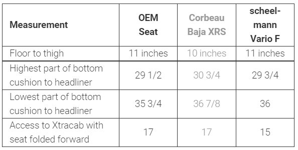

    The initial fit of the scheel-mann is much closer to stock, though the backrest is significantly thicker.
    For a moment, I debated whether I really cared all that much about a quarter inch difference in my seating position. I knew the sliding seat belt brackets would raise the back of the seat 3/16", and so figured that I might as well make some small spacers for the front so that everything was just right.
    An added benefit was that I could make the front spacers just a bit taller - 9/16" - to give my thighs a bit more support on long trips.

    • Thickness of the backrest. I'd say that it's a good 2" thicker than the stock Tacoma seats. That doesn't seem like much, but when the entire backrest is only 5" thick, it's another 50% thicker and takes up room in the Xtracab. The reason for this is the lumbar support system (which seems very nice so far). I'll need to see over time if it's worth it.
