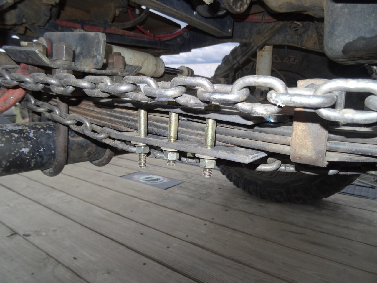

    The straps worked well for the leaf spring, but I’m not happy with them as a solution in the future. It was just too stressful driving with a bit of polyester holding the truck together.
    I have since seen several other people who have run into similar situations, and they had a fantastic method of clamping two pieces of quarter inch steel above and below the leaf spring with some grade 10.9 bolts to sandwich the entire pack together. This seems to work very well, and while it reduces the functionality of the leaf pack, it holds everything together much better. I plan to get a couple small plates and the necessary hardware to put in my kit for the future.

    That's definitely a better solution. Plus, if you weld the bolts to the plate, it makes the repair fairly quick. Never mind you could carry several if you felt the urge.

    Couldn't a C-Clamp or two be used in such a situation? Obviously not ideal, but readily available and nearly every hardware and probably several general stores.

    I wouldn’t trust a C-clamp. The spring is multiple layers that move. The clamp holds only the outer springs. It’d likely come off when you least expect it.

    We considered heading south, but we were pretty sure that we'd be able to get what we needed in Bishop. We also considered heading east - out through Beatty, which was technically closest, but then there's nothingness forever. In the end, it didn't matter which way we headed because it was a Friday afternoon, and apparently everyone who was moving in the state of California had already rented all of the car haulers for their weekend moves. The nearest one to Bishop - north or south - was in Quincy, CA, which was insane.
    I think a c-clamp could technically have worked if it was strong enough, but I wouldn't trust it as the only fix. Plus, I feel like a lot of the c-clamps these days are really brittle, and even more than coming off, I'd be worried that the casting would break given the varying forces of the leaf spring as it tried to flex.
    I still think that this solution - which I alluded to above - is a really good one. An obviously the chain is a better solution than the ratchet strap as well, if you have one with a good way of tightening it.

    And yes, I don't think the C-Clamp is a "good" solution, but you could position it on the leafs where it would hold the one down and drive slow enough that it shouldnt flex too much to knock it off.

    Do you think you need to tighten the chain? Wouldn’t it be enough just to keep the spring from coming out of the clamp?

    Your leaf pack situation and solution seems to have worked out ok. Not sure I would have thought about a ratchet strap but now I will. I probably would have tried to wrap bailing wire around it but the strap has proven to be the better solution.

    The sense that I got with the strap was that I really needed to tighten it down to keep the rear axle as aligned as possible. As it was, it was about 3/4 - 1" out of square with the frame, and it wasn't nice for my alignment on the way home (had to keep the steering wheel at about 22° to keep the truck going straight. That tire is also significantly more worn now. So, not 100% sure, but I think you'd want the chain tight.
