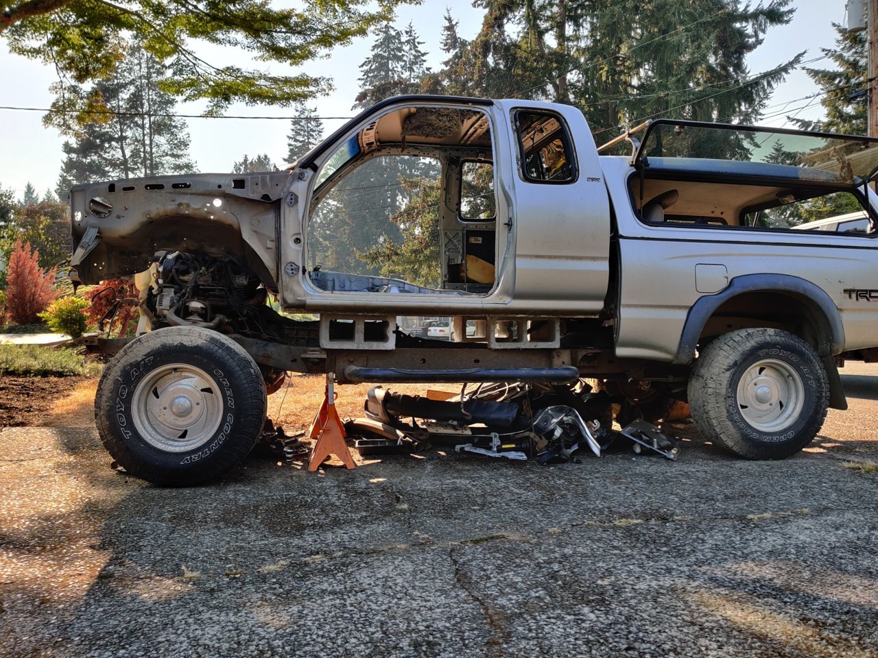

    I mean, I'm surprised no one has suggested option #5...
    So who's doing what?
    I don't think I need a new bed, but I do need details. At least what color is it? ;)

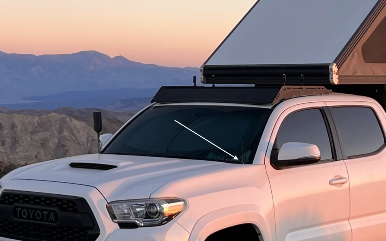

    We did a hasty 'soft install' on a Midland on my wife's truck a day before a short trip (she was over having to use a handheld), ran the magnetic antenna thru the firewall to the hood and that thing held in place four days no worries - it is pretty impressive
    Great radio's, we use them to chat amongst ourselves - call out 'marmot' sightings and what not

    I hate doing this...but this may be a safety issue for some people. The sensors you are calling ABS are actually for the SRS (airbag) system. They are the airbag impact sensors. Anything with a yellow cable to it is SRS. So some extra caution should be used when messing with them...mostly just disconnect the battery and your good.

    Yeah, I’ve been having trouble with these for years now. I’ve decided to use water as lubricant so I don’t attract more gunk, but it requires regular tightening of the zipper clasp to keep working. Bleh!
    I’ve worried that using wax would attract dust in the trail. Have you had any issues with that?
    Thanks for calling it out, I’d already caught that brain fart on my website and fixed up the photos there, but forgot to come back to TW to fix them up here. I’ve updated them now and I am a little surprised the old images were still showing, since I deleted them from Flickr when I updated my site a couple days ago. :thumbsup:
