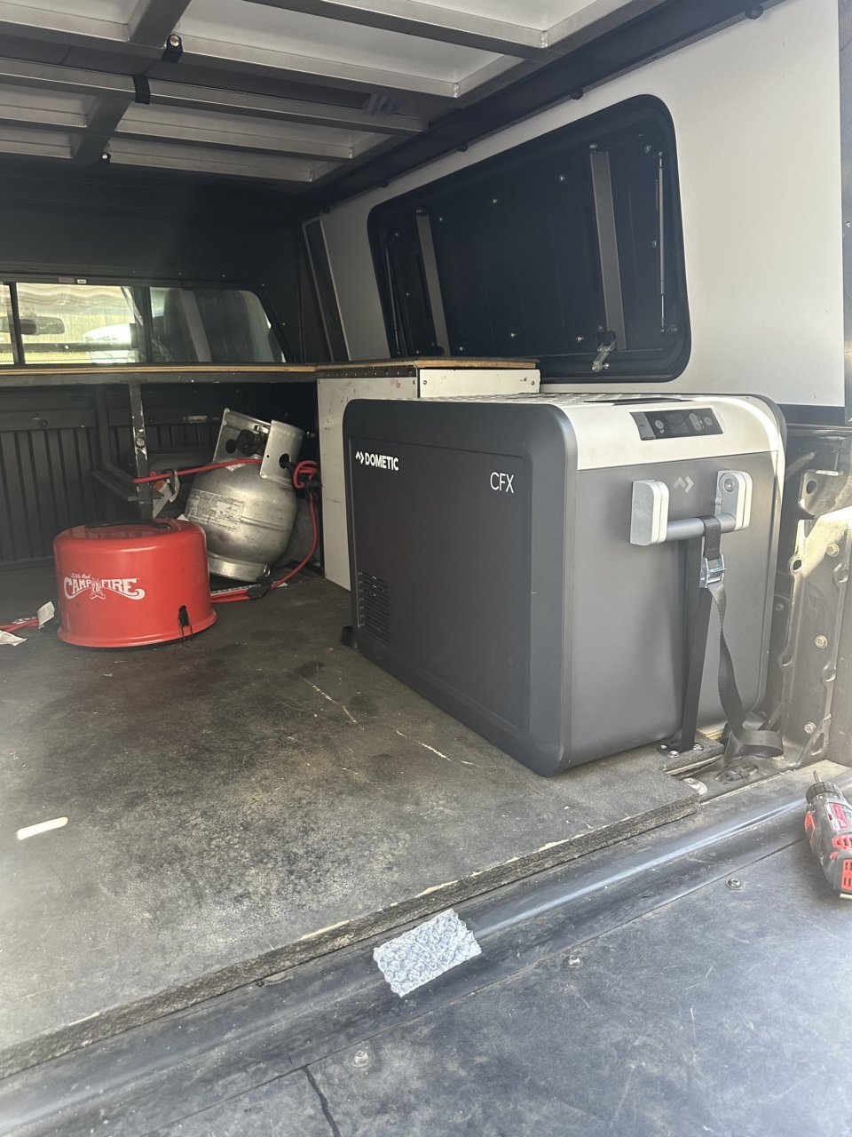

    Dometic First Impressions
    I haven't yet used the Dometic, so these impressions are based on my unboxing and running the fridge next to my desk for a few hours to make sure that it cooled before taking it out on the trail. I'll be sure to update them after my upcoming trip to Nevada, and again in about a year.
    My actual fridges, side by side.
    What I like
    • The cost. I was able to pick up a Dometic for significantly (about 30%) less than the ARB fridge.

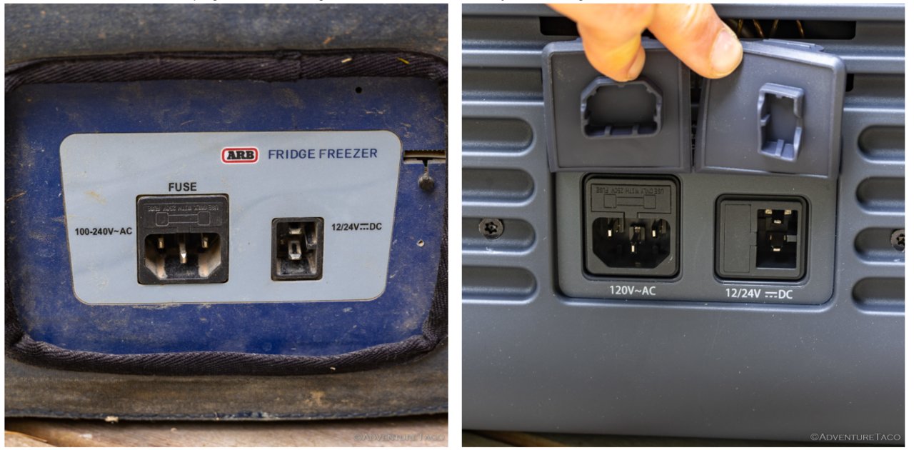

    • It uses the same 12V and 120V plugs as the ARB fridge, so I don't need to rework any of the wiring on the Tacoma.
      I was very happy to see that the inputs were identical.
    • The footprint is a similar size - just slightly wider and slightly shorter than the ARB, so it'll fit in my existing fridge slide.
    • It's a little bit shorter than the ARB fridge, so if I can find the time, I will be able to lower the height of my bed rack a few inches, bringing the tent entirely below the height of the cab.
    • It seems to cool more quickly than the ARB ever did.
    • The warranty is great. Where the ARB warranty was three years parts and labor, the Dometic is three years for the fridge and five years on the compressor system.
    What seems meh
    • It's a little smaller than the ARB fridge, at 48qt rather than 50qt. I hope this won't be an issue.
    • The control panel doesn't display the temperature inside the fridge at all times. Rather, I have to press a button to have the screen "wake up" and show me that my food is cold.
    • It seems a little louder - or the compressor has a slightly different pitch - when it is on. This may or may not be an issue when it's in the bed of the truck and we're sleeping in the tent above, so I'm reserving judgement until after a few nights on the trail.

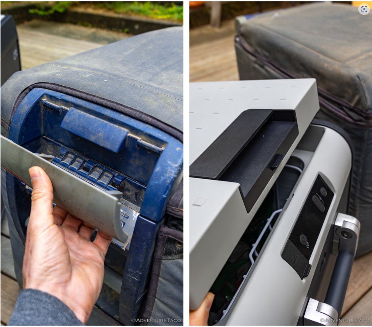

    • The lid on the Dometic seems flimsy in two ways:
      1. The whole thing sort of "wobbles" on the hinge, which seems loose. While technically secure, it just doesn't give the feeling of proper workmanship as compared to the ARB.
      2. Where the ARB used a locking cam lever to keep the lid securely closed, the Dometic has a small plastic tab that engages when the lid is pushed down from the top. It feels flimsy, and I'm worried that it will break.
        Not loving the small tab on the Dometic (right).
    • The internal storage. While the shape of the Dometic is similar to that of the ARB, the ARB had a permanent divider between the larger main compartment and the upper-rear "vegetable" compartment (a place that stays slightly warmer so you don't freeze fresh veggies). The Dometic uses a wire basket for the upper area, and which reduces space and makes access more difficult.
      Reasonalby similar; advantage ARB (IMO).
