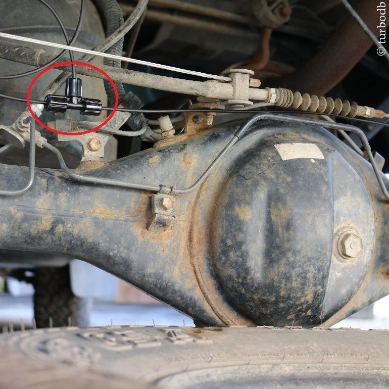

    It's less Tacoma and more mod
    This looks like 1/8" air line, like I use on air shocks for my Harley, what is going on on your axle that requires an air line?

    Airbags?

    Hahahaha, how'd you come across that pic anyway? It is and air line. My rear shocks are Monroe MA-820's, which were perfect for how I used to use the truck (hauling), and probably not ideal for adventuring...

    Just reading a part of your build thread last night. Saw that and was like what's going on here, thought you might have gotten creative with a broken ABS wire or something haha. Do you still use the rear air shocks or have you found something with a larger range of travel?

    Still running those, since I've never experienced better :). My guess though, is that I'll likely want to replace them after this summer's trips.

    Cool, if it works it works. Wonder what the valving on an air shock is, must take into account the bladder of air as rebound too. Gotta imagine they certainly ride better than the one blown Rancho was used the last two trips haha. If you ever need specs for a relocate I'm happy to help, was a pretty easy weekend project.

    Air shocks like his are weird, they have a normal oil damper in them and then a bladder that physically forces the shock apart to add load capacity. That's why I wondered what the oil valving is to work with something that is designed to have external resistance too.

    Do they run to an air source? Or just a schrader valve to fill/deflate? If it's the latter you are setup nicely to go for bags. Seen it done on a 2nd gen and I love the idea for an adventure rig.

    They run to a schrader valve that I installed behind the fuel door.
