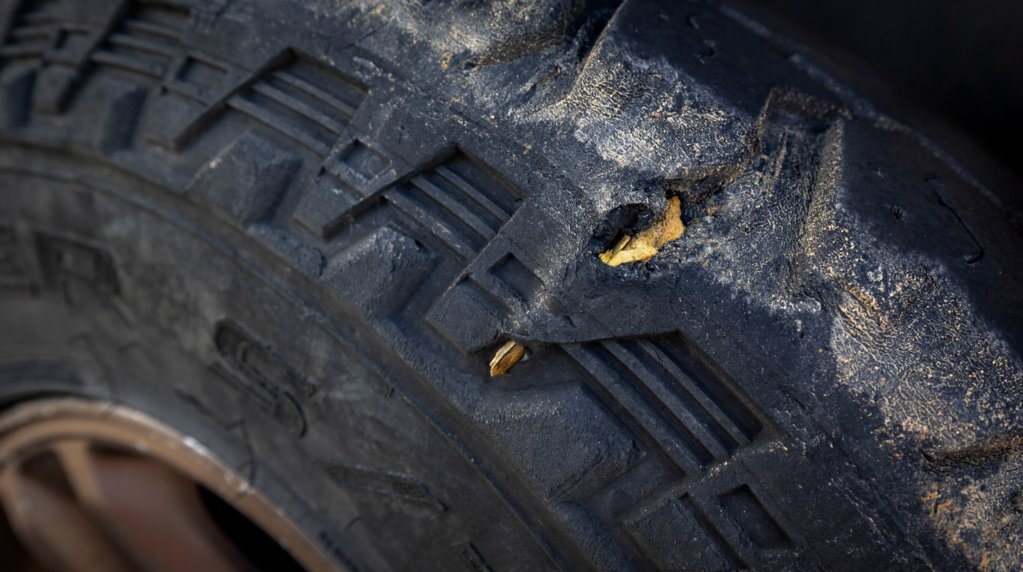

    So if you don't think a cute little stick puncturing the tire is the tires fault, what kind of failure would you blame on the tire?

    God that is aweful.
    I don't feel like the sidewall is mild, probably b/c I'm comparing it to the Maxx. Like I said, even the sidewall of the Duratrac was a little more than I wanted when I ran them on both the Taco and 4Runner.
    And the sidewall on the ground isn't the issue. I've been told by you all in no uncertain terms that the sound comes from road contact. And the Klevers certainly have a more aggressive tread pattern on the road surface than the Maxx. I'm sure there's more to noise than just pattern/lug size, but it's usually a reasonable proxy. As I mentioned, the noise is not too bad yet, but we'll see over time.
    See, I'd have said that was bad-ass on the tire's side, and dumb on the driver side for not replacing it for more than a year after it was compromised-but-still-not-leaking. And then even dumber for slicing it out with a knife and driving on it again. And again.

    It's badass that it got punctured by a stick? I've never had a piece of wood penetrate my tires. That IS a mark against the tire :laugh: is it a 1/1,000,000 chance? Sure. But the mileage was more of a contributing factor that the main one in my eyes. But we both look through completely different lenses when it comes to tires as we've established before.

    I mean, a stick at the correct angle is like a nail. And "sticks" hold up houses - a lot more weight than a measly rubber tire can do.
    Anyway, to add fuel to the fire, it was a cactus carcass, not a stick, hahaha.
