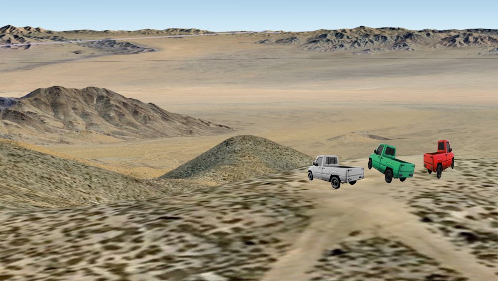

    It's less Tacoma and more mod
    Did you get this desert picture on TEMU?

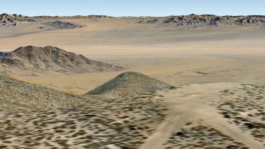

    "We have desert pictures at home!"

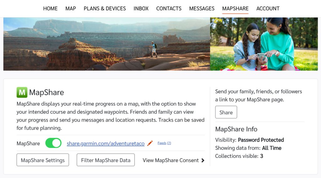

    Garmin inReach owner - Setup Mapshare:
    1. Go to https://explore.garmin.com
    2. Login, then on the top navigation bar, click MapShare
    3. Turn on the MapShare toggle and optionally edit your feed name

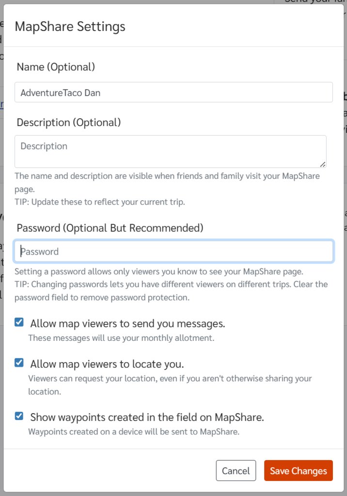

    4. Click on MapShare Settings
      1. Enter a Password (unless you have unlimited messaging/want "anyone" to be able to send you a message)
      2. Be sure to check the box to "Allow map viewers to send you messages." (and any other options you want)
