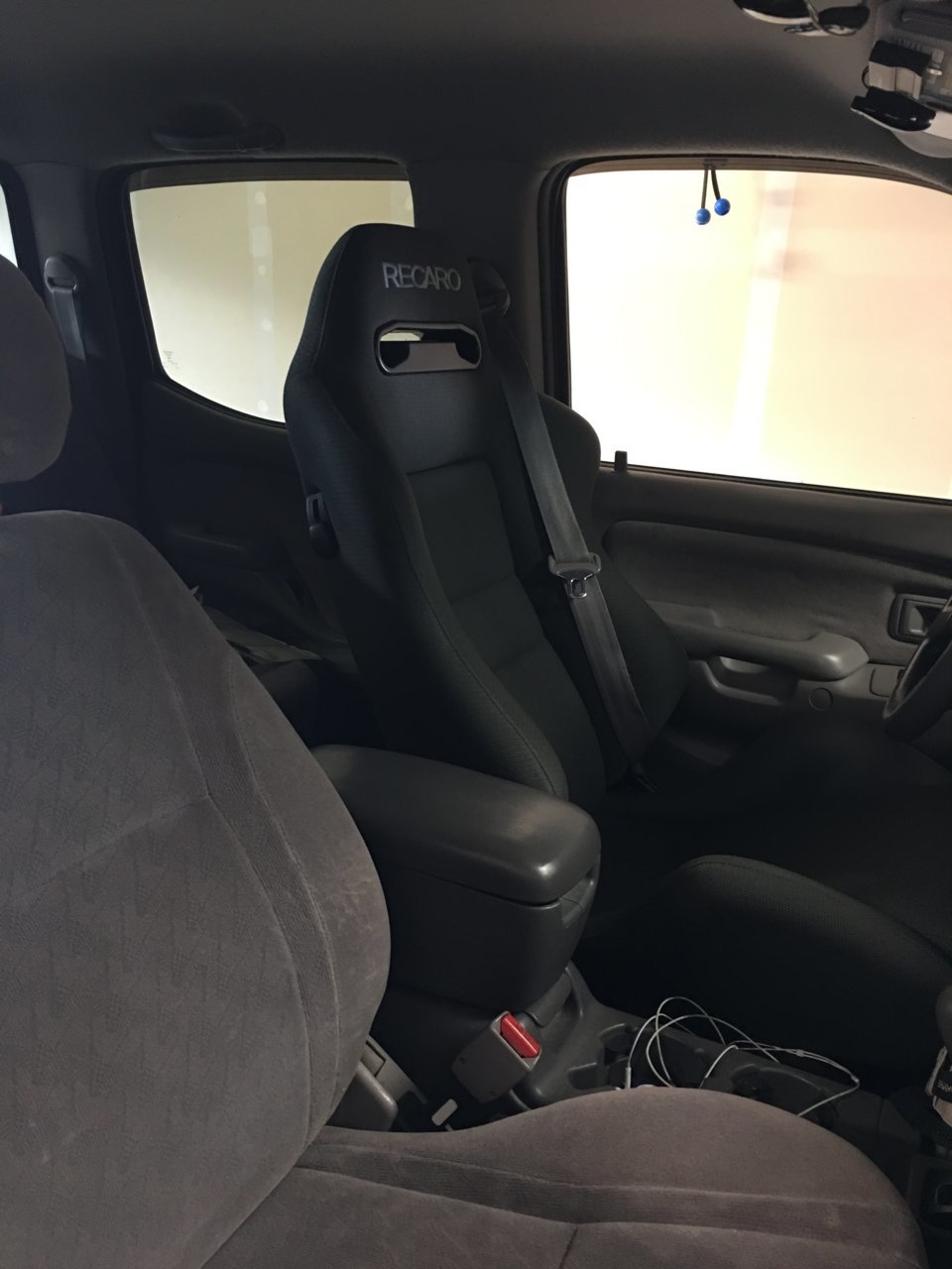

    There is two companies i know of that make bolt in options.
    Mastercraft: http://www.mastercraftsafety.com/performance-seats
    Bracket: http://www.mastercraftsafety.com/seat-mounts/toyota-tacoma
    and Corbeau: https://corbeau.com/susp-reclining.html
    Brackets: https://corbeau.com/toyota-tacoma-oem-bucket-60-40-95-04-seat-brackets.html
    Though as you'll notice there are some remarkable similarities to the seats themselves...Plus none of those options are cheap, easily a grand for a set of seats. Some people love them though. Im scared to go this route and some look narrow at the shoulder and I have wide shoulders. Can't really find a place to test them out though around here..
    Otherwise your only option is to weld on the seat slider to the OEM brackets. Very common to do. WRX seats as mentioned were popular for a while to swap in. Some go for some plush stuff and get luxury sedan seats like lexus or merc. You can fit just about any bucket seat you want. Though some are too wide. One of the best ideas I think is to go to a junk yard and just sit in a bunch of seats till you find one that is nice.
    PRP is another popular race seat maker. You can get them very much customized but would have to either reuse the stock brackets or retro fit one of the brackets up above. https://www.prpseats.com/product-category/seats/daily-driver-series/
    Edit: I lied. PRP makes brackets too. https://www.prpseats.com/product/toyota-tacoma-95-04-mounts/
    Spendy though..

    This was what I found as well, and without having options around me either to Test "sit in", I went ahead and bought some Corbeau seats. They are comfy, but I didn't account for the wide shoulder syndrome. Not bad at all for short drives, but long trips I still get back pain, just not as severe. Ultimately it is a better seat IMO than the stock ones that would shoot orange dust all over when I sat in them, and the fact I would be putting my right hand on the back of my head to prevent a killer knot forming in my shoulder blade, but not something that is permanent. I have some people interested in them so eventually I will try my damdest to find some ones to test out first and go with something a little more flat for the top half of my back. If you find some that you try out and like for a person with broad shoulders let us know.
