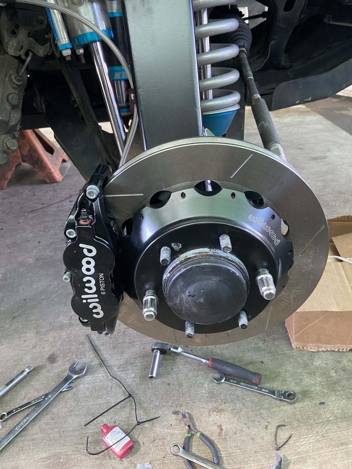

    Do both! I've got 5.29s and a Wilwood BBK - can confirm they are great upgrades

    You know, I've read this a number of times and wonder exactly how true it is? Maybe it's a faulty butt-brake-dyno feeling, but is there no advantage to having more clamping force for each ABS braking cycle? Again, I have nothing technical to stand on here, but my feeling is that the bigger rotors and calipers, additional pistons do decrease my braking distance. I put on the new brakes at the same time that I went from 33s to 35s and the feel is so much better that my confidence in the brakes is much improved.
    Again, not challenging this exactly, but my little brain has a hard time making sense of it.

    It's the normal braking conditions that really bothered me with the OEM brakes, but then again I don't drive very fast and rarely need to jam the brakes super hard. Coming to a downhill stop sign or red light always felt pretty sketchy and occasionally like a normal stop could've turned into a damn near emergency. I'll just say I feel a lot more confident driving around with the BBK.

    Yeah the kit @SoCaltaco65 has is a bit bigger than mine, more lightweight I think, and has better venting rotors.

    yes, and man does it stop and after long periods of braking at speed the almost 0 brake fade is magical!
