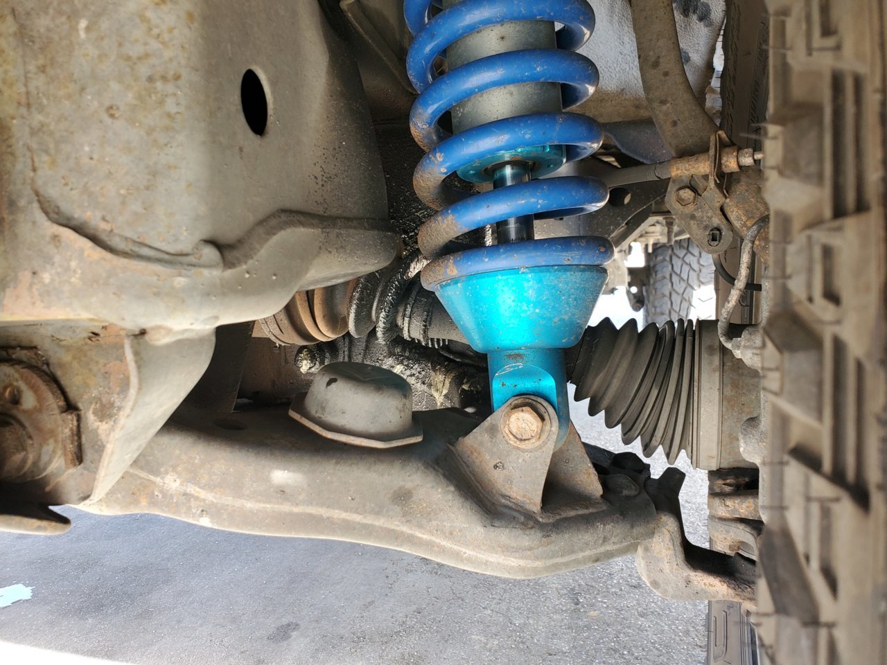

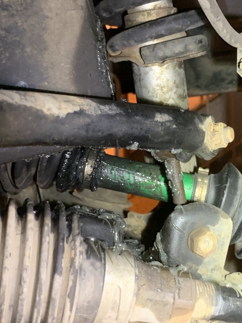

    2001 Tacoma, 130k, according to carfax it was garaged for almost a decade without much use before I bought it. Eventually I want to rehaul everything from swing control arms to suspension, but it might not happen for a couple years since I lack garage space.
    Prev owner looks to have done some work but I can’t tell how long ago that was, but he left a hell of a mess with the grease. He installed cheap suspension with 1” spacers and I see a few junkyard parts with paint pen still marked.
    I look forward to doing a deeper dive once I get a garage, but for now I have 2 questions:

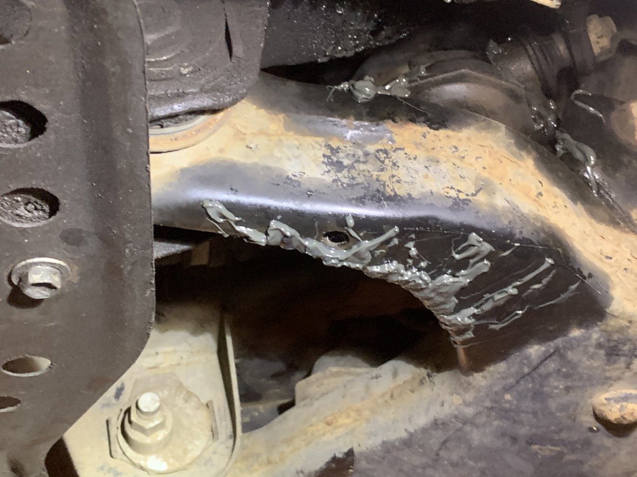

    1. Will the grease hurt anything if I wait on cleaning it up? How might this mess have occurred? I don’t see any leaking parts so I assume someone was just trigger happy and lacked aim. This is an example, but it’s all over like this

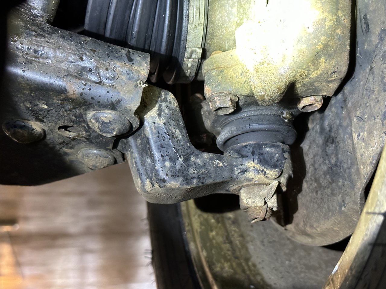

    2. LBJ seems ok for now but the nut looks pretty bad. Anything I can do to preserve until I get around to replacing? Please don’t suggest more grease

    Swingarms? What are those?
    You can easily replace a lot of stuff on a Tacoma without a garage.
    As for grease, it won't hurt other components but you run the risk of ruining your OEM cv axles in the long run.
    Just replace the LBJs and reboot your cv axles.

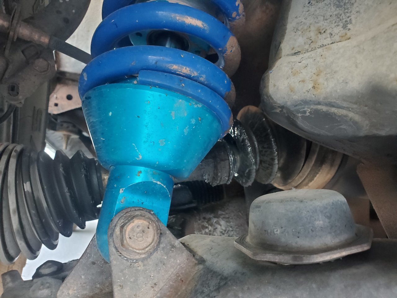

    And what I mean is, your torn boots will leave your cv axles to be exposed and have crud and crap get in there over time as you drive.
    OEM cv axles are desirable and are often rebooted as they won't fail on you; last thing you want to do is run a cheap parts store cv axle.

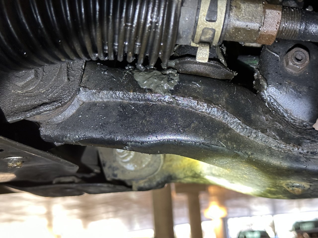

    Inboard CV joint is where the grease came from ;) Nothing else in the suspension has that much grease in it. OEM ball joints and tie rod ends don't have zerks for regreasing, so previous owner couldn't have been "trigger happy". The CV joint boot probably cracked from age.
    Re-doing the inboard CV boot is best done on a bench with a vise. Make sure you have that handy if attempting in a parking lot :laugh:
    Alternatively you can buy a Napa CV axle and swap it in. Re-boot this OEM one as a spare (for when the driver side axle goes).

    change ur balljoints

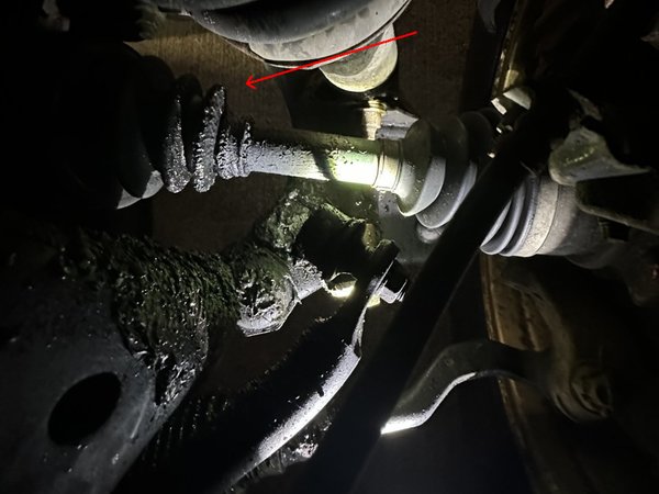

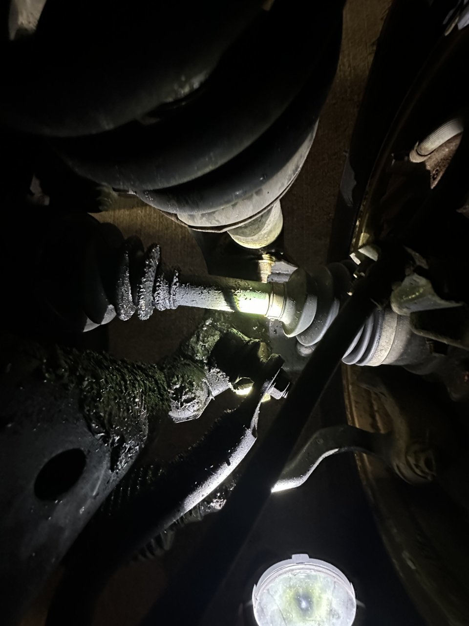

    Some of the grease is in spots where CV lacks line of sight, so it didn’t seem like torn boot could have caused it. This initially led me to think someone was trigger happy.
    But I’ll clean it up for a better look.
    Here’s a diff angle closeup

    We're telling you what it is; torn cv axle boot.

    That is one of the worse CV axle leaks I ever saw. I will admit at first look it does look like target practice with a air powered grease gun.
