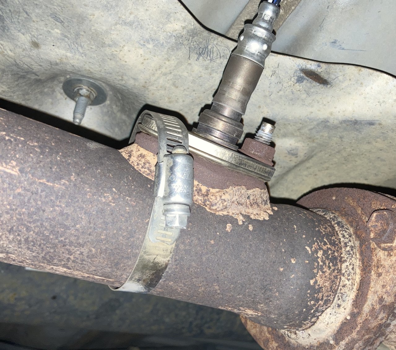

    crazytacoman
    crazytacoman [OP] Well-Known Member
    Oct 30, 2018
    #271148
    729
    Tacoman
    Taco World
    02 2.7 doublecab & 07 4.0 doublecab
    Color Wheels
    I seriously still have the sensor held together by the hose clamp in my last picture. I checked to see if any smoke came out of there recently by using a flashlight on it at night, and I didn't see any

    #30
    Lukass
    Lukass Well-Known Member
    Sep 10, 2019
    #304898
    158
    Luke
    Payson Arizona
    Extraordinarily Stock ‘99 Tacoma TRD
    Bilstein 5100’s
    You can put some high heat gasket maker or exhaust sealant in between the sensor and the port and tighten up that hose clamp again, then you’ll have no leak for sure

    #35
    crazytacoman
    Oct 30, 2018
    #271148
    729
    Tacoman
    Taco World
    Color Wheels
    Update: I still have the sensor clamped! No issues whatsoever

    #37
    crazytacoman
    Oct 30, 2018
    #271148
    729
    Tacoman
    Taco World
    Color Wheels
    Here's a pic of how it looks right now. It's pretty crazy how well it has held up
